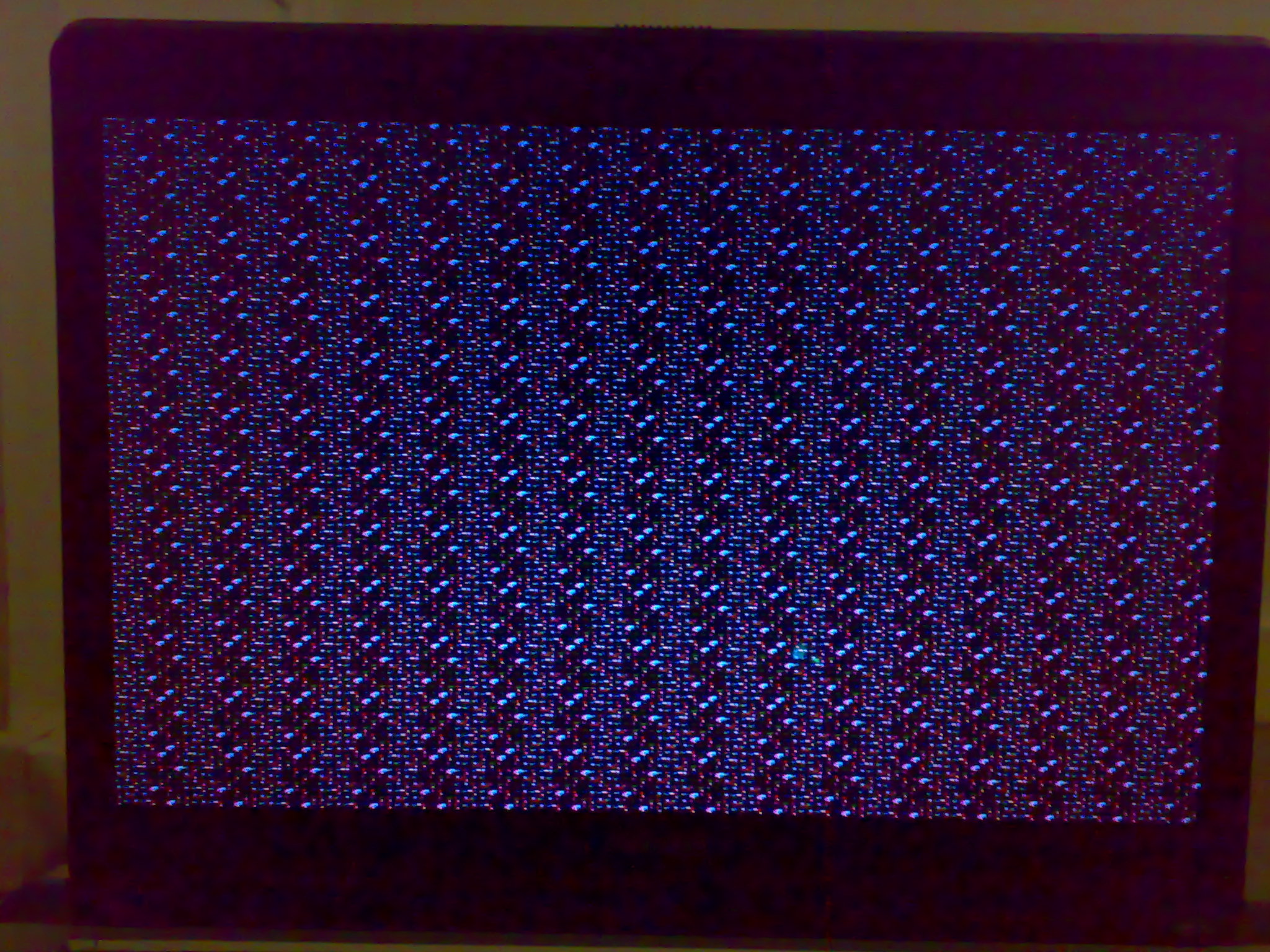

tvt Posted April 24, 2008 Share Posted April 24, 2008 Install the Leopard Graphics Update then look for it. thank! but after update,reboot ,i have reinstall OS!!!!! Link to comment Share on other sites More sharing options...
drumthrasher109 Posted April 25, 2008 Share Posted April 25, 2008 thank!but after update,reboot ,i have reinstall OS!!!!! No you don't, you get a kernel panic. Boot with -s, cd to /system/library/extensions and rm -r NVDAresman.kext. I'll post more help if you need it. Link to comment Share on other sites More sharing options...
tvt Posted April 25, 2008 Share Posted April 25, 2008 No you don't, you get a kernel panic. Boot with -s, cd to /system/library/extensions and rm -r NVDAresman.kext. I'll post more help if you need it. if you have the time.Now,i post an image of screen after update it's possible can you tells me what does that mean,kernel panic?Thank again! Link to comment Share on other sites More sharing options...

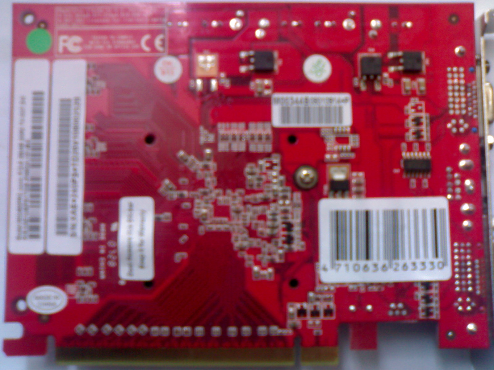

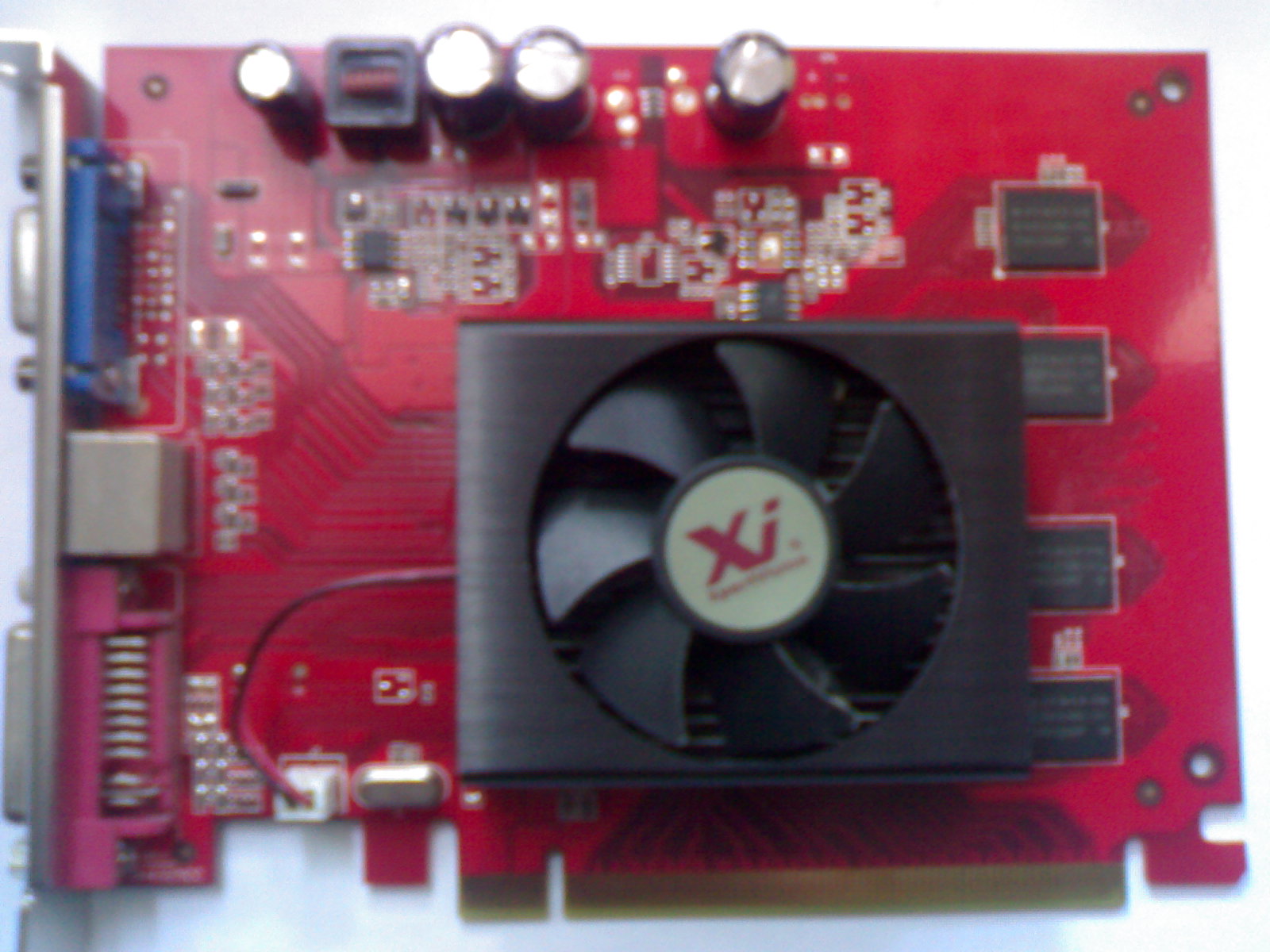

ufo_all Posted April 25, 2008 Share Posted April 25, 2008 Ok, what manufacturer is it? Does it work correctly with dual monitors? I need a fanless card with DVI-I connectors.There's a fanless 2600 PRO from both HIS and PowerColor, I don't know which one I should get. Anyone with experience? Here i attach pics of my ati graphic card and the graphics model HD2400 PRo Sonic -PCI-E 256MB DDR2 TV-OUT DVI as it is mention on the label. Link to comment Share on other sites More sharing options...
drumthrasher109 Posted April 25, 2008 Share Posted April 25, 2008 if you have the time.Now,i post an image of screen after update it's possible can you tells me what does that mean,kernel panic?Thank again! Oh thats easy, do the following: 1. When you're at the Darwin/x86-Boot, type -s and press enter. 2. Once its done type /sbin/mount -uw / and press enter. 3. Then type cd /system/library/extensions and press enter. 4. Next do the following: rm -r Natit.kext rm - NVDAresman.kext 5. Finally do this: reboot If it doesn't work, do the same thing but instead of removing Natit.kext and the NVDAresman.kext, this time remove ATIRADEONX2000.kext. Link to comment Share on other sites More sharing options...
