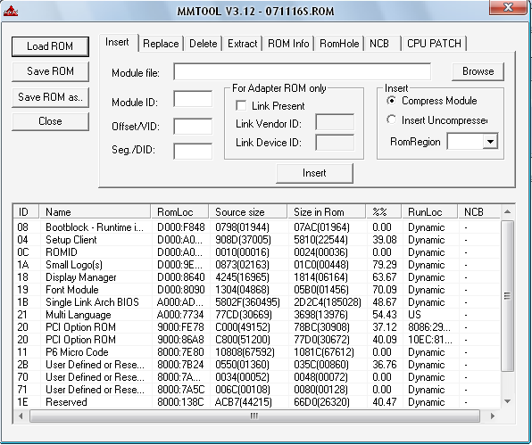

Here is a guide for modifying DSDT for AMI bios. I gathered most information from Kabyl. The orginal plan was to create a nice pdf but I am unable to gather enough time to sit down and create one. So hopefully, this guide will do for now. Feel free to add other bios moding guide here.
WARNING!!! BAD MODIFICATION OF THE ROM FILE AND FLASHING BACK INTO YOUR BIOS CAN KILL YOUR MOTHERBOARD! TRY THIS AT YOUR OWN RISK! I AM NOT RESPOSIBLE FOR ANY DAMAGE!!!!!! IF YOU ARE UNSURE OF WHAT YOU ARE DOING, DO NOT TRY THIS!!
1. Download the AMI bios you wish to modify. It should have the .ROM extension.
2. Run the MMTOOL.EXE from the AMI_DSDT_TOOLS.zip
3. Click "Load ROM" and choose your bios file.
4. We are now going to extract the DSDT from the ROM. Click on "Extract" tab. Then on the list box on the bottom half of the MMTOOL, select "1B" named "Single Link Arch BIOS".
5. Make sure "In uncompressed form" is selected. Enter a filename in the "Module File" textbox and then click on the "Extract" button (For example "SingleLink.dat")

25. Go back into the MMTools and choose "Replace" tab. On the list box, chick on "1B | Single Link Arch BIOS". Next to the "Module file:" textbox, there should be a "Browse" button, find the modified "SingleLink.dat". Click on "Replace" button and you should be done.
26. Click on "Save ROM" button and save to a new ROM file. Flash this ROM into your BIOS.
