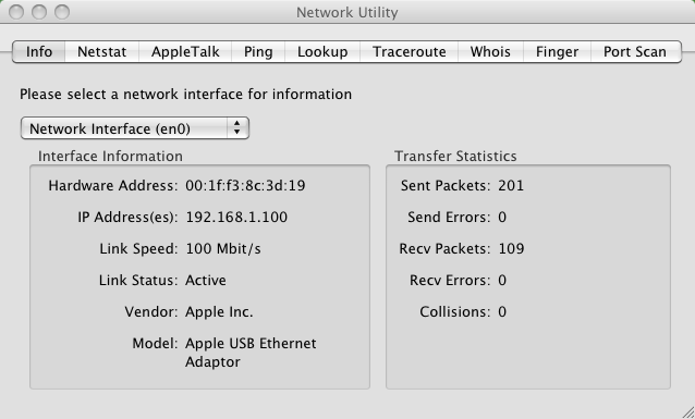

Hey Everyone,
I have been lurking in here ever since I got my m1530. I installed iAtkos 5i and I have everything working (I purchased the wifi card macgirl suggests and it works flawlessly, as well as the usb ethernet apple adapter). The only problem I have is with my USB --> Ethernet Adapter from Apple. I bought it at best buy, and it works for the most part. The problem is that I only get like 2mbit speed with it. Even on my local 100mbit LAN, when I transfer between my PC's i get like 750kbytes/second. It is rather frustrating b/c it takes hours to transfer anything of substance (ie. movies). I tried searching for this issue on all of the forums, but I'm not having much luck (although I might be searching with poor parameters).
Any help would be greatly appreciated! Thanks guys!
In Network Utility does it report the connection as 100 mb/s?
Yes, I have attached a screenshot of Network Utility. Also, I forgot about this in my first post, I get an error with one of the USB kext's everytime I boot (says something about the kext not being installed properly). I am not sure what started the error, I think it was when I tried to add a device ID or something, but since everything has been working (for the most part) I have ignored it until now. I'll reboot and write down the error to post here.

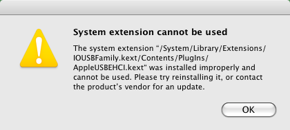

Thanks for the fast reply!
EDIT: I attached a picture of the error. Thanks again!
My Guess is that even though the LAN connection is at a full 100mbit, your usb/ethernet adaptor is only connecting at USB1 speed rather than USB2. This makes a massive difference. I had this problem initially, and it is caused ny mismatched kext files. THere have been many posts on here regarding that problem, so take a look.
Andy.
EHCI is your high speed USB kext. If you have installed EHCISleepEnabler then it is possible you edited the Info.plist in that kext incorrectly. Re-read Superhai's directions on that regard. When that kext loads properly you should see full USB 2.0 again and your connection speeds will probably improve. Also check Console.app. It is possible you are getting a dependency error regarding AppleUSBEHCI.kext.
