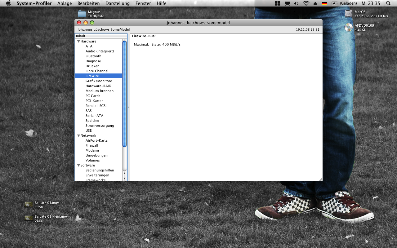

Defcon84 Posted November 19, 2008 Share Posted November 19, 2008 Hi, i had install a retail version on my xps m1330. It works all fine but i have the following problem: In my system profile i have a Firewire Bus but if i connect a video camera or a a external hdd nothing is going on. I can´t use them. Have anybody else these problems and/or know how i can fix this? sry if the english is bad Link to comment Share on other sites More sharing options...
