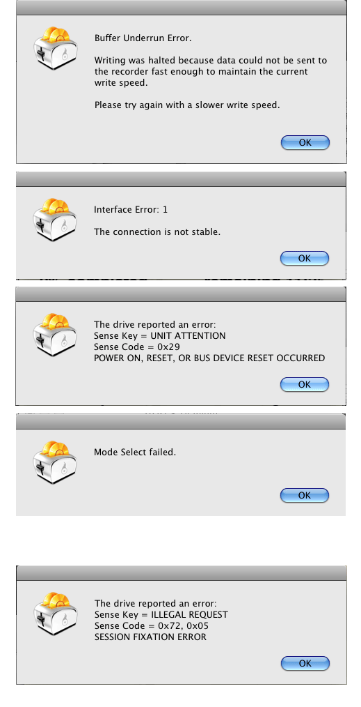

i installed, rebooted fine, never had any "sam multimedia error" but i am able to mount my dvd's now (previous kext only let me mount retail audio cd's.) the mount is a bit slow but it works on my SATA DVD drive. xbench scores for my PATA hd are very similar pre-your lastest kext/post your-test kext.
i tried to burn a 2.6 gig file to dvd via toast 8 titanium three times and recieved the following 4 errors in succession (see screen shots) .... then a 4th burn is the last error in the screenshots. first at 16x, 2nd at 8x, 3rd at 4x and the last at 4x... (dvd-rw media was not recognized at all in toast but a previously burned dvdrw i had did mount on desktop):
also did some transfers from firewire external to pata hd, 2.6 gig file back and forth without issue. from and to 4gb usb thumbdrive

excellent... making progress :) thanks for all your efforts medevil, we surely all appreciate and have been patiently waiting ...
Those are all dma related... in sata, only for nforce chipset, the dma is activate prior sending a transfer message, in other chipset the transfer message is sent, then the dma is activated... now we should figure out when then dma message should be sent for atapi drives ('cause they use a different "language" than the pata/sata).
