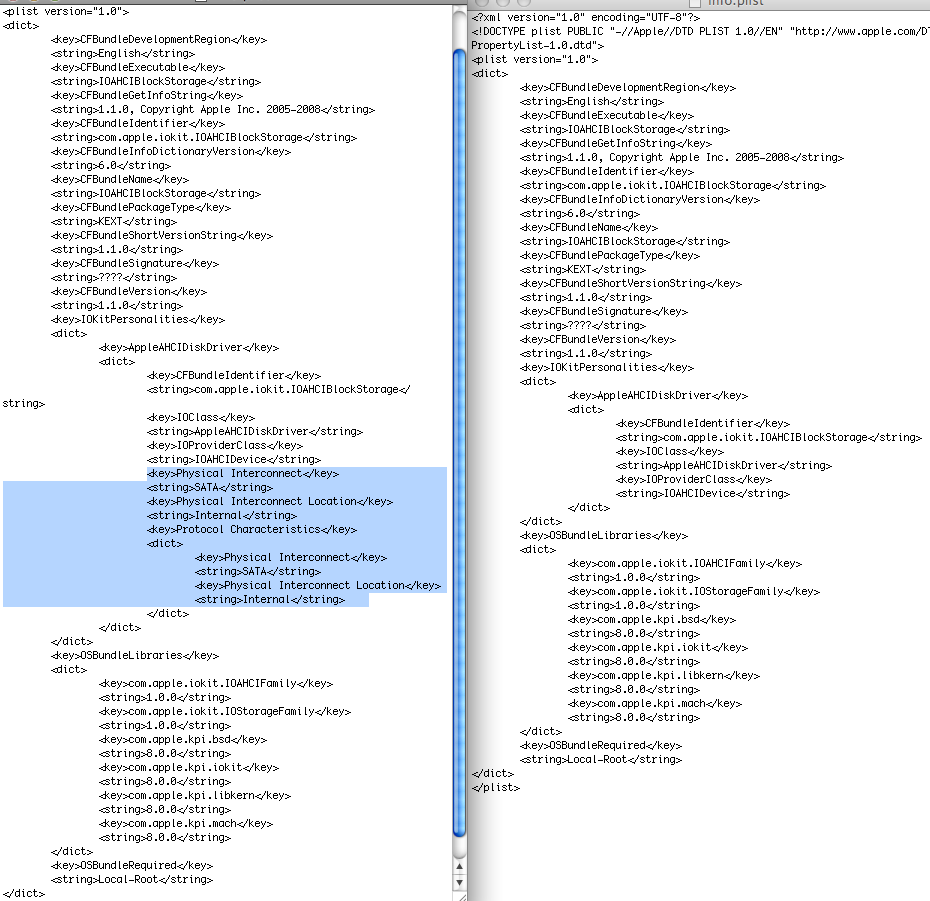

MarcP Posted July 4, 2008 Share Posted July 4, 2008 Hi karaakeha1. I saw your latest kexts.zip contains IOAHCIFamily version 1.0.4 build 58. In your previous install package and in _Latest_Kexts_for_Hard_Drive.zip you had a newer version 1.0.4 (build 260). Any special reason for this downgrade to build 58? In the moment I'm trying to pick the best kexts in order to write my own install script. (One thing that scares me are some reports on 45nm cpus which might require a patched kernel (modbin 9.4.0 for 10.5.4), due to problems with RTC...) Thanks Link to comment Share on other sites More sharing options...
karaakeha1 Posted July 4, 2008 Author Share Posted July 4, 2008 Hi karaakeha1.I saw your latest kexts.zip contains IOAHCIFamily version 1.0.4 build 58. In your previous install package and in _Latest_Kexts_for_Hard_Drive.zip you had a newer version 1.0.4 (build 260). Any special reason for this downgrade to build 58? In the moment I'm trying to pick the best kexts in order to write my own install script. (One thing that scares me are some reports on 45nm cpus which might require a patched kernel (modbin 9.4.0 for 10.5.4), due to problems with RTC...) Thanks Welcome to the Forum.MarcP I just reinstalled 10.5.4 retail. Here What I did took the Vanilla IOAHCIFamilykext for 10.5.4 inside just added texts to the info plist so that AHCI drives shows as internal.nothing else check out pic below( selected text is just added to the Left and attached Latest just modified kext Gigabyte working on F13 to fix it How did you check Build IOAHCIFamily.kext.zip Link to comment Share on other sites More sharing options...

MarcP Posted July 5, 2008 Share Posted July 5, 2008 hi karaakeha1. thanks, i've been reading this forum for quite some time now. you guys are really great. Checking the build: I open the kext package and just read the version.plist. It states version and build number. Then I use the FileMerge application to see the differences of the files (or the diff shell command). I also have a MBP 15'', 2.5 GHz, running 10.5.4, and it has the 1.0.4 build 260 as well. So, I'll just give both a try. I still hope I don't need a modified kernel to run the Q9450. Link to comment Share on other sites More sharing options...
karaakeha1 Posted July 5, 2008 Author Share Posted July 5, 2008 I also have a MBP 15'', 2.5 GHz, running 10.5.4, and it has the 1.0.4 build 260 as well.I still hope I don't need a modified kernel to run the Q9450. I used totally vanilla 10.5.4 it shows 1.0.4 build 58 thats interesting ? Latest kernel 9.4.0 should run fine with Q9450 Link to comment Share on other sites More sharing options...
