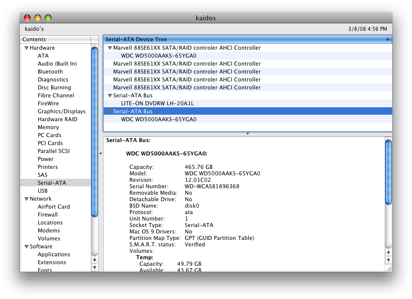

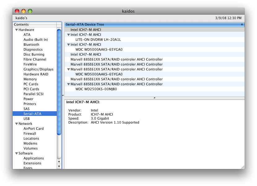

Hi All,
finally I made my BadAxe2 to function all Intel and Marvell SATA ports,
now my system this perfect one :):)
Together annex my installer for the KEXT, twirls it and for security,
install and before the BOOT, repairs the DISK permissions, delete all caches and
make the 1# BOOT w/ F8 -v -f
Today is one day happy for me....
weaksauce12, if you to want can place this KEXT in its guide of instructions of the BadAxe2
Enjoy!!!
EDIT: Running Leo 10.5.2 + EFI8 All kexts is Vanilla :) , only DSmos.kext is "alien"
EDIT2: I see 5 Marvell ports, but in board only have 4!!!??? the e-sata control 2 ports?

I did a vanilla install this afternoon and used Guedes' installer. I'm happy to report that it works for me! This is the first time that the Marvell controller has worked for me, so I'm very happy! However, instead of saying "Intel ICH7-M AHCI", it just says "Serial-ATA Bus" for my primary ports. Odd...I've attached a screenshot. But it works!
Some more exploration with the Marvell controller:
1. You CAN create a RAID set using the onboard RAID.
2. It does NOT seem possible to boot from the Marvell controller, either from a single disk or from a RAID set. I'm guessing it's because the Marvell driver has to be loaded in order for the Marvell controller to be recognized as usable. I don't know for sure though, all I know is that right now it doesn't boot up if I connect my boot drive to a Marvell port.
So now, it looks like all we need is a fully-working Sigmatel driver for our onboard audio. Again, that solution is solvable via a cheap USB sound card if you want/need full audio support. The experimental driver is enough for volume up & down, at least.
Yay!

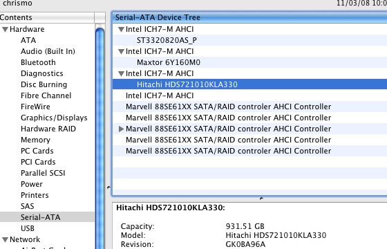

I've got my Badaxe2 running all 8 SATA ports, thanks to Guedes Jr's "HMBT_Marvell_88SE61XX_installer".
I used Guedes Vanilla kernal one, since my install is off the Retail Disk( withEFI 8 GUID). The only non-vanilla Kext is dsmos.
Another shout-out goes to Timewise. His script works well for installing and activating EFI onto the Guid partition before install.
This is my install:
