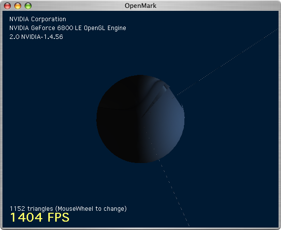

EDIT: adding GioFX OpenMark test in Tiger with AGP

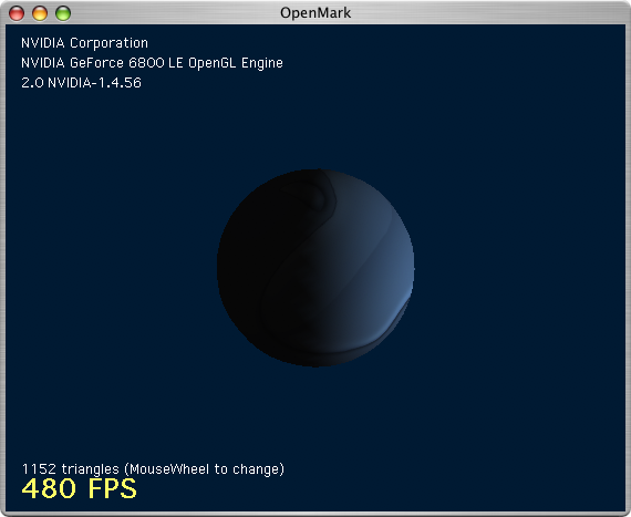

EDIT2: adding GioFX OpenMark test in Tiger without AGP

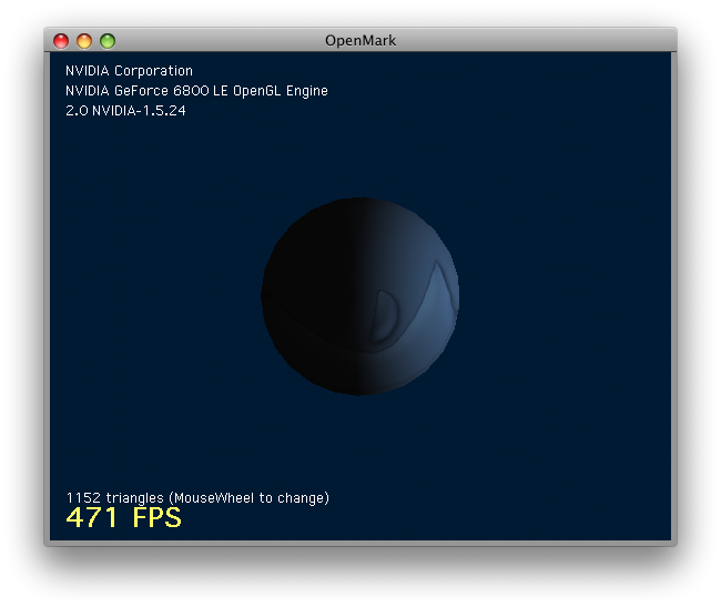

EDIT3: adding GioFX OpenMark test in Leopard without AGP
