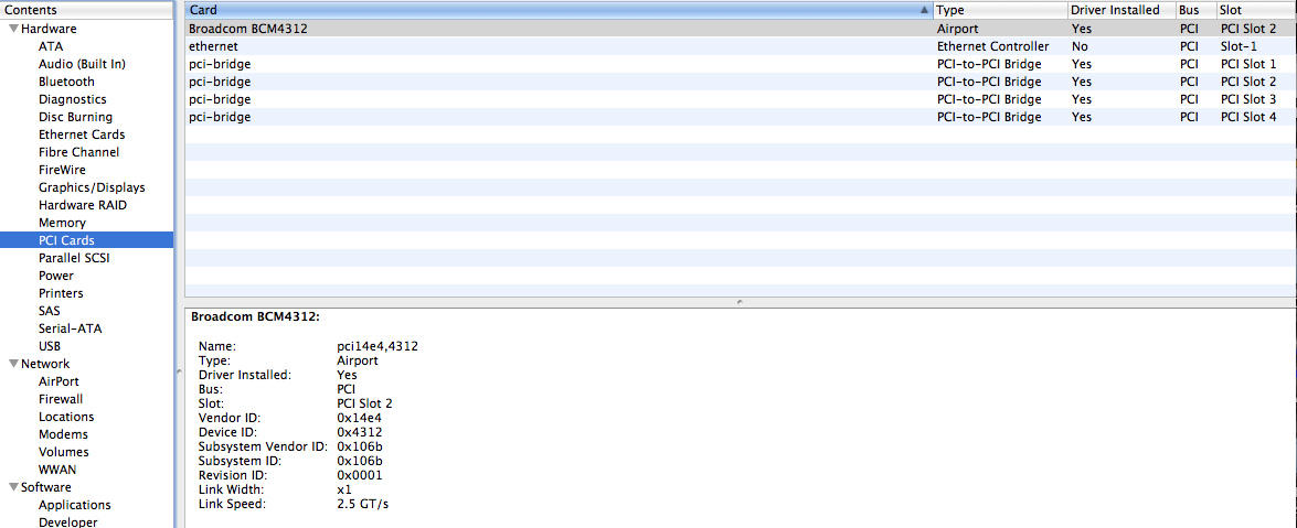

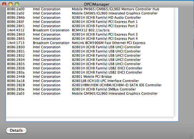

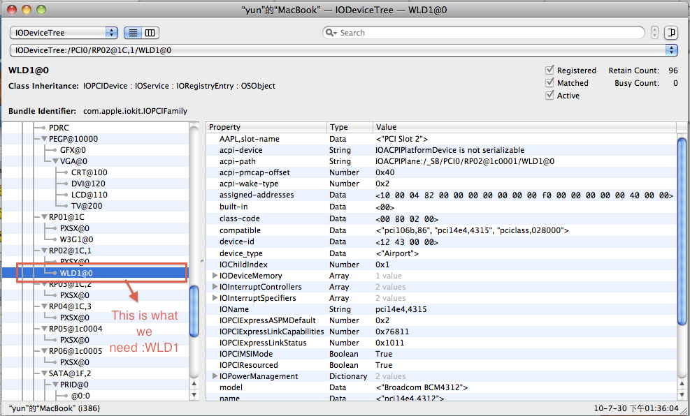

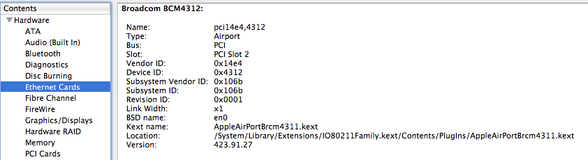

Zprood Posted July 30, 2010 Share Posted July 30, 2010 Hi guys , now I make my BCM4312 (ID :4315) working in the snow leopard 10.6.4 by using native kext. With many people help , it perform so nice . I give so tips about what I do .Here we go , maybe this not work for you . First, use the pci tool get some information:(you can get it in the Kexts.com).It like this : I have two ethernets ,BCM5906 is not working due to the driver.Other is Bcm 4312,but actually it shows like this with pci tool . 04:00.0 Network controller [0280]: Broadcom Corporation BCM4310 USB Controller [14e4:4315] (rev 01) So, when I add 4315 in the System/Library/Extensions/IO80211Family.kext/Contents/PlugIns/AppleAirPortBrcm4311.kext/Contents/Info.plist ,and repairPermissions,it get work well .But I see some people modify dsdt get it work as real Airport Card .Then let`s start. Second, use IOregistryExplorer to get wireless card location .Like : When we get WLD1 ,and use this search in the dsdt .After search we get two place ,and we only need use this ,like: Scope (^^RP02) { Device (WLD1) { Name (_ADR, Zero) OperationRegion (WLAN, PCI_Config, Zero, 0x08) Field (WLAN, ByteAcc, NoLock, Preserve) { WLID, 8 } Great, if you get such information.so .keep going,add this code under above mentioned: Method (_DSM, 4, NotSerialized) { Store (Package (0x0C) { "device-id", Buffer (0x04) { 0x12, 0x43, 0x00, 0x00 }, "subsystem-id", Buffer (0x04) { 0x6B, 0x10, 0x00, 0x00 }, "name", Buffer (0x0D) { "pci14e4,4312" }, "device_type", Buffer (0x08) { "Airport" }, "model", Buffer (0x11) { "Broadcom BCM4312" }, "built-in", Buffer (One) { 0x00 } }, Local0) DTGP (Arg0, Arg1, Arg2, Arg3, RefOf (Local0)) Return (Local0) } All the code is like this : Scope (^^RP02) { Device (WLD1) { Name (_ADR, Zero) OperationRegion (WLAN, PCI_Config, Zero, 0x08) Field (WLAN, ByteAcc, NoLock, Preserve) { WLID, 8 } Method (_DSM, 4, NotSerialized) { Store (Package (0x0C) { "device-id", Buffer (0x04) { 0x12, 0x43, 0x00, 0x00 }, "subsystem-id", Buffer (0x04) { 0x6B, 0x10, 0x00, 0x00 }, "name", Buffer (0x0D) { "pci14e4,4312" }, "device_type", Buffer (0x08) { "Airport" }, "model", Buffer (0x11) { "Broadcom BCM4312" }, "built-in", Buffer (One) { 0x00 } }, Local0) DTGP (Arg0, Arg1, Arg2, Arg3, RefOf (Local0)) Return (Local0) } } } Last , we need other thing to do ,use 0x001C0000 search in the dsdt ,and get Device (RP01) ,add Name (_SUN, One) under it .Also you can do this in the Device (RP01) to Device (RP06) (there are six Device (RP0x)in my dsdt) .So , when you have finish all of work ,you can delete 4315 or other value from Info.plist and enjoy you effort . Regard: Link to comment Share on other sites More sharing options...
