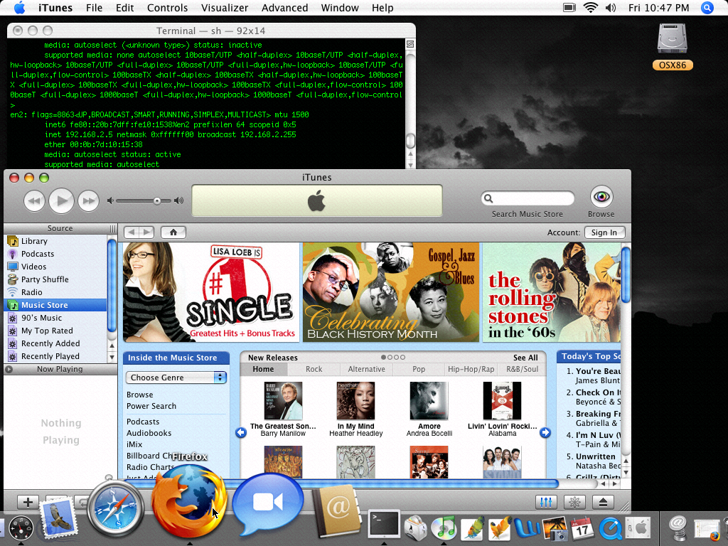

Seggybop Posted February 2, 2006 Share Posted February 2, 2006 update on mine (4306) previously I was only able to connect via the airport command line utility. however, I now have full functionality. this was done simply by getting a driver for my intergrated ethernet controller (marvell yukon gigabit) so that the OS would recognize wired as 0. whoever said that the OS has a problem with the wireless being the only network controller was right. if there's no wired controller as #0, it gets confused. if you still can't get 4306 to be recognized at all, try entering all 43XX series model numbers up to something arbitrarily high. I'm rather nubbly and don't know what ill effects spamming it like that might cause, but I know that the number detection is sort of screwed up and doing a sort of 'brute-force' method like that ought to have a good chance of working. Link to comment https://www.insanelymac.com/forum/topic/4641-1043-broadcom-wireless-effort/page/8/#findComment-51561 Share on other sites More sharing options...

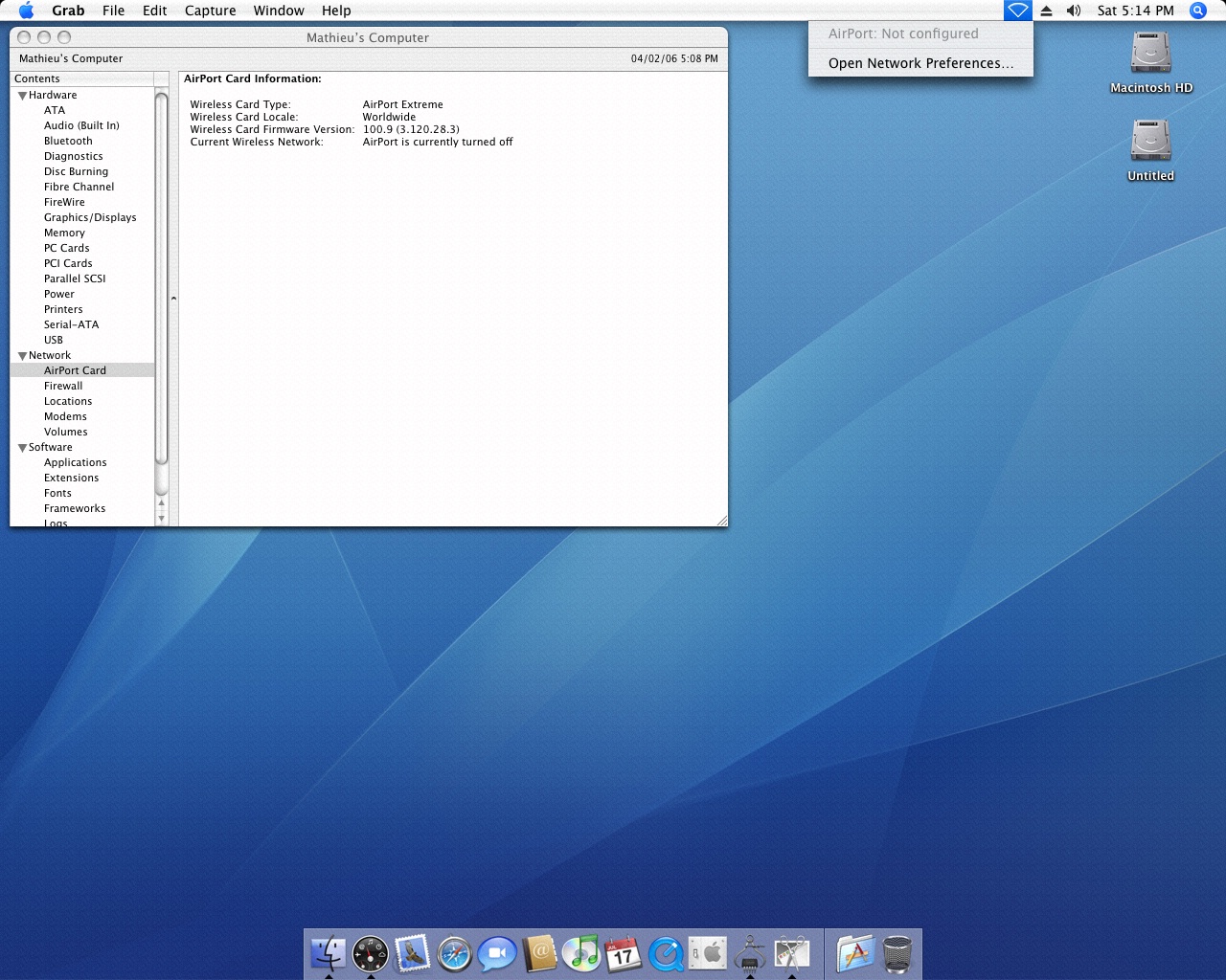

HooKed Posted February 4, 2006 Share Posted February 4, 2006 I have a wierd one for you guys. After editing the kext from 10.4.4 and adding 4318, OSX finds my miniwifi and even the button and light works on the laptop (compaq v200) it also finds my WEP enabled network Here is the wierd part it will not associate with my network and system profiler shows airport extreme but it says that it is off. WTF? even tho the light is on. Anyways I know one of you geeks(no pun intended) will know whats up. Thanks in advance, HooKed Link to comment https://www.insanelymac.com/forum/topic/4641-1043-broadcom-wireless-effort/page/8/#findComment-52582 Share on other sites More sharing options...

HooKed Posted February 5, 2006 Share Posted February 5, 2006 Never mind I fixed it even my wireless strength meter works now compaq v2000 Link to comment https://www.insanelymac.com/forum/topic/4641-1043-broadcom-wireless-effort/page/8/#findComment-53095 Share on other sites More sharing options...
