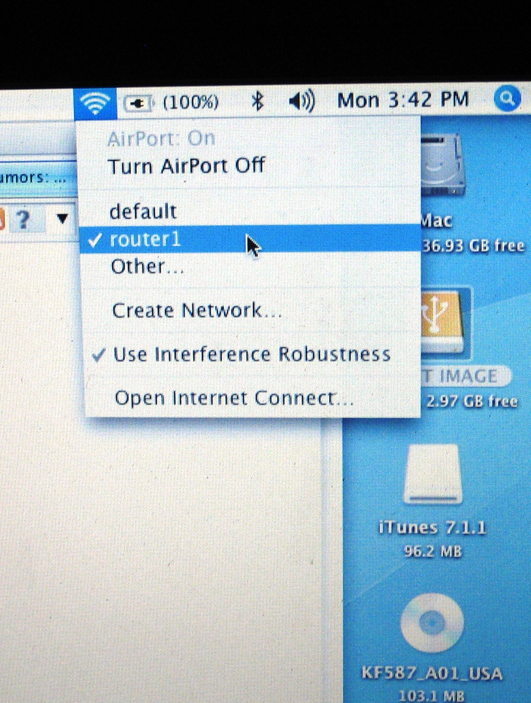

So I ordered a 1490 MiniCard from dell and had it shipped the next day. Cost me 39.99 and DELL didn't even charge me shipping. I installed it the minute I got it and OS X detected it immediately. At first it said not configured. I then went to network preferences and it came up as a new detected interface. I didn't have to load no kext drivers or anything it works prefectly. Even my sound works perfectly I am able to watch movies and all.
Much thanks. Now if I can only get the other things to work... SD reader, CAM, Scroll...
