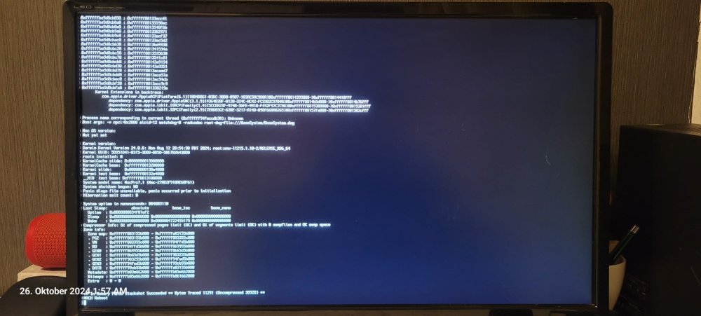

as described above: When I set CSM to "Disabled," the computer boots directly into the BIOS menu. However, if I set CSM to "Enabled," I can boot normally and either start Windows or access the macOS installation via USB.
Here is the boot process after making the change.
Here’s the situation: during boot, the system resets. Unfortunately, the video quality is terrible
Problem 1
The issue causing the system to suddenly reset shortly after booting was due to a minor oversight when editing the spakk.aml file. This SSDT is not optimized for a Ryzen CPU like the Ryzen 7 2700X, as it defines multiple processor objects (PR00 through PR31). This configuration corresponds to a typical multi-core setup designed for a high number of threads or logical CPUs. Since the Ryzen 7 2700X has 8 cores and 16 threads, the system could not logically boot properly with this SSDT. After modifying the SSDT for the Ryzen 7 2700X with 8 cores and 16 threads, it was possible to boot again. Unfortunately, the suggestion from Chris to remove the entries “bluetoothExternalDongleFailed” and “bluetoothinternalControllerInfo” also did not resolve the issue.
Here is the corrected SSDT in case anyone needs it:
