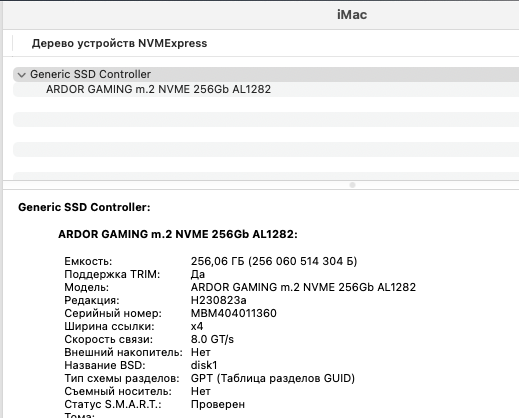

Slice Posted October 15 Share Posted October 15 I am using very cheap NVMe SSD. It works without any drivers in Clover and in Sequoia. 2 Link to comment Share on other sites More sharing options...
