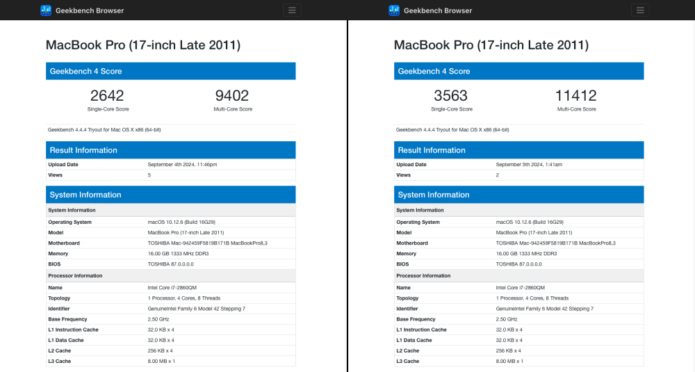

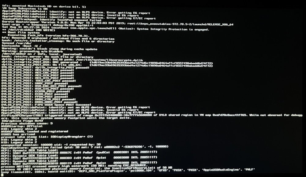

Fortitude Posted September 7 Author Share Posted September 7 (edited) Wanted to let you all know that I managed to get native power management working on my computer. I’ve got some information for the community that might be helpful to others trying to achieve native power management with Sandy and Ivy Bridge systems. In order to disable CFG Lock, I patched my BIOS with UEFIPatch by LongSoft. However, the BIOS patch and generating an SSDT with ssdtPRGen.sh wasn’t enough for me to successfully post. The kernel would stall on ACPI_SMC_PlatformPlugin.kext when disabling DummyPowerManagement, (regardless of the BIOS patch) and I’d get stuck on a black screen when trying to initialize the graphics. This particular kext is located here: /System/Library/Extensions/IOPlatformPluginFamily.kext/Contents/Plugins Showing the package contents and looking within the Resources folder reveals power management settings for a wide range of older SMBIOSes. I experimented with changing my SMBIOS and was able to post when the SMBIOS was specifically changed to an iMac12,2. After discovering this, I reverted back to my original SMBIOS and started deleting things from the corresponding plist file until I could post. I had to delete an array named ringFreqTables. I don’t know if omitting it reduces CPU performance, but it appears that I’m not the first person to do this. Googling that array name yields some results of people deleting or renaming that array within the plist file. I ended up writing a kernel patch which ignores the array across all SMBIOSes: Spoiler <key>Kernel</key> <dict> <key>Patch</key> <array> <dict> <key>Arch</key> <string>Any</string> <key>Base</key> <string></string> <key>Comment</key> <string>Disable ringFreqTables</string> <key>Count</key> <integer>1</integer> <key>Enabled</key> <true/> <key>Find</key> <data>cmluZ0ZyZXFUYWJsZXM=</data> <key>Identifier</key> <string>com.apple.driver.ACPI_SMC_PlatformPlugin</string> <key>Limit</key> <integer>0</integer> <key>Mask</key> <data></data> <key>MaxKernel</key> <string></string> <key>MinKernel</key> <string></string> <key>Replace</key> <data>cmluZ0ZyZXFUYWJsZXo=</data> <key>ReplaceMask</key> <data></data> <key>Skip</key> <integer>0</integer> </dict> </array> </dict> I’m curious why I’d specifically need to do this, and if my ACPI implementation could be adapted for the ringfreqTables array so that I don’t need to do this patch? I ask this because with the array present, the kernel seems to stall after loading some “dynamic” SSDTs related to CPU power management. My CPU performance is much better, but I’m assuming there’s other people with Sandy and Ivy Bridge systems that can post with CFG Lock disabled, and the ringfreqTables array present. (I still require CPUTscSync.kext.) I’ve attached my ACPI tables and the generated PM patch if anyone’s interested in taking a look. The dynamic SSDTs appear to be marked with an x1 in the filename. Finally, here’s my Geekbench scores before and after enabling native power management. ACPI Tables Qosmio X775.zip SSDT-PM.aml Edited September 7 by Fortitude Link to comment Share on other sites More sharing options...

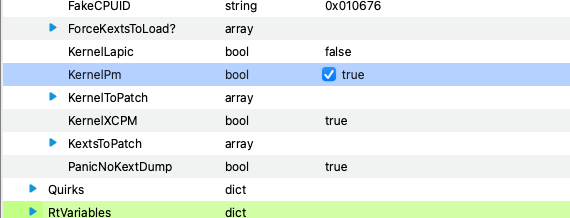

Fortitude Posted Monday at 03:20 AM Author Share Posted Monday at 03:20 AM Looks like the quirk is what I had before which is AppleCpuPmCfgLock. I reverted back to my original unmodified BIOS, and was able to post with that quirk and the kernel patch. Seems to be just as stable, and Geekbench reports similar scores in performance. Link to comment Share on other sites More sharing options...
LockDown Posted Monday at 03:39 AM Share Posted Monday at 03:39 AM 17 minutes ago, Fortitude said: Looks like the quirk is what I had before which is AppleCpuPmCfgLock Clover has no AppleCpuPmCfgLock unless its DummyPowerManagement Link to comment Share on other sites More sharing options...
Fortitude Posted Monday at 09:30 AM Author Share Posted Monday at 09:30 AM https://dortania.github.io/OpenCore-Install-Guide/clover-conversion/Clover-config.html#kernel-and-kext-patches Link to comment Share on other sites More sharing options...
