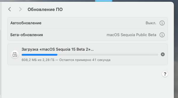

It's really strange, for example, I downloaded it via an iPhone, via a USB cord. Maybe you need to look at what's there according to EN0, EN1?

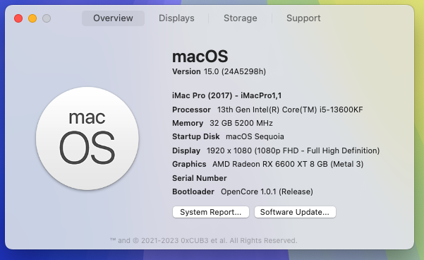

Hi @miliuco  my dear friend!
My friend, with your experience I can just help with some tips that you are certainly more aware of than me.
My hacks went up smoothly with several RestrictEvents tips, Lory's, Dortania's and the one I compiled manually. One is 59kb, the other is 71kb and the compiled one is 80kb.
I have no longer used the bluetooth kexts nor the firmware or patchram3, so I advise removing them if possible.
I would like to tell you that something happens when we use Clover and Opencore interchangeably. I imagine you tried both. But it's worth trying to upload with Clover well configured, because I believe it's more stable for that.
Another important thing is to check if you have a Bios update and, whenever possible, "Load Optimal Defaults" in the Bios before proceeding with the update.
As a last resort, it's worth fixing the Kernel caches, and Maldon has a wonderful tool in Olarila. Follows attached. But I believe it is something related to your kexts, or perhaps an SSDT that is not very well fixed.
Another important thing is to know that when you change SMBIOS, if you happen to use the excellent kext for usb ports, usbports.kext contains SMBIOS. For example, I use SSDT with the compiled RHUBS, and this solved my problem. In the UPC corrective method.
The detail is that when we use Usbports it contains SMBIOS in the plist internally. If you can check (if this is your mapping kext).
Hugs!!
At the time: I forgot said to try iMacPro1,1 SMBIOS: its better to me that others.
