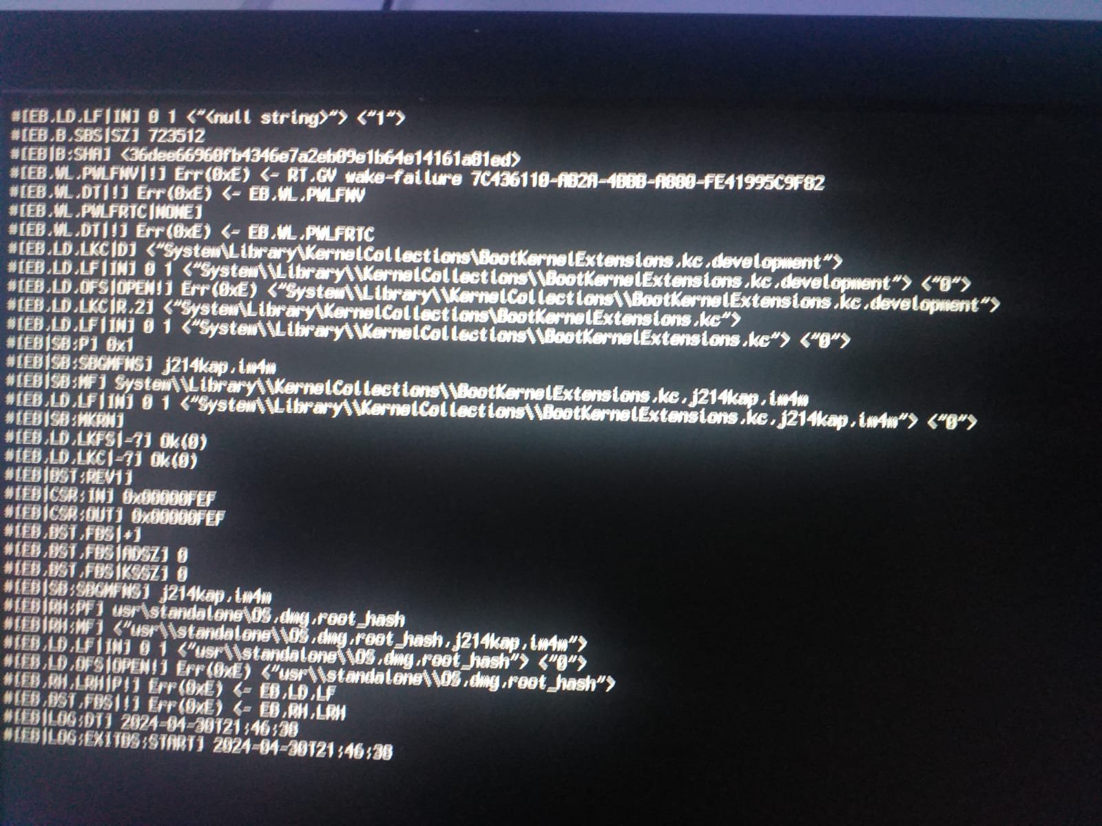

Shimijda Posted April 30 Share Posted April 30 (edited) Hello there. As recently, I wanted to join to the research attempts for tiger lake processors and I wanted to install Ventura 13.6 on my machine for testing the contributors works and give feedback, and of course, for xCode. But It throws me an error that is basically like that. I'm using this GitHub repo of @shl628 as my EFI folder. https://github.com/lshbluesky/Samsung-NT750XDA-KF59U-Hackintosh My system specs are like that: i5-1135G7 (TigerLake) 16GB 3200MHz Kingston if it matters. Intel Wireless AC 3165 Dual Band NVMe M.2 256GB Thank you so much, greetings. -Shimijda. Edited April 30 by Shimijda Added my pc specs. Quote Link to comment Share on other sites More sharing options...

Jacques Michel Posted 3 hours ago Share Posted 3 hours ago On 5/1/2024 at 12:56 AM, Shimijda said: I know the acceleration and other features are missing, the reason I want to install is contribute and test some of the researchs about this unsupported iGPU on macOS. About the link you sent, no, it won't help me. I'm using Intel Iris Xe Graphics as I said. Did you were able to boot up macOS? i have the same cpu 11th tiger-lake with iris Xe graphics.. i need help on my efi opencore Quote Link to comment Share on other sites More sharing options...
LockDown Posted 1 hour ago Share Posted 1 hour ago Try to toggle RebuildAppleMemoryMap in QUIRKS Quote Link to comment Share on other sites More sharing options...
spakk Posted 58 minutes ago Share Posted 58 minutes ago On 5/1/2024 at 9:56 AM, Shimijda said: I know the acceleration and other features are missing, the reason I want to install is contribute and test some of the researchs about this unsupported iGPU on macOS. About the link you sent, no, it won't help me. I'm using Intel Iris Xe Graphics as I said. Upload your EFI folder as a ZIP file so someone can review it and identify any possible configuration errors, aside from the already unsupported graphics card. The error "[LOG:EXITBS:START]" can have various causes. Usually, it is due to minor configuration issues that need to be resolved. Below is a list of possible causes that you should check: Config.plist: ACPI Patches: Install the appropriate patches for your hardware. SMBIOS: Use an SMBIOS that matches your hardware. Quirks: Verify the settings and adjust them if necessary. Installed Kexts: Ensure that the kexts used are compatible with your hardware and macOS version. Update the kexts using OCAT (OpenCore Auxiliary Tools). Debugging:: Enable Debug Mode Activate the debug mode in OpenCore. Set the "Target" value in the Config.plist to 67 or 103 to generate a log file in the EFI partition. If other errors occur, upload the boot log here for further analysis. Review the Boot Log Analyze the log file to identify the root cause of the error. Update OpenCore: Update OpenCore and Kexts Make sure you are using the latest version of OpenCore and all relevant kexts. Updates often resolve known issues and improve compatibility. Use OCAT for this purpose. Intel Iris Xe Graphics Support: The Intel Iris Xe Graphics integrated into the Intel Core i5-1135G7 CPU is not natively supported by macOS. If you have managed to boot the system successfully, refer to the guide shared by a user who patched the graphics card for full acceleration. Here’s a helpful thread that might guide you: https://www.insanelymac.com/forum/topic/358305-80-solved-iris-xe-igpu-on-tiger-lake-successfully-loaded-icllp-frambuffer-and-vram-also-recognizes-1536mb-however-some-issues/ Best luck! 1 Quote Link to comment Share on other sites More sharing options...
