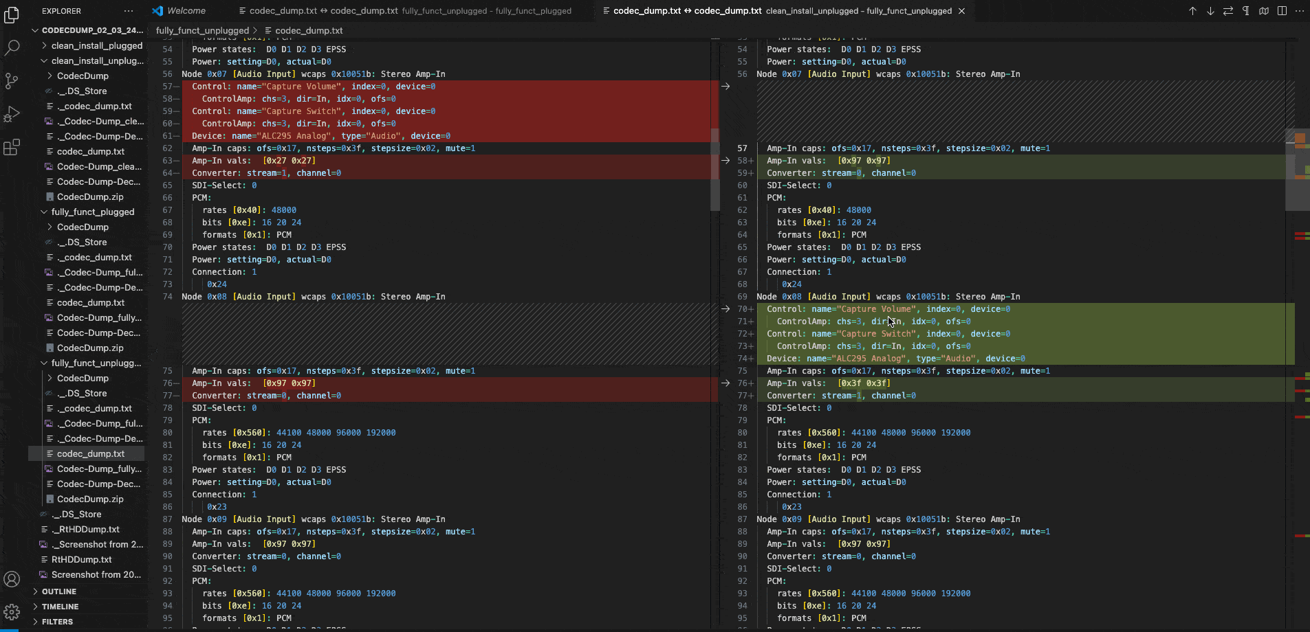

    • I compared the codecdumps obtained on a clean install and after patching the audio with that command and I noticed that many of the fields have been modified.
    • I also compared the fully functional codecdump when the headset is unplugged then plugged and I noticed that some coefficient have been modified.
    • Here I found interesting that according to whether jack is plugged or not:
      • the "Amp-out Vals" of the nodes 2(0x02) and 3(0x03) automatically switch antithetically between disabled state (0x00) and enabled (0x3c) (cf. line 25 and 38) .
      • the "Amp-out Vals" of the nodes 20(0x14) & 33(0x21) automatically switch antithetically between disabled state (0x80) and enabled (0x00) (cf. line 135 & 265).
      • the audio mixer 35(0x23) switches the "Amp-in Vals" of the connected nodes 25(0x19) and 18(0x12) automatically switch antithetically between disabled state (0x80) and enabled (0x00) (cf. line 284).

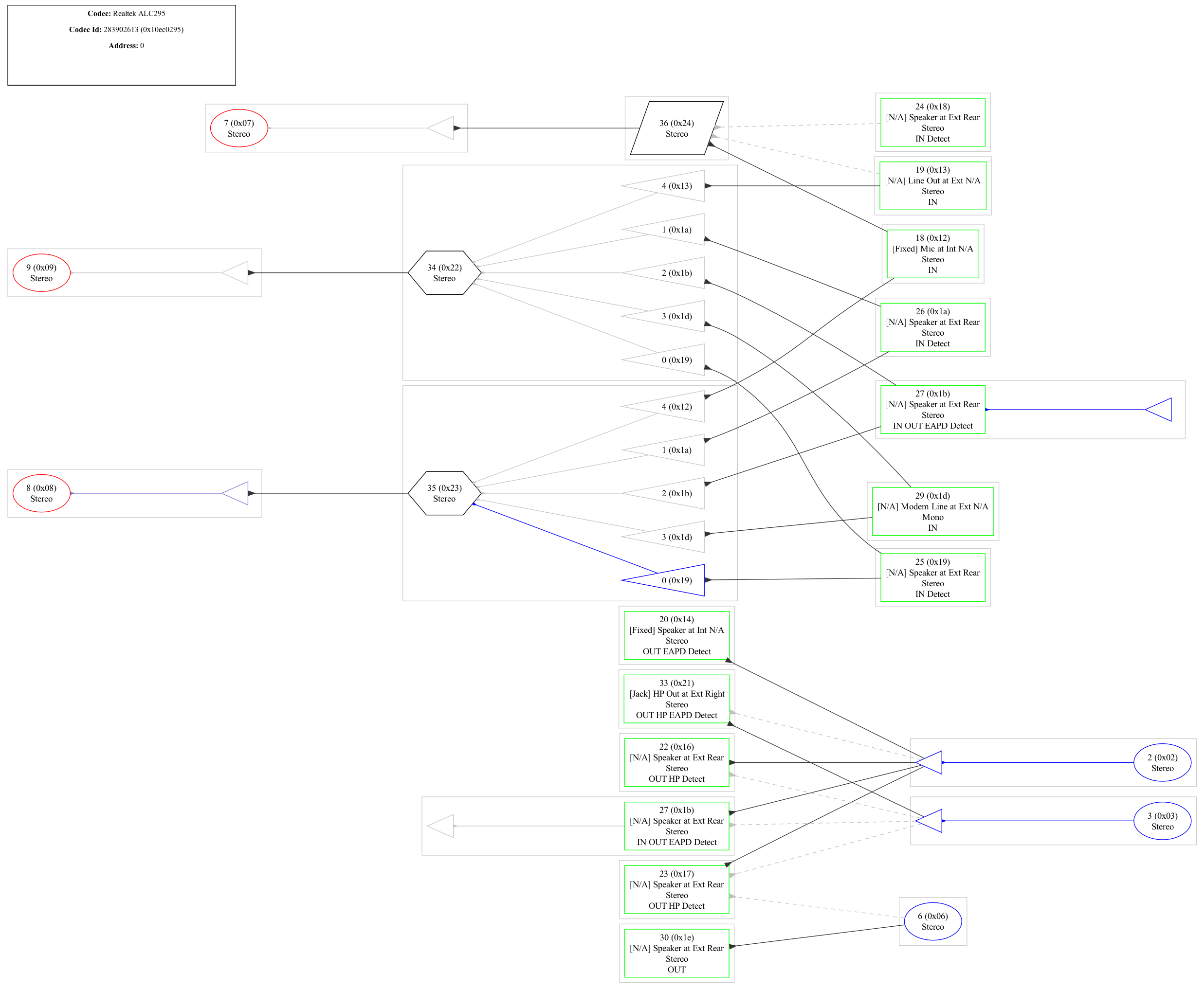

    • What worked best for me was the following pathmaps:
      • Internal speakers: 20(0x14)-->2(0x02)
      • Internal microphone: 8(0x08)-->35(0x23)-->18(0x12)
      • headsets jack speakers: 33(0x21)-->3(0x03)
      • headsets jack microphone: 8(0x08)-->35(0x23)-->25(0x19)
