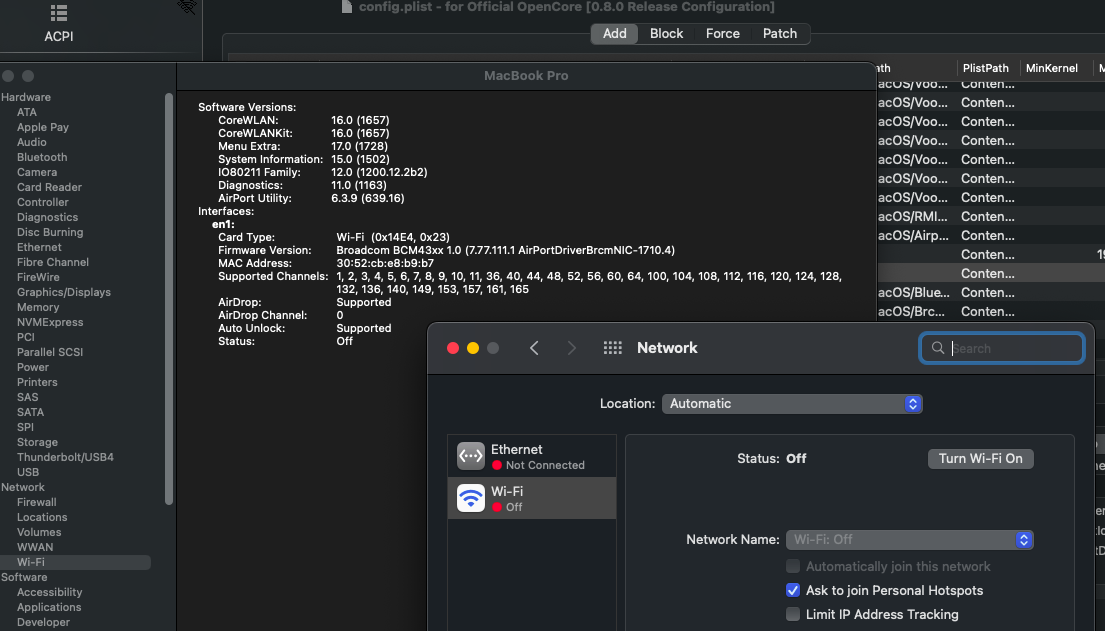

I have this unit running Catalina (from M2 SSD), Big Sur (from SATA SSD)
In either I do not use
<string>pci14e4,4353</string>
WiFi & BT work fine in both (with AirportBrcmFixup.kext/AirPortBrcmNIC_Injector.kext, BrcmBluetoothInjector.kext, BrcmFirmwareData.kext, BrcmPatchRAM3.kext)
Trying to get Monterey working (replacing BrcmBluetoothInjector.kext with BlueToolFixup.kext)
No matter what I try, I never get WiFi working, WiFi shows but turned OFF & I cannot turn it back ON
ASPM is zeroed (disabled) by
<key>pci-aspm-default</key>
PCI\VEN_14E4&DEV_43A3&SUBSYS_00231028&REV_08
(that should be CN-08PKF4 but it is a mislabeled as CN-0VW3T3 which ofcourse is not correct)
I am stumped why it works so easily in 10.15 & 11, but not 12 (I though there was all known about this card by now)
Help much apprecied
Edited by sebus
In the end I just gave up on this card & used Intel AX200NGW (that I had laying around)
With itlwm + Heliport WiFi works fine in any OS booted, the same for BT with IntelBluetoothFirmware.kext, IntelBTPatcher.kext & BlueToolFixup.kext
