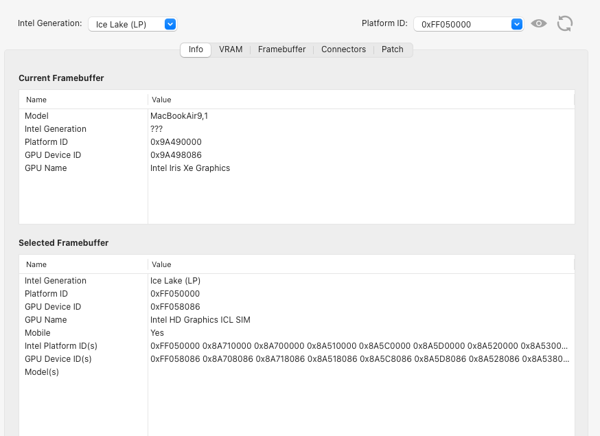

guys cmon don't try to test all at same time - don't use -allow3d
test the tgl framebuffer (internal or production) kext
try with nblue
or
try without nblue. just inject the only allowed ig-platform

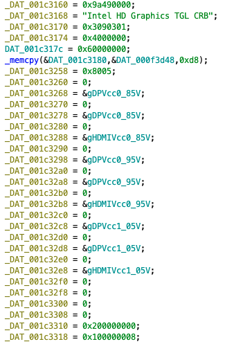

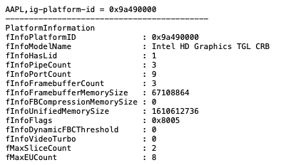

here it is

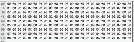

next remenber it as 9 defined connectors
ofc this will crash so you need to inject this properties with opencore to disable most of them (sample for port_8
AAPL08,IgnoreConnection
AAPL08,no-hotplug-interrupt

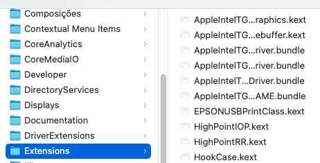

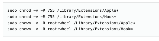

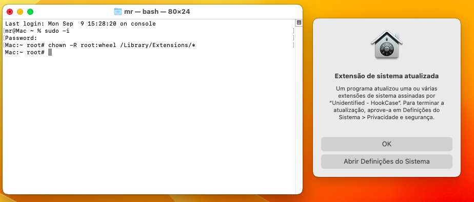

10 hours ago, Mastachief said:
And then these go to /S/L/E?
/System/Library/Extensions (requires SIP disabled, root mounted with write permissions)
1 hour ago, jalavoui said:
so you only need the AppleIntelTGLGraphics.kext and HookCase.kext todo this tests (get any of them from previous posts)
Accelerator kext will not work without a framebuffer kext.

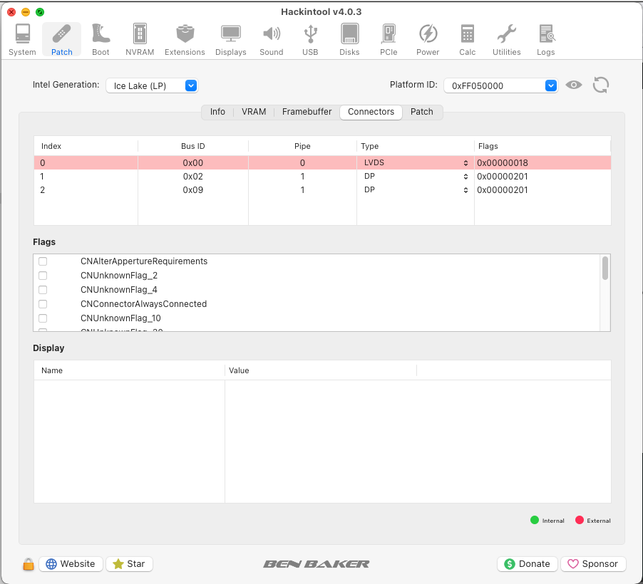

sorry to add to the frustration jala, but i dont know the required settings to implement those AAPL entries into my config or etc. i see no info on google, etc. on how to add them

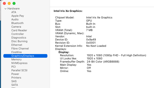

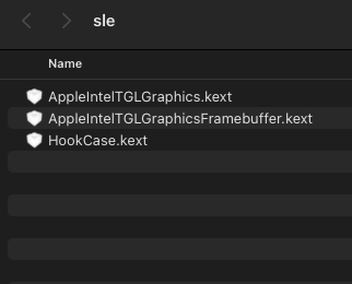

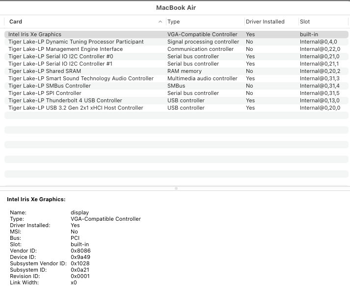

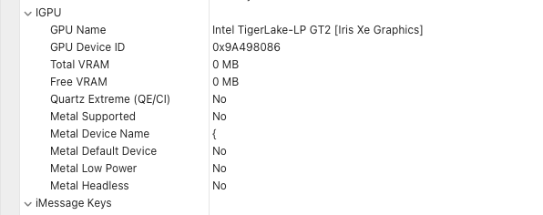

After installing the kexts, It failed to boot normally, however you can use a EFI with a working whatevergreen to boot again as this doesn't access nblue or the tgl kexts during boot.
I'll remount and test again.
AppleIntelTGLGraphics:
  Version: 16.0.32
  Last Modified: 07/09/2024, 10:33 PM
  Bundle ID: com.xxxxx.driver.AppleIntelTGLGraphics
  Notarized: Unknown
  Loaded: No
  Get Info String: AppleIntelTGLGraphics 16.0.32 10
  Obtained from: Unknown
  Kind: Intel
  Architectures: x86_64
  64-Bit (Intel): Yes
  Location: /System/Library/Extensions/AppleIntelTGLGraphics.kext
  Kext Version: 16.0.0
  Loadable: No
  Signature Validation Errors: Kext signature validation error code -67061
  Dependencies: Incomplete
  Dependency Errors:
  Dependency Resolution Failures:
  Indirect dependencies can't be resolved: com.apple.iokit.IOPCIFamily, com.apple.iokit.IOSurface, org.smichaud.HookCase, com.apple.iokit.IOGraphicsFamily, com.apple.iokit.IOAcceleratorFamily2
  Signed by: Unknown
Edited by Mastachief

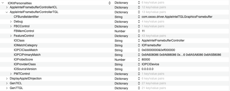

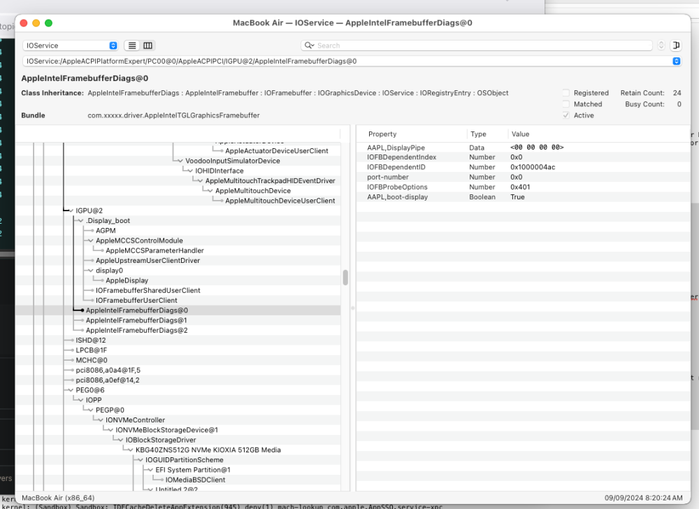

yeah my issue is with the whatevergreen fork chief is i tried the numerous whatevergreen properties here, it fails to boot for me. i tried also the weg faq no fix. as i say my device ID is 9A68 i checked lspci -k in gentoo linux
use with nblue in EFI/OC/Kexts. put hookcase + sle_internal in L/E. do not try other combos cause the patches are all inside nblue.
won't work with production version unless you can xcode
do not boot with -allow3d
this all came from a previous bug Visual made - that was inspiring

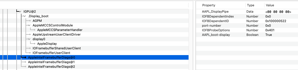

check logs and ioreg
i did get surprised with the results

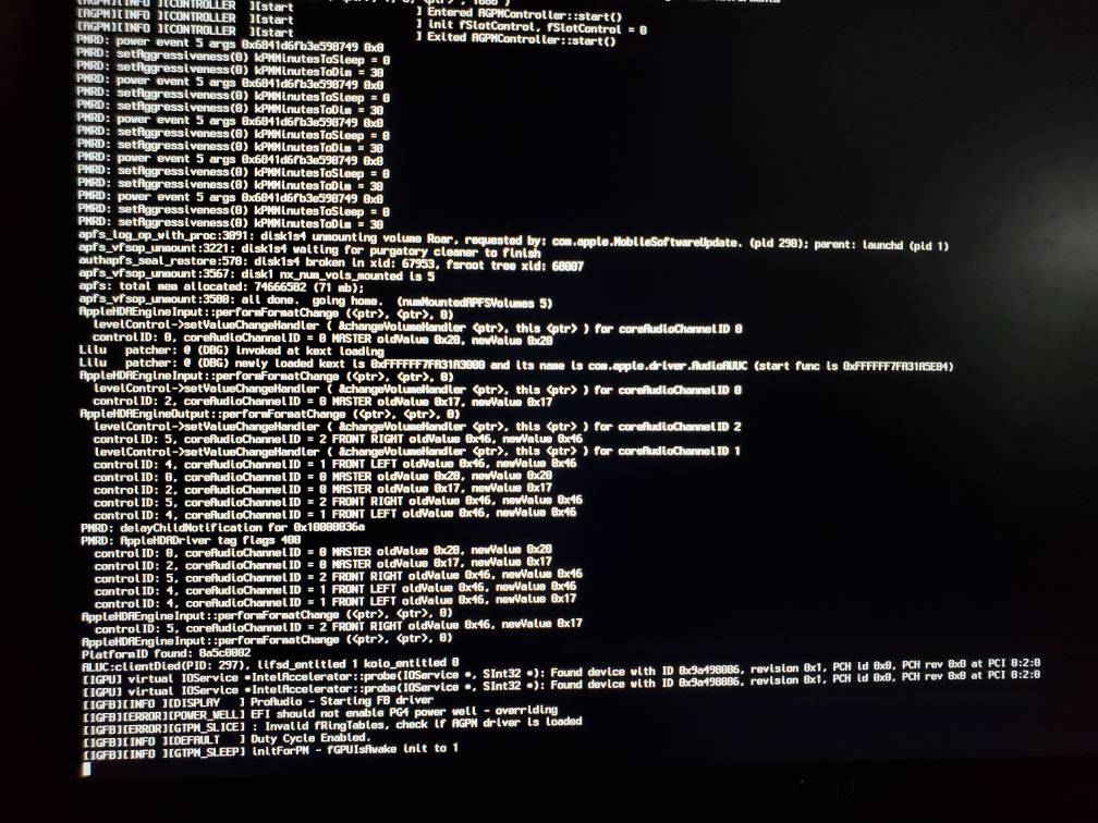

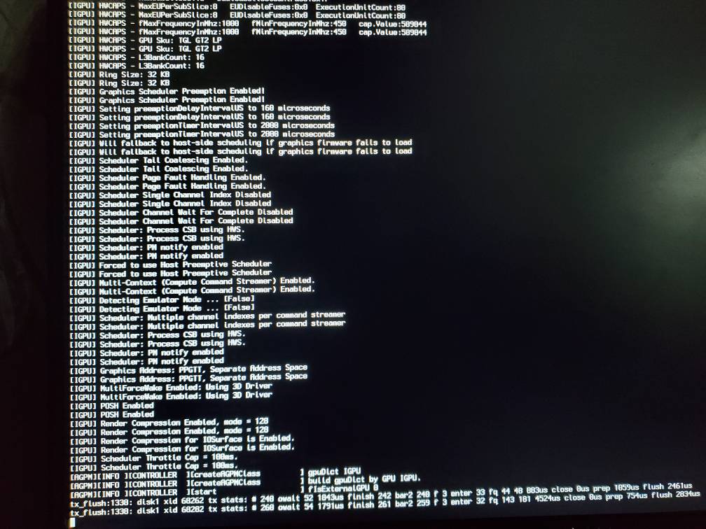

2024-09-09 03:35:25.787707+0100  localhost kernel[0]: (AppleIntelTGLGraphics) [IGPU] Failing probe (-allow3d is NOT set in boot-arg)!
2024-09-09 03:35:25.787750+0100  localhost kernel[0]: (AppleIntelTGLGraphicsFramebuffer) [IGFB][DEBUG][DISPLAY   ][AppleIntelController.cpp : 1557 ][start               ]     fBootFlags = 0
2024-09-09 03:35:25.787755+0100  localhost kernel[0]: (AppleIntelTGLGraphicsFramebuffer) [IGFB][DEBUG][DISPLAY   ][AppleIntelController.cpp : 1560 ][start               ]     fAGPMLogBits = 0
2024-09-09 03:35:25.787759+0100  localhost kernel[0]: (AppleIntelTGLGraphicsFramebuffer) [IGFB][DEBUG][DISPLAY   ][AppleIntelController.cpp : 1563 ][start               ]     fAGPMLogMaskprintf = 0
2024-09-09 03:35:25.787778+0100  localhost kernel[0]: (AppleIntelTGLGraphicsFramebuffer) [IGFB][DEBUG][DISPLAY   ][AppleIntelController.cpp : 1590 ][start               ]     fPCIDeviceID = 0x9a498086
2024-09-09 03:35:25.787783+0100  localhost kernel[0]: (AppleIntelTGLGraphicsFramebuffer) [IGFB][DEBUG][DISPLAY   ][AppleIntelController.cpp : 1593 ][start               ]     fPCIConfigRevisionID = 0x1
2024-09-09 03:35:25.787793+0100  localhost kernel[0]: (AppleIntelTGLGraphicsFramebuffer) [IGFB][DEBUG][DISPLAY   ][AppleIntelController.cpp : 1596 ][start               ]     fPCISubSystemID = 0x14641025
2024-09-09 03:35:25.787803+0100  localhost kernel[0]: (AppleIntelTGLGraphicsFramebuffer) [IGFB][DEBUG][DISPLAY   ][AppleIntelController.cpp : 1661 ][start               ]     Range[0] 0x4010000000:01000000
2024-09-09 03:35:25.787809+0100  localhost kernel[0]: (AppleIntelTGLGraphicsFramebuffer) [IGFB][DEBUG][DISPLAY   ][AppleIntelController.cpp : 1661 ][start               ]     Range[1] 0x4000000000:10000000
2024-09-09 03:35:25.787815+0100  localhost kernel[0]: (AppleIntelTGLGraphicsFramebuffer) [IGFB][DEBUG][DISPLAY   ][AppleIntelController.cpp : 1661 ][start               ]     Range[2] 0x4000:00000040
2024-09-09 03:35:25.787823+0100  localhost kernel[0]: (AppleIntelTGLGraphicsFramebuffer) [IGFB][DEBUG][DISPLAY   ][AppleIntelController.cpp : 1680 ][start               ]     MMIO range@0x10 (0x4010000000) mapped to kernel virtual address 0xffffffcc986cd000
2024-09-09 03:35:25.787830+0100  localhost kernel[0]: (AppleIntelTGLGraphicsFramebuffer) [IGFB][DEBUG][DISPLAY   ][AppleIntelController.cpp : 4892 ][getPlatformID       ]     AAPL,ig-platform-id = 0x9a490000
2024-09-09 03:35:25.787834+0100  localhost kernel[0]: (AppleIntelTGLGraphicsFramebuffer) [IGFB][DEBUG][DISPLAY   ][AppleIntelController.cpp : 4965 ][getOSInformation    ]     -------------------------------------------
2024-09-09 03:35:25.787838+0100  localhost kernel[0]: (AppleIntelTGLGraphicsFramebuffer) [IGFB][DEBUG][DISPLAY   ][AppleIntelController.cpp : 4966 ][getOSInformation    ]     PlatformInformation
2024-09-09 03:35:25.787842+0100  localhost kernel[0]: (AppleIntelTGLGraphicsFramebuffer) [IGFB][DEBUG][DISPLAY   ][AppleIntelController.cpp : 4967 ][getOSInformation    ]     fInfoPlatformID              : 0x9a490000
2024-09-09 03:35:25.787846+0100  localhost kernel[0]: (AppleIntelTGLGraphicsFramebuffer) [IGFB][DEBUG][DISPLAY   ][AppleIntelController.cpp : 4968 ][getOSInformation    ]     fInfoModelName               : Intel HD Graphics TGL CRB
2024-09-09 03:35:25.787850+0100  localhost kernel[0]: (AppleIntelTGLGraphicsFramebuffer) [IGFB][DEBUG][DISPLAY   ][AppleIntelController.cpp : 4969 ][getOSInformation    ]     fInfoHasLid                  : 1
2024-09-09 03:35:25.787854+0100  localhost kernel[0]: (AppleIntelTGLGraphicsFramebuffer) [IGFB][DEBUG][DISPLAY   ][AppleIntelController.cpp : 4970 ][getOSInformation    ]     fInfoPipeCount               : 3
2024-09-09 03:35:25.787859+0100  localhost kernel[0]: (AppleIntelTGLGraphicsFramebuffer) [IGFB][DEBUG][DISPLAY   ][AppleIntelController.cpp : 4971 ][getOSInformation    ]     fInfoPortCount               : 9
2024-09-09 03:35:25.787863+0100  localhost kernel[0]: (AppleIntelTGLGraphicsFramebuffer) [IGFB][DEBUG][DISPLAY   ][AppleIntelController.cpp : 4972 ][getOSInformation    ]     fInfoFramebufferCount        : 3
2024-09-09 03:35:25.787868+0100  localhost kernel[0]: (AppleIntelTGLGraphicsFramebuffer) [IGFB][DEBUG][DISPLAY   ][AppleIntelController.cpp : 4973 ][getOSInformation    ]     fInfoFramebufferMemorySize   : 67108864
2024-09-09 03:35:25.787872+0100  localhost kernel[0]: (AppleIntelTGLGraphicsFramebuffer) [IGFB][DEBUG][DISPLAY   ][AppleIntelController.cpp : 4974 ][getOSInformation    ]     fInfoFBCompressionMemorySize : 0
2024-09-09 03:35:25.787877+0100  localhost kernel[0]: (AppleIntelTGLGraphicsFramebuffer) [IGFB][DEBUG][DISPLAY   ][AppleIntelController.cpp : 4975 ][getOSInformation    ]     fInfoUnifiedMemorySize       : 1610612736
2024-09-09 03:35:25.787881+0100  localhost kernel[0]: (AppleIntelTGLGraphicsFramebuffer) [IGFB][DEBUG][DISPLAY   ][AppleIntelController.cpp : 4976 ][getOSInformation    ]     fInfoFlags                   : 0x8005
2024-09-09 03:35:25.787886+0100  localhost kernel[0]: (AppleIntelTGLGraphicsFramebuffer) [IGFB][DEBUG][DISPLAY   ][AppleIntelController.cpp : 4977 ][getOSInformation    ]     fInfoDynamicFBCThreshold     : 0
2024-09-09 03:35:25.787890+0100  localhost kernel[0]: (AppleIntelTGLGraphicsFramebuffer) [IGFB][DEBUG][DISPLAY   ][AppleIntelController.cpp : 4978 ][getOSInformation    ]     fInfoVideoTurbo              : 0
2024-09-09 03:35:25.787895+0100  localhost kernel[0]: (AppleIntelTGLGraphicsFramebuffer) [IGFB][DEBUG][DISPLAY   ][AppleIntelController.cpp : 4979 ][getOSInformation    ]     fMaxSliceCount               : 2
2024-09-09 03:35:25.787899+0100  localhost kernel[0]: (AppleIntelTGLGraphicsFramebuffer) [IGFB][DEBUG][DISPLAY   ][AppleIntelController.cpp : 4980 ][getOSInformation    ]     fMaxEUCount                  : 8
2024-09-09 03:35:25.787903+0100  localhost kernel[0]: (AppleIntelTGLGraphicsFramebuffer) [IGFB][DEBUG][DISPLAY   ][AppleIntelController.cpp : 4981 ][getOSInformation    ]     -------------------------------------------
2024-09-09 03:35:25.787912+0100  localhost kernel[0]: (AppleIntelTGLGraphicsFramebuffer) [IGFB][DEBUG][DISPLAY   ][AppleIntelController.cpp :12333 ][registerWithAICPM   ]     PMIOCRINGTABLEINIT(GTVA=0xffffffcc986cd000, PCUVA=0xffffffcc9880d000, minFreq=100, maxFreq=1300, freqStep=50, count=25):ret=-1
2024-09-09 03:35:25.787918+0100  localhost kernel[0]: (AppleIntelTGLGraphicsFramebuffer) [IGFB][DEBUG][DISPLAY   ][AppleIntelController.cpp :12338 ][registerWithAICPM   ]     PMIOCCURRENTGTFREQFN(func=0xffffff7f9cd9e26a):ret=-1
2024-09-09 03:35:25.787928+0100  localhost kernel[0]: (AppleIntelTGLGraphicsFramebuffer) [IGFB][DEBUG][DISPLAY   ][AppleIntelController.cpp : 5131 ][getFeatureControl   ]       FeatureControl found in plist
2024-09-09 03:35:25.787933+0100  localhost kernel[0]: (AppleIntelTGLGraphicsFramebuffer) [IGFB][DEBUG][DISPLAY   ][AppleIntelController.cpp : 5150 ][getFeatureControl   ]       fFBCBypassEnable set to 0
2024-09-09 03:35:25.787939+0100  localhost kernel[0]: (AppleIntelTGLGraphicsFramebuffer) [IGFB][DEBUG][DISPLAY   ][AppleIntelController.cpp : 5160 ][getFeatureControl   ]       fAGCOverlayCacheEDIDDisable set to 0
2024-09-09 03:35:25.787944+0100  localhost kernel[0]: (AppleIntelTGLGraphicsFramebuffer) [IGFB][DEBUG][DISPLAY   ][AppleIntelController.cpp : 5171 ][getFeatureControl   ]       DynamicRingTables set to 0
2024-09-09 03:35:25.787950+0100  localhost kernel[0]: (AppleIntelTGLGraphicsFramebuffer) [IGFB][DEBUG][DISPLAY   ][AppleIntelController.cpp : 5189 ][getFeatureControl   ]       fEnableSliceShutdown set to 1, fEnableSliceShutdownOld set to 0
2024-09-09 03:35:25.787956+0100  localhost kernel[0]: (AppleIntelTGLGraphicsFramebuffer) [IGFB][DEBUG][DISPLAY   ][AppleIntelController.cpp : 5197 ][getFeatureControl   ]       fEnableSubliceShutdown set to 1
2024-09-09 03:35:25.787961+0100  localhost kernel[0]: (AppleIntelTGLGraphicsFramebuffer) [IGFB][DEBUG][DISPLAY   ][AppleIntelController.cpp : 5205 ][getFeatureControl   ]       fEnableSliceShutdown set to 1
2024-09-09 03:35:25.787966+0100  localhost kernel[0]: (AppleIntelTGLGraphicsFramebuffer) [IGFB][DEBUG][DISPLAY   ][AppleIntelController.cpp : 5216 ][getFeatureControl   ]       fIgnoreHMDSetting set to 0
2024-09-09 03:35:25.787971+0100  localhost kernel[0]: (AppleIntelTGLGraphicsFramebuffer) [IGFB][DEBUG][DISPLAY   ][AppleIntelController.cpp : 5228 ][getFeatureControl   ]       fLoadRingOverridePerSlice set to 1
2024-09-09 03:35:25.787977+0100  localhost kernel[0]: (AppleIntelTGLGraphicsFramebuffer) [IGFB][DEBUG][DISPLAY   ][AppleIntelController.cpp : 5236 ][getFeatureControl   ]       fEnableDynamicFBC set to 0
2024-09-09 03:35:25.787982+0100  localhost kernel[0]: (AppleIntelTGLGraphicsFramebuffer) [IGFB][DEBUG][DISPLAY   ][AppleIntelController.cpp : 5247 ][getFeatureControl   ]       fBusyTimerValue set to 3000
2024-09-09 03:35:25.787987+0100  localhost kernel[0]: (AppleIntelTGLGraphicsFramebuffer) [IGFB][DEBUG][DISPLAY   ][AppleIntelController.cpp : 5257 ][getFeatureControl   ]       fFastDisplayDetectDisable set to 0
2024-09-09 03:35:25.787992+0100  localhost kernel[0]: (AppleIntelTGLGraphicsFramebuffer) [IGFB][DEBUG][DISPLAY   ][AppleIntelController.cpp : 5268 ][getFeatureControl   ]       fDitherMode set to 0
2024-09-09 03:35:25.787996+0100  localhost kernel[0]: (AppleIntelTGLGraphicsFramebuffer) [IGFB][DEBUG][DISPLAY   ][AppleIntelController.cpp : 5278 ][getFeatureControl   ]       fDitherDisable set to 0
2024-09-09 03:35:25.788000+0100  localhost kernel[0]: (AppleIntelTGLGraphicsFramebuffer) [IGFB][DEBUG][DISPLAY   ][AppleIntelController.cpp : 5289 ][getFeatureControl   ]       DynamicFBCFrameCount set to 3
2024-09-09 03:35:25.788006+0100  localhost kernel[0]: (AppleIntelTGLGraphicsFramebuffer) [IGFB][DEBUG][DISPLAY   ][AppleIntelController.cpp : 5300 ][getFeatureControl   ]       DeltaFlipThreshold set to 18000000
2024-09-09 03:35:25.788011+0100  localhost kernel[0]: (AppleIntelTGLGraphicsFramebuffer) [IGFB][DEBUG][DISPLAY   ][AppleIntelController.cpp : 5311 ][getFeatureControl   ]       TransactionCountTime set to 1000
2024-09-09 03:35:25.788017+0100  localhost kernel[0]: (AppleIntelTGLGraphicsFramebuffer) [IGFB][DEBUG][DISPLAY   ][AppleIntelController.cpp : 5318 ][getFeatureControl   ]       fNumTransactionsThreshold set to 0
2024-09-09 03:35:25.788023+0100  localhost kernel[0]: (AppleIntelTGLGraphicsFramebuffer) [IGFB][DEBUG][DISPLAY   ][AppleIntelController.cpp : 5334 ][getFeatureControl   ]       fEnableMultipipeScaler set to 0
2024-09-09 03:35:25.788029+0100  localhost kernel[0]: (AppleIntelTGLGraphicsFramebuffer) [IGFB][DEBUG][DISPLAY   ][AppleIntelController.cpp : 5343 ][getFeatureControl   ]       EnableMultipipeScaler set to 1
2024-09-09 03:35:25.788035+0100  localhost kernel[0]: (AppleIntelTGLGraphicsFramebuffer) [IGFB][DEBUG][DISPLAY   ][AppleIntelController.cpp : 5353 ][getFeatureControl   ]       fEnableGamma set to 1
2024-09-09 03:35:25.788040+0100  localhost kernel[0]: (AppleIntelTGLGraphicsFramebuffer) [IGFB][DEBUG][DISPLAY   ][AppleIntelController.cpp : 5363 ][getFeatureControl   ]       fPowerStatesEnable set to 1
2024-09-09 03:35:25.788045+0100  localhost kernel[0]: (AppleIntelTGLGraphicsFramebuffer) [IGFB][DEBUG][DISPLAY   ][AppleIntelController.cpp : 5369 ][getFeatureControl   ]       fRenderStandbyEnable set to 1
2024-09-09 03:35:25.788052+0100  localhost kernel[0]: (AppleIntelTGLGraphicsFramebuffer) [IGFB][DEBUG][DISPLAY   ][AppleIntelController.cpp : 5392 ][getFeatureControl   ]       fDisableInternalPanel set to 0
2024-09-09 03:35:25.788058+0100  localhost kernel[0]: (AppleIntelTGLGraphicsFramebuffer) [IGFB][DEBUG][DISPLAY   ][AppleIntelController.cpp : 5402 ][getFeatureControl   ]       fRCxEIModeEnable set to 1
2024-09-09 03:35:25.788063+0100  localhost kernel[0]: (AppleIntelTGLGraphicsFramebuffer) [IGFB][DEBUG][DISPLAY   ][AppleIntelController.cpp : 5415 ][getFeatureControl   ]       fGPUInterruptHandlingEnable set to 1
2024-09-09 03:35:25.788069+0100  localhost kernel[0]: (AppleIntelTGLGraphicsFramebuffer) [IGFB][DEBUG][DISPLAY   ][AppleIntelController.cpp : 5426 ][getFeatureControl   ]       DPM set to 1
2024-09-09 03:35:25.788077+0100  localhost kernel[0]: (AppleIntelTGLGraphicsFramebuffer) [IGFB][DEBUG][DISPLAY   ][AppleIntelController.cpp : 5491 ][getFeatureControl   ]       [GFXPMFB] fDynamicSliceSwitch = 0 fGFMPPFMSupport = 1
2024-09-09 03:35:25.788084+0100  localhost kernel[0]: (AppleIntelTGLGraphicsFramebuffer) [IGFB][DEBUG][DISPLAY   ][AppleIntelController.cpp : 5501 ][getFeatureControl   ]       fMessageAGPMTimerValue = 1
2024-09-09 03:35:25.788089+0100  localhost kernel[0]: (AppleIntelTGLGraphicsFramebuffer) [IGFB][DEBUG][DISPLAY   ][AppleIntelController.cpp : 5521 ][getFeatureControl   ]       Threading Mode: 1
2024-09-09 03:35:25.788095+0100  localhost kernel[0]: (AppleIntelTGLGraphicsFramebuffer) [IGFB][DEBUG][DISPLAY   ][AppleIntelController.cpp : 5531 ][getFeatureControl   ]       fEnableSetRC6Voltage set to 0
2024-09-09 03:35:25.788101+0100  localhost kernel[0]: (AppleIntelTGLGraphicsFramebuffer) [IGFB][DEBUG][DISPLAY   ][AppleIntelController.cpp : 5541 ][getFeatureControl   ]       fEnableDeepDisplay set to false
2024-09-09 03:35:25.788107+0100  localhost kernel[0]: (AppleIntelTGLGraphicsFramebuffer) [IGFB][DEBUG][DISPLAY   ][AppleIntelController.cpp : 5551 ][getFeatureControl   ]       fDisableDFB set to 0x00000000
2024-09-09 03:35:25.788113+0100  localhost kernel[0]: (AppleIntelTGLGraphicsFramebuffer) [IGFB][DEBUG][DISPLAY   ][AppleIntelController.cpp : 5561 ][getFeatureControl   ]       fEnableDFB set to 0x00000000
2024-09-09 03:35:25.788119+0100  localhost kernel[0]: (AppleIntelTGLGraphicsFramebuffer) [IGFB][DEBUG][DISPLAY   ][AppleIntelController.cpp : 5571 ][getFeatureControl   ]       fEDPDownSpreadDisable set to false
2024-09-09 03:35:25.788124+0100  localhost kernel[0]: (AppleIntelTGLGraphicsFramebuffer) [IGFB][DEBUG][DISPLAY   ][AppleIntelController.cpp : 5588 ][getFeatureControl   ]       fDPDownSpreadDisable set to false
2024-09-09 03:35:25.788130+0100  localhost kernel[0]: (AppleIntelTGLGraphicsFramebuffer) [IGFB][DEBUG][DISPLAY   ][AppleIntelController.cpp : 5598 ][getFeatureControl   ]       fASRDisable set to false
2024-09-09 03:35:25.788137+0100  localhost kernel[0]: (AppleIntelTGLGraphicsFramebuffer) [IGFB][DEBUG][DISPLAY   ][AppleIntelController.cpp : 5608 ][getFeatureControl   ]       fPStateOccupancyReportUsed set to true
2024-09-09 03:35:25.788143+0100  localhost kernel[0]: (AppleIntelTGLGraphicsFramebuffer) [IGFB][DEBUG][DISPLAY   ][AppleIntelController.cpp : 5618 ][getFeatureControl   ]       fLogSyncAsyncFlipChanges set to false
2024-09-09 03:35:25.788149+0100  localhost kernel[0]: (AppleIntelTGLGraphicsFramebuffer) [IGFB][DEBUG][DISPLAY   ][AppleIntelController.cpp : 5628 ][getFeatureControl   ]       fEnable8kMode set to 1
2024-09-09 03:35:25.788156+0100  localhost kernel[0]: (AppleIntelTGLGraphicsFramebuffer) [IGFB][DEBUG][DISPLAY   ][AppleIntelController.cpp : 5638 ][getFeatureControl   ]       fNoApertureAccess set to 0
2024-09-09 03:35:25.788161+0100  localhost kernel[0]: (AppleIntelTGLGraphicsFramebuffer) [IGFB][DEBUG][DISPLAY   ][AppleIntelController.cpp : 5648 ][getFeatureControl   ]       EnableTconScaler set to 0
2024-09-09 03:35:25.788172+0100  localhost kernel[0]: (AppleIntelTGLGraphicsFramebuffer) [IGFB][DEBUG][DISPLAY   ][AppleIntelController.cpp : 5757 ][getFeatureControl   ]       TracePointEnable set to 0

theory here is if you get a similiar log then this kext might work for you
for devs: p1 patches in nblue are internal. p are production patches. they can't be mixed or lilu fails to apply
need to fix missing functions inside hookcase to remove non crash patches.

  • Like 3
Can you share you current config.plist?
To test i place nblue in EFI/OC/Kexts
and hookcase + sle_internal (AppleIntelTGLGraphicsFramebuffer.kext only) in L/E
i get  iGPU hang message in verbose boot.
If I put nblue + hookcase + sle_internal (AppleIntelTGLGraphicsFramebuffer.kext only) in L/E (and disable nblue in EFI/OC/Kexts)
i get the same result, iGPU hang.
funny thing is, if i put back the previous nblue in EFI/OC/Kexts i can boot to the GUI again. I am attaching the current nblue that works for me and my current config.plist
NootedBlue.kext.zip
Config.plist
Keep in mind that the attached config.plist (based on nblue) is different from the one on Github (that one is based on WhateverGreen) so dont mix and match the files.
remove the -allow3d boot arg, you need AppleIntelTGLGraphics.kext from sle_Internal. and ofc rebuild the cache by deleting aux.kc and fixing permissions to get sys prefs autorization message. sle folder as other bundles but also tgl frame production version (not needed atm)
ups i mixed the production with internal patches. sec i'll update nblue
done
Edited by jalavoui

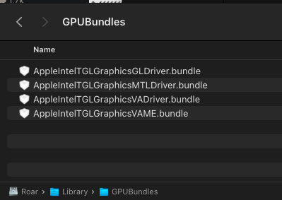

Results after your suggestions; should i leave the bundles in /Library/GPUBundles?
Hackintool boot log ---> hackintool bootlog.txt
2024-09-09 04:23:10.240321-0500 0x4354     Error       0x0                  0      0    kernel: (Sandbox) Sandbox: findmybeaconingd(327) deny(1) mach-lookup com.apple.timed.xpc
2024-09-09 04:23:10.243138-0500 0x4251     Error       0x0                  0      0    kernel: (Sandbox) 3 duplicate reports for Sandbox: findmybeaconingd(327) deny(1) mach-lookup com.apple.timed.xpc
2024-09-09 04:23:10.243147-0500 0x4251     Error       0x0                  0      0    kernel: (Sandbox) Sandbox: airportd(225) deny(1) file-read-xattr /usr/sbin/bluetoothd
2024-09-09 04:23:10.259118-0500 0x47ae     Default     0x0                  0      0    kernel: (IO80211Family) com.apple.p2p.stats: [bluetoothd] succeeded in calling newUserClient, type[0x00000000], role[1], ret[0x00000000]
2024-09-09 04:23:10.282408-0500 0x4354     Error       0x0                  0      0    kernel: (Sandbox) 3 duplicate reports for Sandbox: airportd(225) deny(1) file-read-xattr /usr/sbin/bluetoothd
2024-09-09 04:23:10.282419-0500 0x4354     Error       0x0                  0      0    kernel: (Sandbox) Sandbox: findmybeaconingd(327) deny(1) mach-lookup com.apple.timed.xpc
2024-09-09 04:23:10.287825-0500 0x4251     Error       0x0                  0      0    kernel: (Sandbox) 3 duplicate reports for Sandbox: findmybeaconingd(327) deny(1) mach-lookup com.apple.timed.xpc
2024-09-09 04:23:10.287836-0500 0x4251     Error       0x0                  0      0    kernel: (Sandbox) Sandbox: airportd(225) deny(1) file-read-xattr /usr/sbin/bluetoothd
2024-09-09 04:23:10.302871-0500 0x4251     Default     0x0                  0      0    kernel: (IO80211Family) [IOC DEBUG] EXTERNAL: Get type=<APPLE80211_IOC_WOW_PARAMETERS> Int=<Infrastructure> res=<FAIL:-536870201:0xe00002c7> handler=1 isLegcay=0
2024-09-09 04:23:10.322840-0500 0x4354     Error       0x0                  0      0    kernel: (Sandbox) Sandbox: findmybeaconingd(327) deny(1) mach-lookup com.apple.timed.xpc
2024-09-09 04:23:10.425030-0500 0x4694     Default     0x0                  0      0    kernel: KextLog: AuxKC bundle com.xxxxx.driver.AppleIntelTGLGraphicsFramebuffer marked as loadable
2024-09-09 04:23:10.437743-0500 0x4694     Default     0x0                  0      0    kernel: OSMetaClass: Kext com.xxxxx.driver.AppleIntelTGLGraphicsFramebuffer class AppleIntelPlane is a duplicate;kext com.apple.driver.AppleIntelICLLPGraphicsFramebuffer already has a class by that name.
2024-09-09 04:23:10.437752-0500 0x4694     Default     0x0                  0      0    kernel: Kext com.xxxxx.driver.AppleIntelTGLGraphicsFramebuffer did not start (return code 0xdc00400a).
2024-09-09 04:23:10.437755-0500 0x4694     Default     0x0                  0      0    kernel: Kext com.xxxxx.driver.AppleIntelTGLGraphicsFramebuffer start failed (result 0xdc00400a).
2024-09-09 04:23:10.437757-0500 0x4694     Default     0x0                  0      0    kernel: Kext com.xxxxx.driver.AppleIntelTGLGraphicsFramebuffer failed to load (0xdc008017).
2024-09-09 04:23:10.437760-0500 0x4694     Default     0x0                  0      0    kernel: Failed to load kext com.xxxxx.driver.AppleIntelTGLGraphicsFramebuffer (error 0xdc008017).
2024-09-09 04:23:10.442139-0500 0x4694     Default     0x0                  0      0    kernel: KextLog: AuxKC bundle com.highpoint-tech.kext.HighPointIOP marked as loadable
2024-09-09 04:23:10.445588-0500 0x4694     Default     0x0                  0      0    kernel: KextLog: AuxKC bundle org.smichaud.HookCase marked as loadable
2024-09-09 04:23:10.446097-0500 0x4694     Default     0x0                  0      0    kernel: KextLog: AuxKC bundle com.highpoint-tech.kext.HighPointRR marked as loadable
2024-09-09 04:23:10.450110-0500 0x4694     Default     0x0                  0      0    kernel: KextLog: AuxKC bundle com.xxxxx.driver.AppleIntelTGLGraphics marked as loadable
2024-09-09 04:23:10.455912-0500 0x4694     Default     0x0                  0      0    kernel: OSMetaClass: Kext com.xxxxx.driver.AppleIntelTGLGraphics class IGGCObject is a duplicate;kext com.apple.driver.AppleIntelICLGraphics already has a class by that name.
2024-09-09 04:23:10.455918-0500 0x4694     Default     0x0                  0      0    kernel: Kext com.xxxxx.driver.AppleIntelTGLGraphics did not start (return code 0xdc00400a).
2024-09-09 04:23:10.455923-0500 0x4694     Default     0x0                  0      0    kernel: Kext com.xxxxx.driver.AppleIntelTGLGraphics start failed (result 0xdc00400a).
2024-09-09 04:23:10.455924-0500 0x4694     Default     0x0                  0      0    kernel: Kext com.xxxxx.driver.AppleIntelTGLGraphics failed to load (0xdc008017).
2024-09-09 04:23:10.455927-0500 0x4694     Default     0x0                  0      0    kernel: Failed to load kext com.xxxxx.driver.AppleIntelTGLGraphics (error 0xdc008017).
2024-09-09 04:23:10.608763-0500 0x6b       Default     0x0                  0      0    kernel: Corpse released, count at 0
2024-09-09 04:23:10.826868-0500 0x43b2     Error       0x0                  0      0    kernel: (Sandbox) 7 duplicate reports for Sandbox: findmybeaconingd(327) deny(1) mach-lookup com.apple.timed.xpc
2024-09-09 04:23:10.826908-0500 0x43b2     Error       0x0                  0      0    kernel: (Sandbox) Sandbox: swcd(511) deny(1) system-fsctl (_IO "h" 47)
  Version:	16.0.32
  Last Modified:	01/01/2020, 12:00 PM
  Notarized:	Unknown
  Loaded:	Yes
  Kind:	Intel
  64-Bit (Intel):	Yes
  Location:	/Library/Extensions/AppleIntelTGLGraphics.kext
  Load Address:	18446743522180289000
  Loadable:	No
  Dependency Errors:
  Signed by:	Unknown
AppleIntelTGLGraphicsFramebuffer:
  Version:	16.0.32
  Last Modified:	20/06/2020, 3:37 PM
  Bundle ID:	com.xxxxx.driver.AppleIntelTGLGraphicsFramebuffer
  Notarized:	Unknown
  Loaded:	Yes
  Get Info String:	AppleIntelTGLGraphicsFramebuffer 16.0.32 10
  Obtained from:	Not Signed
  Kind:	Intel
  64-Bit (Intel):	Yes
  Location:	/Library/Extensions/AppleIntelTGLGraphicsFramebuffer.kext
  Load Address:	18446743522181648000
  Loadable:	No
  Signature Validation Errors:	Not Signed
  Dependency Errors:
  Indirect dependencies can't be resolved:	com.apple.iokit.IOPCIFamily, com.apple.iokit.IOACPIFamily, org.smichaud.HookCase, com.apple.iokit.IOAcceleratorFamily2, com.apple.iokit.IOReportFamily, com.apple.AppleGraphicsDeviceControl, com.apple.iokit.IOGraphicsFamily
  Signed by:	Not Signed
ioReg page

Ok so I've started testing again. With HookCase+AppleIntelTGL in L/E, and NootedBlue (and Lilu DEV) in EFI/OC/Kext:
NootedBlue enabled, WG disabled: No second boot (an error about IGPU stalled and display never initialises)
NootedBlue disabled, WG disabled, APPL,ig-platformid=0x00009A49: Boot but VRAM still 8MB
this is my /L/E
if you guys mess with other paths you will get kext load errors

Yes Jala, my logs were the same.
And Yes Artik, its common to get stuck at iGPU stalling.

ok im gonna check if addresses match
very nice!
btw guys if you install kexts in /L/E you must always do this to ensure mac os allows kexts to load
i mean you must get the warning popup to allow it to load kexts
if need delete /Library/KernelCollections/AuxiliaryKernelExtensions.kc
Masta can you show the full tgl log?
Edited by jalavoui
this is my /L/E
Masta did you get similiar logs like me?
as for others check if the your card id is inside nblue info.plist (i thinki added all icl +alder ids)
i do think the kext can support other card familyes (maybe)
but ofc you guys need to install it properly and check syslog
here's nblue info.plist to check
just test the framebuffer if you wanna mess with other stuff use older nblue version for icl
jkbhua your id already there 0x46A68086 i think u just did bad install/setup
nmano i think the inital setup of this tgl might work for other cards - just try hack the info.plist and if works post syslog
i wasn't expecting this to work for my card and it did
Visual do you have code for AppleIntelPortHAL::probePortMode() and AppleIntelBaseController::hwSetupDSBMemory() ?
i bet this is wrong
extern "C" uint32_t AppleIntelPortHAL::probePortMode()
    //return 0;
    uint32_t *port = getMember<uint32_t*>(this,  0x548);
    int iVar1;
    uint uVar2;
    uint32_t PVar3;
    uint32_t uVar4;
    uint32_t local_30;
    uint32_t local_2c;
    uint32_t local_28;
    uint64_t rmmio = getMember<uint64_t>(this, 0x9B0);
    uVar2 = *reinterpret_cast<volatile uint32_t *>(rmmio + 0x1638a0);

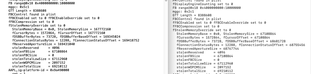

Turns out my big-little data was swapped (duh). When I rightly set 00009A49 with correct endianness, the IGFB log started up but the display didn't. Same result as when not setting any platform-id (ie: using my native device 46A6)
IMG_9483.HEIC
Can I dump all my logs from previous-to-last boot (cant find them in dmesg).
this is our cards. yours seems to have more mem allocated (left)
this are the types for ig-platform that i can't create as structure yet
don't try to set other ig-platform nblue does the only that works with tgl 0x9a49. if you set another value it will accept and ofc will break the code
jkbuha if you don't get a hang try get logs using hacintol or in terminal with
log show --style syslog --predicate 'processID == 0' --last 1h --info --debug  > x.log
you will get a x.log file in your home folder
Edited by jalavoui
My DVMT Pre-Allocated Memory is 160MB, the usual is 64MB,
I set it to 160MB  in using ru.efi to avoid the stolenmem size error we used to get on whatevergreen
Unfortunately all (but one) boots resulted in a hang. One managed a KP, which I've reproduced hereunder:
panic(cpu 0 caller 0xffffff7f99550d6e): "[IGFB][PANIC][POWER_WEL] " "PG2 power well hardware state update failed\n"@/Library/Caches/com.apple.xbs/Sources/GPUDriversIntel/GPUDriversIntel-16.0.32/IONDRV/TGL/AppleIntelFramebuffer/AppleIntelPowerWell.cpp:1252
Panicked task 0xffffffa27522cbf8: 170 threads: pid 0: kernel_task
Backtrace (CPU 0), panicked thread: 0xffffff9da8fce0c8, Frame : Return Address
0xffffffc91b1f7800 : 0xffffff8002670c7d mach_kernel : _handle_debugger_trap + 0x4ad
0xffffffc91b1f7850 : 0xffffff80027c5284 mach_kernel : _kdp_i386_trap + 0x114
0xffffffc91b1f7890 : 0xffffff80027b4d97 mach_kernel : _kernel_trap + 0x3b7
0xffffffc91b1f78e0 : 0xffffff8002611971 mach_kernel : _return_from_trap + 0xc1
0xffffffc91b1f7900 : 0xffffff8002670f5d mach_kernel : _DebuggerTrapWithState + 0x5d
0xffffffc91b1f79f0 : 0xffffff8002670607 mach_kernel : _panic_trap_to_debugger + 0x1a7
0xffffffc91b1f7a50 : 0xffffff8002ddb8db mach_kernel : _panic + 0x84
0xffffffc91b1f7b40 : 0xffffff7f99550d6e com.xxxxx.driver.AppleIntelTGLGraphicsFramebuffer : __ZN19AppleIntelPowerWell21hwSetPowerWellStatePGEbj.cold.11
0xffffffc91b1f7b50 : 0xffffff7f994eb18c com.xxxxx.driver.AppleIntelTGLGraphicsFramebuffer : __ZN19AppleIntelPowerWell21hwSetPowerWellStatePGEbj + 0x756
0xffffffc91b1f7bb0 : 0xffffff7f994ea6f9 com.xxxxx.driver.AppleIntelTGLGraphicsFramebuffer : __ZN19AppleIntelPowerWell18disablePowerWellPGEj + 0x2d1
0xffffffc91b1f7c10 : 0xffffff7f994e910e com.xxxxx.driver.AppleIntelTGLGraphicsFramebuffer : __ZN19AppleIntelPowerWell4initEP24AppleIntelBaseController + 0x1946
0xffffffc91b1f7c90 : 0xffffff7f994bcd38 com.xxxxx.driver.AppleIntelTGLGraphicsFramebuffer : __ZN24AppleIntelBaseController5startEP9IOService + 0x1498
0xffffffc91b1f7d40 : 0xffffff7f9953e921 com.xxxxx.driver.AppleIntelTGLGraphicsFramebuffer : __ZN31AppleIntelFramebufferController5startEP9IOService + 0xf9
0xffffffc91b1f7da0 : 0xffffff8002ce8531 mach_kernel : __ZN9IOService14startCandidateEPS_ + 0xd1
0xffffffc91b1f7e00 : 0xffffff8002ce80aa mach_kernel : __ZN9IOService15probeCandidatesEP12OSOrderedSet + 0xdba
0xffffffc91b1f7ec0 : 0xffffff8002ce715f mach_kernel : __ZN9IOService14doServiceMatchEj + 0x3af
0xffffffc91b1f7f20 : 0xffffff8002cea2ea mach_kernel : __ZN15_IOConfigThread4mainEPvi + 0x15a
0xffffffc91b1f7fa0 : 0xffffff800261119e mach_kernel : _call_continuation + 0x2e
      Kernel Extensions in backtrace:
         com.xxxxx.driver.AppleIntelTGLGraphicsFramebuffer(16.0)[B96A8448-9D17-3F78-B76D-15A0B359A9A0]@0xffffff7f99461000->0xffffff7f99598fff
            dependency: com.apple.AppleGraphicsDeviceControl(7.1.19)[87B91A0F-9829-39C3-8DBF-4581A2EE681A]@0xffffff7f97304000->0xffffff7f97307fff
            dependency: com.apple.iokit.IOACPIFamily(1.4)[D342E754-A422-3F44-BFFB-DEE93F6723BC]@0xffffff8004c46000->0xffffff8004c47fff
            dependency: com.apple.iokit.IOAcceleratorFamily2(475.40.6)[5CEA519D-44FC-30EB-8622-2394570EBDD4]@0xffffff7f98220000->0xffffff7f9828afff
            dependency: com.apple.iokit.IOGraphicsFamily(597)[718E01CF-8B05-3042-88F4-DE3441395D00]@0xffffff7f983c1000->0xffffff7f983effff
            dependency: com.apple.iokit.IOPCIFamily(2.9)[30827E78-B899-37B7-8518-8F983C0FF4B9]@0xffffff80050b6000->0xffffff80050e7fff
            dependency: com.apple.iokit.IOReportFamily(47)[491DDA55-D371-3A28-9A77-C28DB013D8AE]@0xffffff80050f8000->0xffffff80050fafff
            dependency: org.smichaud.HookCase(8.0.1)[6AA81954-616A-3343-B669-B23FF4C48DB5]@0xffffff7f99877000->0xffffff7f9988cfff
Process name corresponding to current thread (0xffffff9da8fce0c8): kernel_task
Boot args: -v keepsyms=1 -ctrsmt debug=0x100 -wegswitchgpu hbfx-ahbm=1 -wegdbg -nbluedbg agdpmod=pikera IGLogLevel=8
Mac OS version:
22G830
Kernel version:
Darwin Kernel Version 22.6.0: Mon Jun 24 01:25:37 PDT 2024; root:xnu-8796.141.3.706.2~1/RELEASE_X86_64
Kernel UUID: D78DC15F-6FB9-31D0-9B0F-C3285187A7FD
roots installed: 0
KernelCache slide: 0x0000000002200000
KernelCache base:  0xffffff8002400000
Kernel slide:      0x00000000022dc000
Kernel text base:  0xffffff80024dc000
__HIB  text base: 0xffffff8002300000
System model name: MacBookAir9,1 (Mac-0CFF9C7C2B63DF8D)
System shutdown begun: NO
Panic diags file available: YES (0x0)
Hibernation exit count: 0
System uptime in nanoseconds: 36991584666
Last Sleep:           absolute           base_tsc          base_nano
  Uptime  : 0x000000089f703a8f
  Sleep   : 0x0000000000000000 0x0000000000000000 0x0000000000000000
  Wake    : 0x0000000000000000 0x00000011a76f872d 0x0000000000000000
Compressor Info: 0% of compressed pages limit (OK) and 0% of segments limit (OK) with 0 swapfiles and OK swap space
Zone info:
  Zone map: 0xffffff88d9f56000 - 0xffffffa8d9f56000
  . PGZ   : 0xffffff88d9f56000 - 0xffffff88e1f57000
  . VM    : 0xffffff88e1f57000 - 0xffffff8dad8f0000
  . RO    : 0xffffff8dad8f0000 - 0xffffff8f46c23000
  . GEN0  : 0xffffff8f46c23000 - 0xffffff94125bc000
  . GEN1  : 0xffffff94125bc000 - 0xffffff98ddf55000
  . GEN2  : 0xffffff98ddf55000 - 0xffffff9da98ee000
  . GEN3  : 0xffffff9da98ee000 - 0xffffffa275288000
  . DATA  : 0xffffffa275288000 - 0xffffffa8d9f56000
  Metadata: 0xffffff80b9aa4000 - 0xffffff80d9aa4000
  Bitmaps : 0xffffff80d9aa4000 - 0xffffff80e5aa4000
  Extra   : 0 - 0
