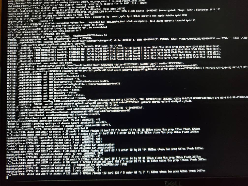

I put both the hook and tglframebuffer kext in Library/Extensions, did chown on them after doing 755, also disabled spctl master and put amfi out of my way in nvram.
After that I put the nblue kext on my USB with an exact copy of my working nblue based EFI.
Doesn't boot fully, see the attached image. I'll pull logs in around 2 hrs or so.
Am I doing the testing procedure correctly?

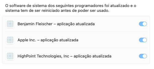

if you get the sys prefs warning to allow permissions for kext to load them all good

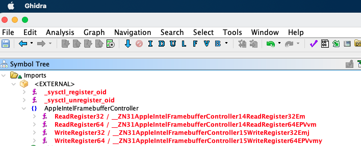

As I analyze in ghidra, S/L/E FB kext doesn't have some functions, and some are what you mentioned as missing.
I've got to browse more to clarify the missing functions.

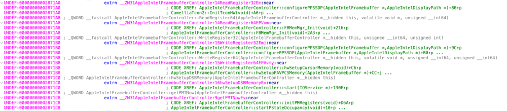

// In AppleInternal FB kext, these are defined as external functions
// In S/L/E FB kext, not even mentioned anywhere
0x4020__ZN24AppleIntelBaseController15WriteRegister32Emj
0x4030__ZN24AppleIntelBaseController15WriteRegister64EPVvmy
0x4040__ZN24AppleIntelBaseController14ReadRegister32Em
0x4050__ZN24AppleIntelBaseController14ReadRegister64EPVvm
0x4060__ZN24AppleIntelBaseController9getPMTNowEv
0x4070__ZN24AppleIntelBaseController16hwSetupDSBMemoryEv
// Not existent in both AppleInternal FB kext and S/L/E FB kext
0x4080__ZN17AppleIntelPortHAL13probePortModeEv
0xc728__ZN21AppleIntelDisplayPath19DSBEngineBusyStatusE
The ones in AppleInternal are diagnostic builds, so they're only meant to be used to find issues.
(The reason I sent him those and not the ones from /S/L/E is because I did not notice there was even TGL kexts in here in the first place, I was primarily sending them for the AMD debug kexts)

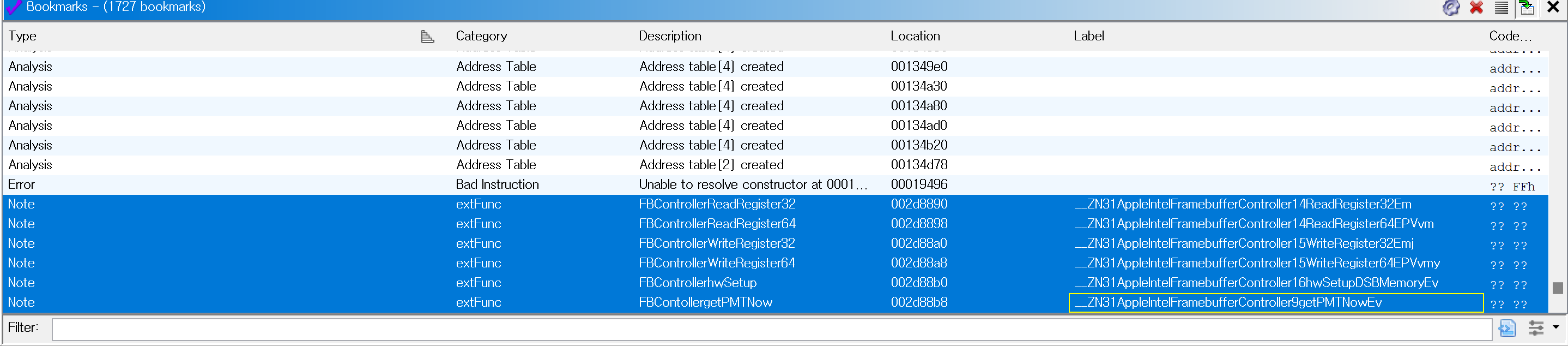

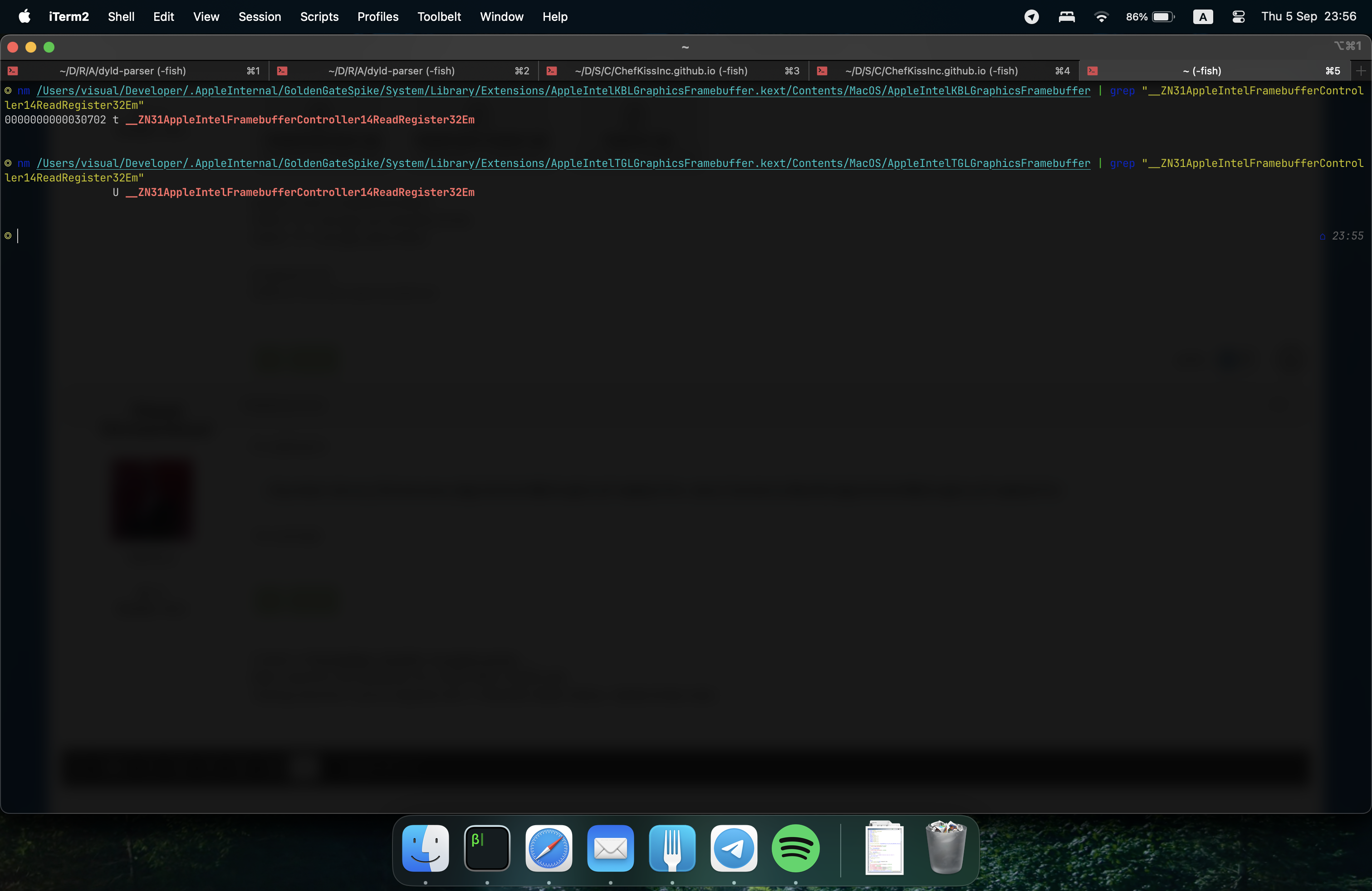

Yeah, all the external function symbols on your screenshot are present inside FB kext binary.
In S/L/E FB, there are no AppleIntelBaseController things, but there are AppleFramebufferController ones.
Now it's time for finding nemo.
Edited by Kim Chito
  • Thanks 1

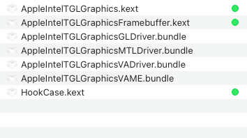

anyway here's the "loading" version of both kexts usig hookcase
graphics kext complained about

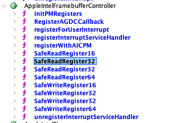

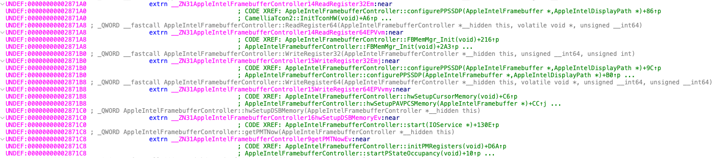

Visual you're right they exist in older intel framebuffer kexts.
i was about to ask about guessing the new offsets for tgl framebuffer.

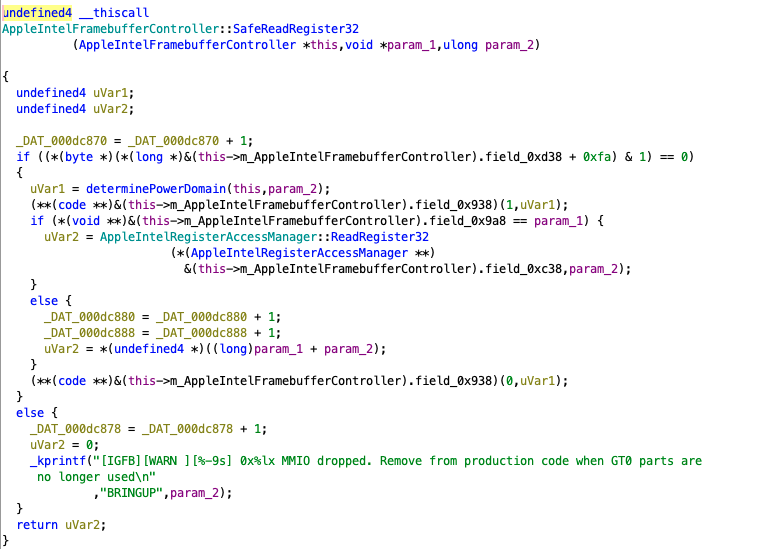

anyway the tgl from S/L/E removed the internal links and it is now
their usage in code is strange. see this code (so i opt for use ml_io_read_ptr() in hookcase)
and the existing functions are
so this call show that
and we get the tgl offsets

anyway best way togo is check icl code and there exist the function (they use a extra parameter *this on same functions found in tgl)
undefined4 __thiscall
AppleIntelFramebufferController::ReadRegister32(AppleIntelFramebufferController *this,ulong param_1)
ulong __thiscall
AppleIntelRegisterAccessManager::ReadRegister32
          (AppleIntelRegisterAccessManager *this,void *param_1,ulong param_2)
  ulong uVar1;
  uint uVar2;
  _DAT_000e2400 = _DAT_000e2400 + 1;
  if (*(void **)&(this->m_AppleIntelRegisterAccessManager).field_0x48 != param_1) {
    if (param_2 < *(int *)&(this->m_AppleIntelRegisterAccessManager).field_0x58 - 4) {
      _DAT_000e2428 = _DAT_000e2428 + 1;
      uVar2 = *(uint *)((long)param_1 + param_2);
    else {
      _DAT_000e2410 = _DAT_000e2410 + 1;
      uVar2 = 0;
      _kprintf("[IGFB][ERROR][%-9s] Invalid Gfx register access. Offset tried = 0x%lx. Returning 0 w ithout accessing register.\n"
               ,"DISPLAY");
    return (ulong)uVar2;
  _DAT_000e2408 = _DAT_000e2408 + 1;
  uVar1 = ReadRegister32(this,param_2);
  return uVar1;
so tgl offsets are field_0x48 and field_0x58
but in hookcase.kext due to c++ mangling i have
extern "C"  unsigned int AppleIntelBaseController::ReadRegister32(unsigned long a)
    if (ml_io_read_ptr)
    return ml_io_read_ptr(a,4);
    return 0;
  //  if (ReadRegister32_ptr)
      //  return ReadRegister32_ptr(a);
    //return callback->readReg32(a);;
which ofc doesnt allow todo this validation
i'm not worried with this as it seems just mmio reading but this is importante for >11 family displays
update:
thinking about this and looking at the register readings in tgl framebuffer the kernel ml_io_read_ptr() is what seems more reasonable to work. still i'm almost sure it doesnt.
  long *plVar1;
  undefined4 uVar2;
  _DAT_000ff878 = _DAT_000ff878 + 1;
  if ((*(byte *)(*(long *)&(this->m_AppleIntelFramebufferController).field_0xcf0 + 0xb2) & 1) != 0)
    _DAT_000ff888 = _DAT_000ff888 + 1;
    if (0x1fff < param_1) {
      _DAT_000ff898 = _DAT_000ff898 + 1;
      if (param_1 < 0x40000) {
        plVar1 = &DAT_000ff8a0;
      else {
        _DAT_000ff890 = _DAT_000ff890 + 1;
        if ((param_1 < 0x1c0000) || (_DAT_000ff8a8 = _DAT_000ff8a8 + 1, 0x23ffff < param_1))
        goto LAB_00047cd6;
        plVar1 = &DAT_000ff8b0;
      *plVar1 = *plVar1 + 1;
      _DAT_000ff880 = _DAT_000ff880 + 1;
      func_0xffffffffeb5b911a("[IGFB][WARN ][%-10s] 0x%lx MMIO dropped for 2D only part\n","MMIO");
      return 0;
LAB_00047cd6:
  if (param_1 < *(int *)&(this->m_AppleIntelFramebufferController).field_0xc30 - 4) {
    _DAT_000ff870 = _DAT_000ff870 + 1;
    uVar2 = *(undefined4 *)
             (*(long *)&(this->m_AppleIntelFramebufferController).field_0x9b0 + param_1);
  else {
    _DAT_000ff8b8 = _DAT_000ff8b8 + 1;
    uVar2 = 0;
              ("[IGFB][ERROR][%-10s] Invalid register access at offset = %x. Returning without regis ter access\n"
               ,"MMIO");
  return uVar2;
todo this kind of validation i need to guess the tgl offsets and maybe find a way to port this to hookcase.kext
as for non devs guys maybe test the stuff we post and try provide logs
i believe alder lake gpus might work with the new tgl framebuffer
and maye tgl gpus that work with icl framebuffer can load AppleIntelTGLGraphics.kexy

AppleIntelTGLGraphics.kext is loading i'll update files asp - no working aceleration !
dont need any special boot flags. but for graphic loading use boot arg -allow3d
atm i'm delaying AppleIntelTGLGraphicsFramebuffer and focus on icl framebuffer
inside NBlue you can edit this info.plist - default is ICL frame + TGL graphics
use nblue or manual edit info.plist files from sle.zip with your gpu id and put in /L/E
also including the internal tgl frame - it as lot of debug messages and settings
this is source code - do not touch it
when all will work ? i have no idea
dont forget boot arg if testing graphics

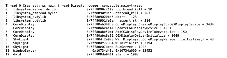

this is windowserver hang (maybe no bundles loading?)
and the graphic log
all this is by using nblue - without it idk what you will get depending on hardware and info.plist edits, etc

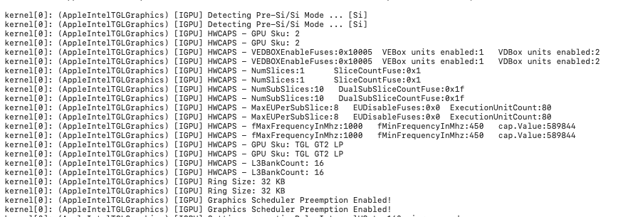

i'm kinda happy to see scheduler 5 not crashing - it was about time !
the others (3 and 4) that load bios files dont work for me
tgl as some limitations on device-id injection (try patch with nblue? or just hack the binary files and put in /L/E)
i can see lots of possibilities with this findings and i hope others come forward with new patches
Edited by jalavoui

i found that in non internal tgl framebuffer kext 2 symbols are not needed
extrn __ZN21AppleIntelDisplayPath19DSBEngineBusyStatusE altough external no link errors
AppleIntelPortHAL::probePortMode not used
so i'm rewriting hookcase for only this
class AppleIntelFramebufferController {
    friend class HookCase;
    static void WriteRegister32(unsigned long a, unsigned int b);
    static void WriteRegister64(void volatile* a, unsigned long b, unsigned long long c);
    static unsigned int ReadRegister32(unsigned long a);
    static unsigned long long ReadRegister64(void volatile* a, unsigned long b);
    static uint64_t getPMTNow();
    static bool hwSetupDSBMemory();
altough i enjoy apple internal tgl frame i do not need missing symbols
updated the kexts to include internal and in internal version of tgl frame
whats the diff ?
well internal tgl frame as this and other settings
  bVar1 = _PE_parse_boot_argn("IGLogLevel",&local_2c,4);
  if (bVar1 != 0) {
    _DAT_0016c1d8 = _DAT_0016c1d8 + 1;
    DAT_001c2be0 = (ulong)local_2c;
  bVar1 = _PE_parse_boot_argn("ForceCompleteModeset",(void *)0x0,0);
  if (bVar1 != 0) {
    _DAT_0016c1e0 = _DAT_0016c1e0 + 1;
    DAT_001c2ba0 = 1;
any of this kexts can now be patched and put in /L/E
happy hacking

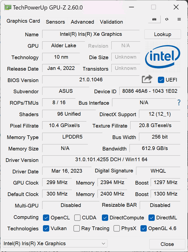

Will TGL kexts work also on Alderlake?
My main PC is Alderlake Zenbook UX3402ZA(i5-1240p).
Its architecture is Iris Xe.
Edited by Kim Chito
  • Thanks 1
Use GPU-Z on windows to figure out whats your Intel GPU id and model, and edit your post and put it there instead of creating a new post.
Verify you are using "XE" Architecture based on the following list. --> https://dgpu-docs.intel.com/devices/hardware-table.html
XE-HPG, Xe-HPC & Xe-LPG and others will definitely never have a chance as those are Intel ARC etc
Edited by Mastachief
