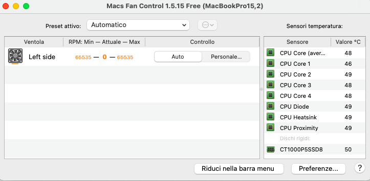

my hackintosh laptop is perfect; the only things that doesn't work is the fan sensor.
I installed all the required kexts and following this guide I added on my config:
                <key>PciRoot(0x0)/Pci(0x1F,0x0)</key>

My EC RAM details (dumped from DSDT.aml):

Now, apps like iStat, HWMonitorSMC2, TG Pro and Mac Fan Control can see the sensor, but there are some issue.
The value seems not to be in real time and I can't control the fan speed manually.
For example, with Mac Fan Control min and max value as the same:
Maybe I did some error in my config.
Could you help me please to make a good settings?
