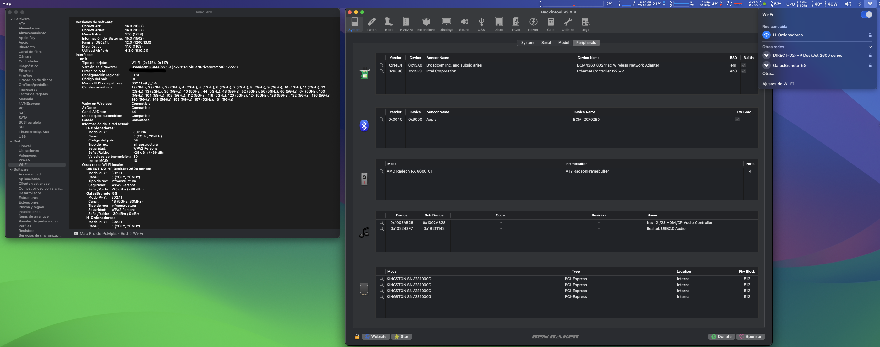

miliuco Posted July 24, 2023 Share Posted July 24, 2023 (edited) Good morning. I know that it is not the ideal situation that many of us want to have the system as vanilla as possible, but what the OCLP team has achieved is amazing. My wifi is Fenvi T919. I have followed TO THE LETTER the instructions that have been published here (Hackintosh notes):https://github.com/dortania/OpenCore-Legacy-Patcher/pull/1077#issuecomment-1646934494 And it has worked well. I have wifi and Airdrop back in Sonoma. Note that khronokernel's instructions must be followed exactly. Don't forget to enable (Enabled=True) 3 extensions to be added and the extension to be blocked, they are disabled by default. If I don't block com.apple.iokit.IOSkywalkFamily the system won't boot with KP. I'm attaching my config.plist in case it helps anyone having trouble, check out these specific details: csr-active-config | data | 03080000 boot-args | string | amphi=0x80 amfi=0x80 com.apple.iokit.IOSkywalkFamily blocked IOSkywalk.kext, IO80211FamilyLegacy.kext and AirPortBrcmNIC.kext added in this order (Kexts folder and config.plist). For the future I hope the integration of the amfi-disabled branch with the sonoma-development branch to be able to work without the need to disable AMFI. I guess incremental updates are lost with this setup. But the OCLP approach works, at least for me. Note: as it's a preliminary fix, maybe it doesn't work on some systems. Spoiler Important: com.apple.iokit.IOSkywalkFamily blocking must have Enabled=True and Strategy=Exclude. Otherwise you get kernel panic at boot. Spoiler Thank you, OCLP team!!! config.plist Edited October 4, 2023 by miliuco Fixed typo amphi / amfi 4 1 Link to comment Share on other sites More sharing options...

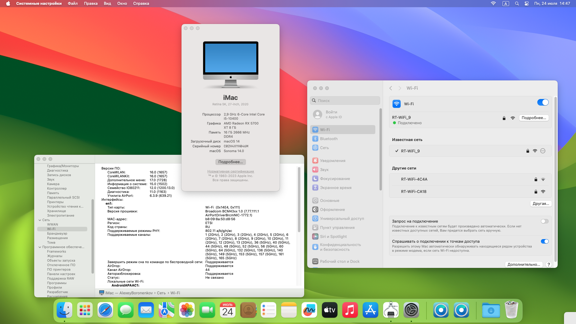

Alexey Boronenkov Posted July 24, 2023 Share Posted July 24, 2023 FENVI FV-HB 1200 / OPENCORE LEGACY PATCHER 0.6.8 MASTER https://github.com/dortania/OpenCore-Legacy-Patcher/tree/sonoma-development 3 Link to comment Share on other sites More sharing options...

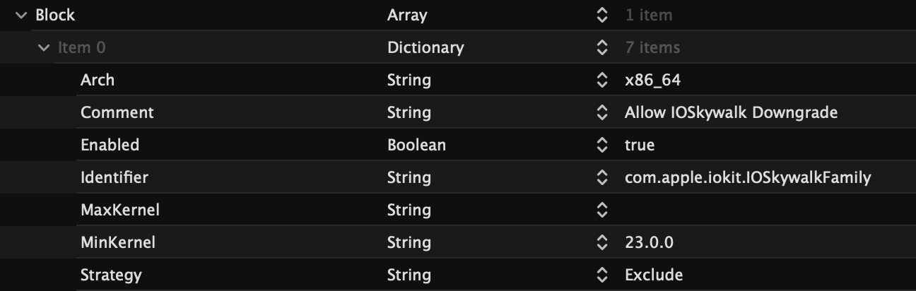

Cyberdevs Posted July 24, 2023 Share Posted July 24, 2023 1 hour ago, miliuco said: com.apple.iokit.IOSkywalkFamily blocked This must be set to Exclude otherwise it will end up in Kernel Panic. 2 Link to comment Share on other sites More sharing options...

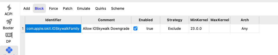

HyperX7 Posted July 24, 2023 Share Posted July 24, 2023 6 minutes ago, eSaF said: I don't know what I am doing wrong but so far I'm not getting the success with my Fenvi and OCLP like you guys. Trying on a clean Sonoma install I either get a panic or boot to a few moments of searching for wifi then the Icon blanks out. I've posted my EFI Folder here so that someone can perhaps spot my error/errors. Thanks. efi.zip 23.3 MB · 0 downloads I think you don't block the com.apple.iokit.IOSkywalkFamily kext. 3 1 Link to comment Share on other sites More sharing options...
miliuco Posted July 24, 2023 Share Posted July 24, 2023 (edited) @eSaF You're missing com.apple.iokit.IOSkywalkFamily blocking, as @HyperX7 says. Block it, restart and apply root patch. 1 hour ago, Cyberdevs said: This must be set to Exclude otherwise it will end up in Kernel Panic. My mistake was Enabled=False for the first boot. After enabling it, all is fine. Edited July 24, 2023 by miliuco 3 1 Link to comment Share on other sites More sharing options...
Cyberdevs Posted July 24, 2023 Share Posted July 24, 2023 58 minutes ago, miliuco said: @eSaF You're missing com.apple.iokit.IOSkywalkFamily blocking, as @HyperX7 says. Block it, restart and apply root patch. My mistake was Enabled=False for the first boot. After enabling it, all is fine. Yeah that’s a little but a crucial part of the process which can be overlooked easily that’s why i mentioned it so you could add it to your post to avoid confusion 😉 2 1 Link to comment Share on other sites More sharing options...
miliuco Posted July 24, 2023 Share Posted July 24, 2023 14 minutes ago, Cyberdevs said: Yeah that’s a little but a crucial part of the process which can be overlooked easily that’s why i mentioned it so you could add it to your post to avoid confusion 😉 Done! 2 Link to comment Share on other sites More sharing options...
eSaF Posted July 24, 2023 Share Posted July 24, 2023 10 minutes ago, Cyberdevs said: Yeah that’s a little but a crucial part of the process which can be overlooked easily that’s why i mentioned it so you could add it to your post to avoid confusion 😉 You Guys Rock!!! That is what I was missing. Here is another query for yah, why am I missing such small details that make me chase my tail for hours trying to figure out what's wrong, could it be my advancing age? I am so dreading the coming changes if this is the state I am going to be in each time. 3 5 Link to comment Share on other sites More sharing options...

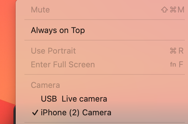

fabiosun Posted July 24, 2023 Share Posted July 24, 2023 continuity cam and airdrop work for you? Some problems here 1 Link to comment Share on other sites More sharing options...
Max.1974 Posted July 24, 2023 Share Posted July 24, 2023 (edited) 38 minutes ago, mariosun said: continuity cam and airdrop work for you? Some problems here If we can help, you can tell us what's going on. How Broadcom model are you using? 1 hour ago, eSaF said: You Guys Rock!!! That is what I was missing. Here is another query for yah, why am I missing such small details that make me chase my tail for hours trying to figure out what's wrong, could it be my advancing age? I am so dreading the coming changes if this is the state I am going to be in each time. Congrats young boy, its not your age!! Its all news to us with this OCLP Edited July 24, 2023 by Max.1974 2 1 Link to comment Share on other sites More sharing options...

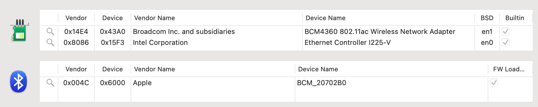

fabiosun Posted July 24, 2023 Share Posted July 24, 2023 (edited) 19 minutes ago, Max.1974 said: If we can help, you can tell us what's going on. How Broadcom model are you using? thanks this one and in Ventura all features work fine Edited July 24, 2023 by mariosun 1 Link to comment Share on other sites More sharing options...
