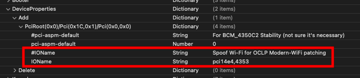

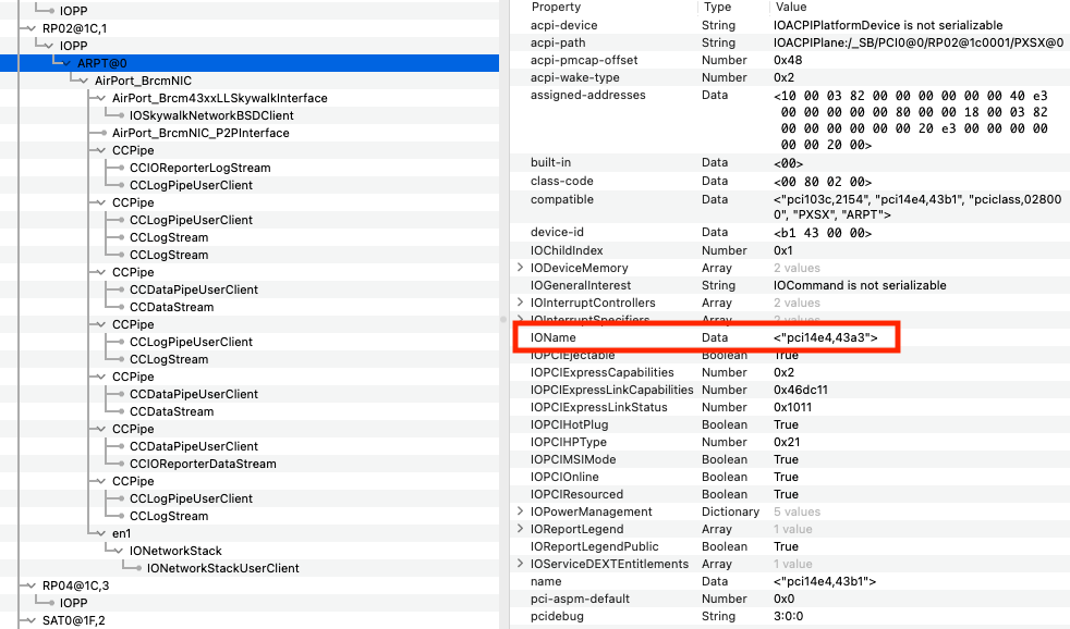

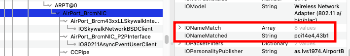

deeveedee Posted August 4, 2023 Share Posted August 4, 2023 (edited) Looking for volunteer with BCM 94352HMB and Open Core ACPI patching experience to test a Sonoma Wi-Fi solution with me. Please PM me if you feel that you are interested and qualified... I have discovered what I think is something significant for BCM 94352HMB Wi-Fi users: We can patch ACPI in a way that allows OCLP to detect and patch Sonoma Wi-Fi without requiring any custom code development and without requiring any switching between config.plists for patching and running. I have found that on my HackBookPro6,2 (SMBIOS MBP6,2) with BCM 94352HMB, I can permanently apply the attached ACPI patch (changing only the IOName value) without renaming PXSX->ARPT and without any other changes, ACPI or otherwise. With this simple change, the official Dortania build of OCLP 0.6.9 (no custom coding / building required) discovers and patches Sonoma Wi-Fi for BCM 94352HMB AND Wi-Fi works fine in Ventura and Sonoma. This simple ACPI patch does not affect operation of Wi-Fi, so the simple ACPI patch can remain for patching and running macOS - it never needs to be removed. If someone wants to test this with me, I would be happy to help you via PM. You must have ACPI patching experience, so that we don't have to spend any time teaching you how to patch ACPI. After we confirm that it is working as expected, I would post instructions for general use. If you want to test this on your own (not working with me via PM), that would be great, too. I am currently running with the attached ACPI patch. With this simple patch, Wi-Fi works perfectly during normal operation in Ventura and Sonoma and OCLP 0.6.9 discovers and patches BCM 94352 Wi-Fi for Sonoma without an OCLP code changes. EDIT: This patch can also be implemented with OC DeviceProperties as shown here and here. You can use OC DeviceProperties or the SSDT patch, whichever you prefer. EDIT2: I am now running with the OC DeviceProperty and it is working fine. I started with the SSDT, because I have found that sometimes, OC DeviceProperties cannot overwrite existing properties. In this case, the DeviceProperty is working and for most, will be much easier to implement. SSDT-ARPT.aml.zip Edited August 5, 2023 by deeveedee 7 Link to comment Share on other sites More sharing options...
deeveedee Posted August 4, 2023 Share Posted August 4, 2023 (edited) I don't want to bother Dortania OCLP developers by asking any of them to confirm my finding here (that we only need to patch IOName in order to trick OCLP into patching our unsupported Wi-Fi). If someone has an inside connection that allows them to ask an OCLP developer to confirm this finding, that would be very helpful. Thank you. EDIT: I grepped OCLP Source and see that IONameMatch is a common way for OCLP patcher to identify properties, so this ACPI patching techique for spoofing Wi-Fi might be correct. Edited August 4, 2023 by deeveedee 1 1 Link to comment Share on other sites More sharing options...

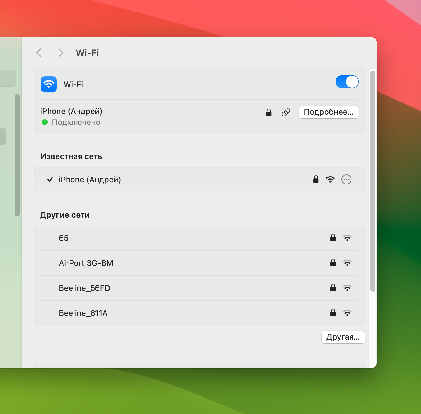

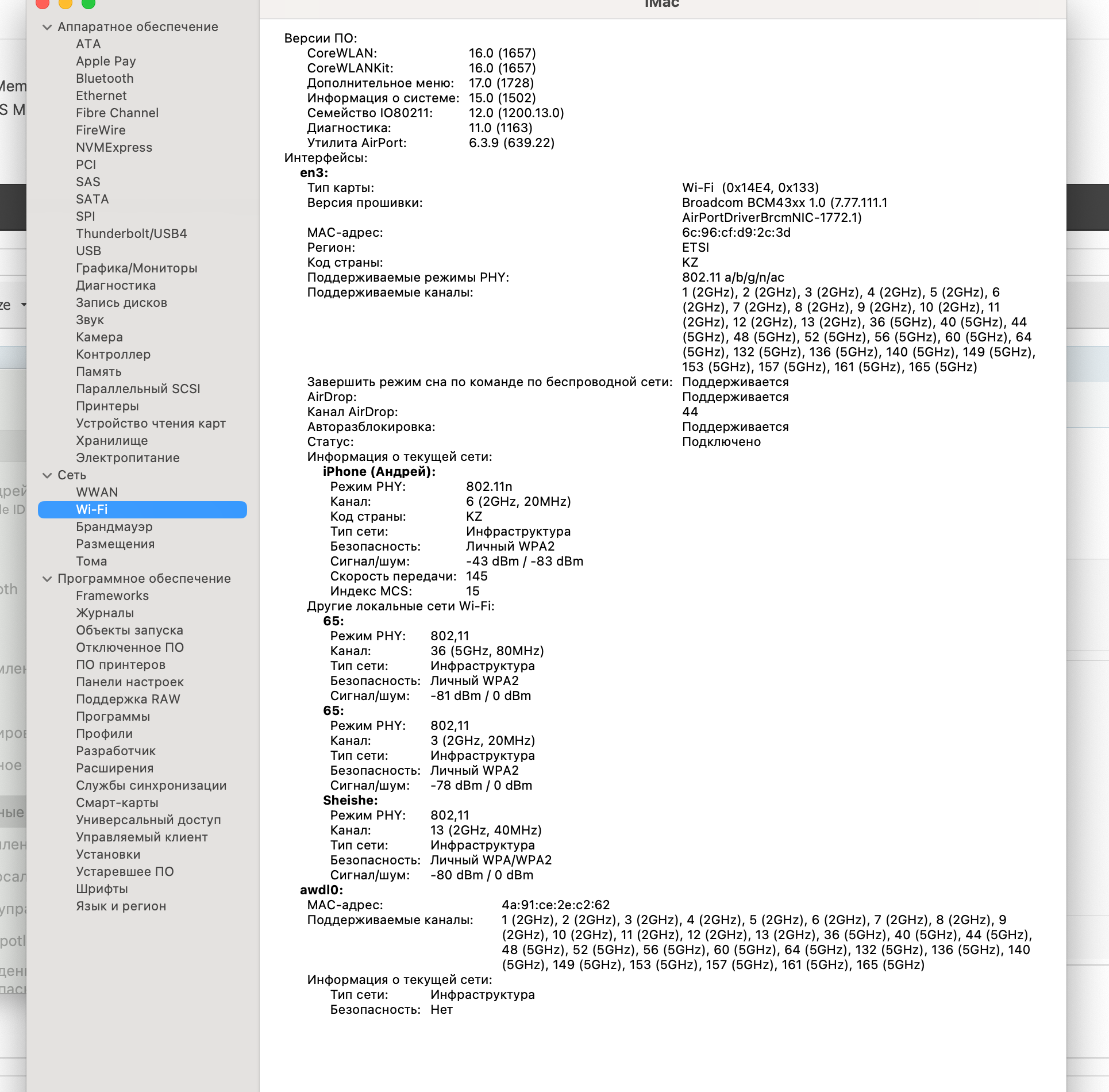

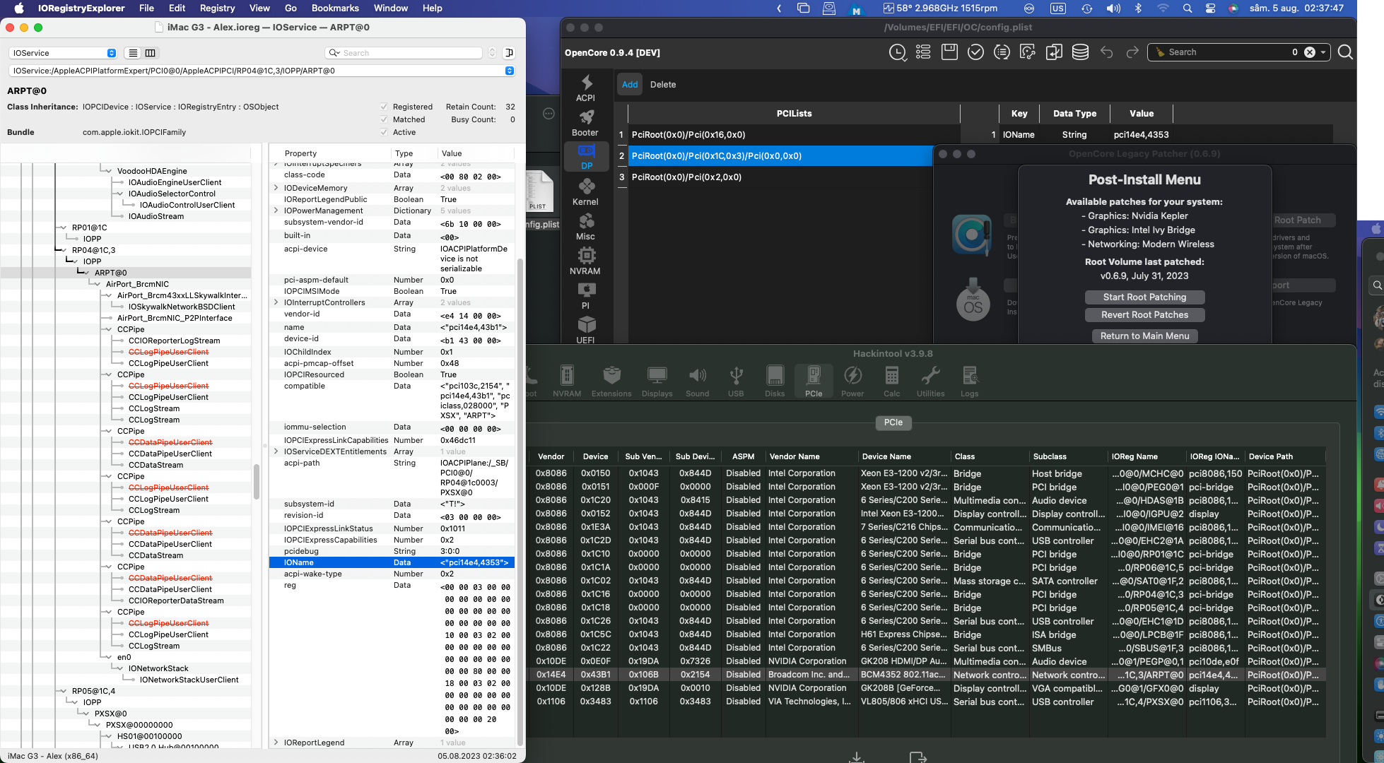

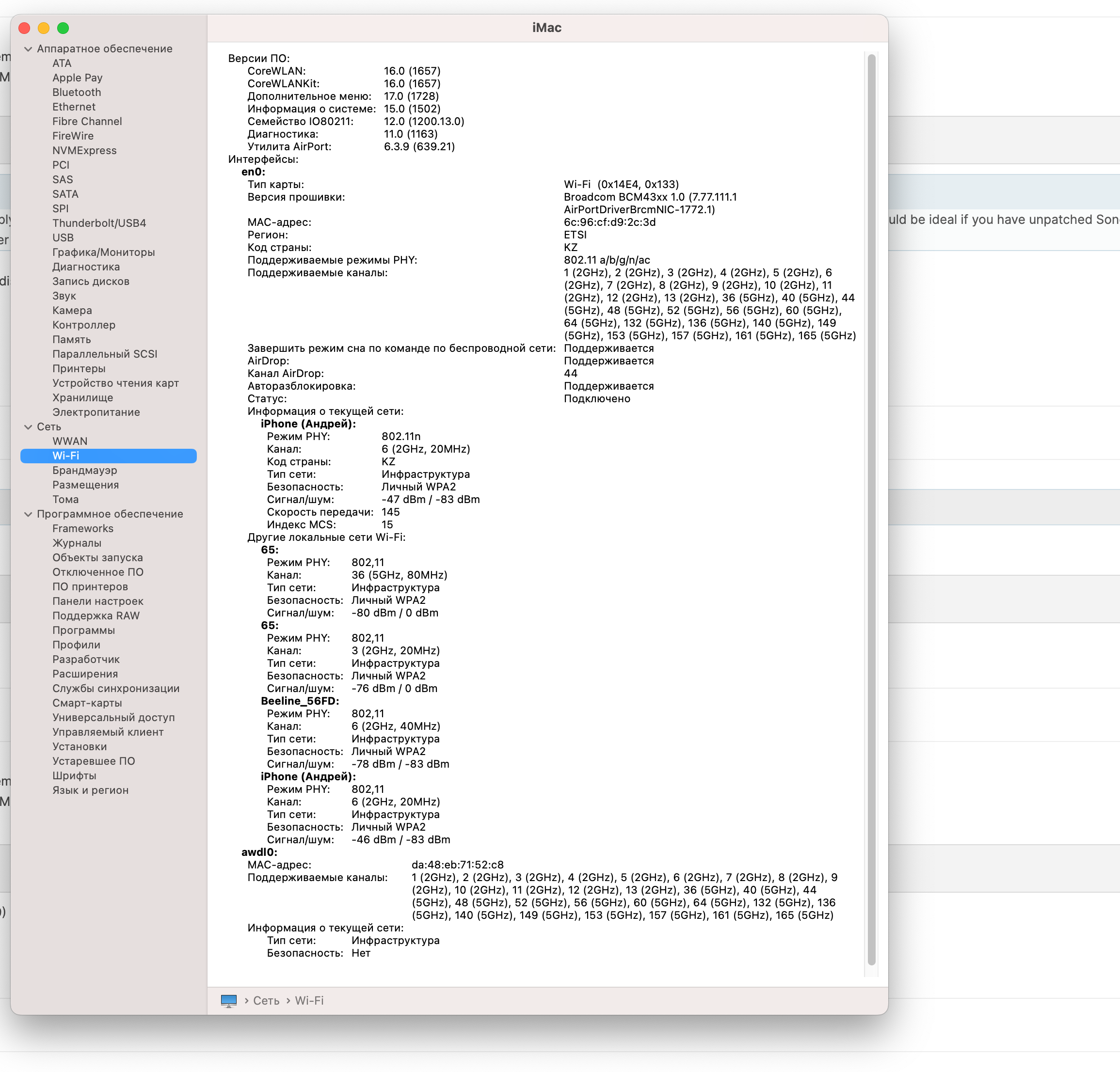

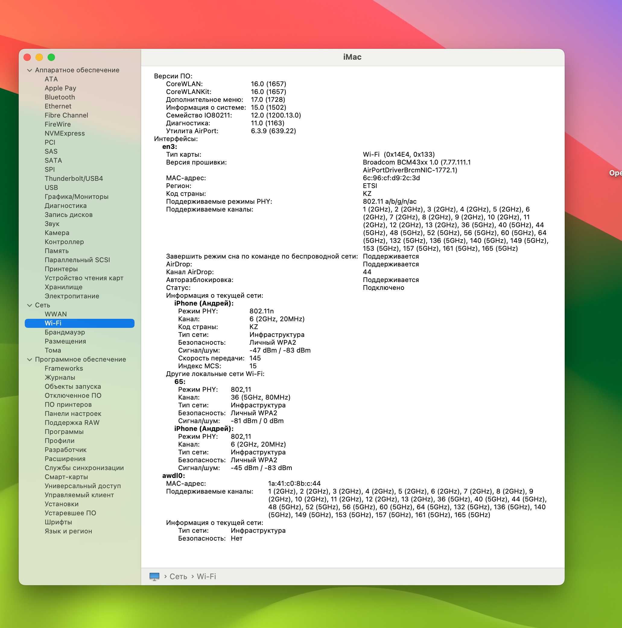

Stefanalmare Posted August 4, 2023 Share Posted August 4, 2023 (edited) Congrats @deeveedee! It just work. But I don't use SSDT, for me is simpler using device properties in config.plist. Spoiler Edited August 4, 2023 by Stefanalmare 1 1 Link to comment Share on other sites More sharing options...

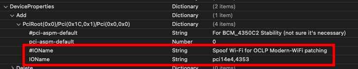

deeveedee Posted August 4, 2023 Share Posted August 4, 2023 (edited) 2 hours ago, Stefanalmare said: Congrats @deeveedee! It just work. But I don't use SSDT, for me is simpler using device properties in config.plist. You beat me to the post! I was just about to post my working solution with OC Device Property. Thank you for confirming! DeviceProperties Spoiler EDIT: I am multi-booting BigSur, Monterey, Ventura and Sonoma to make sure that this ACPI patch does not interfere with normal Wi-Fi operation. This is important, so that the patch can be applied permanently (we won't have to use the ACPI patch for OCLP post-install patches and then remove the patch for normal operation). I think I see why this patch is ok for normal operation. MacOS must use another Wi-Fi property (not IOName) to perform IOName matching: IOReg: IONameMatch (macOS Monterey) Spoiler Even though my ACPI patch is changing Wi-Fi IOName to pci14e4,4353, Airport_BrcmNIC matches the actual device name of the Wi-Fi card (pci14e4,43b1 in my case). This was either a brilliant move by the OCLP Devs or just lucky for us. EDIT2: If someone is able to test this patch when booting Windows with OC, that would be helpful. An advantage of using SSDT over DeviceProperties is that the SSDT patch can be conditional on 'Darwin' Edited August 5, 2023 by deeveedee 2 Link to comment Share on other sites More sharing options...

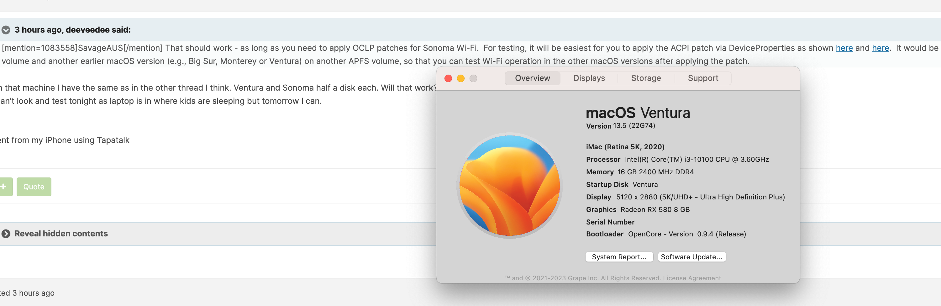

SavageAUS Posted August 5, 2023 Author Share Posted August 5, 2023 I think I have a bcm4352 in my Metabox laptop, don’t think it’s hmb though. Will this help?Sent from my iPhone using Tapatalk 1 Link to comment Share on other sites More sharing options...
deeveedee Posted August 5, 2023 Share Posted August 5, 2023 (edited) @SavageAUS That should work - as long as you need to apply OCLP patches for Sonoma Wi-Fi. For testing, it will be easiest for you to apply the ACPI patch via DeviceProperties as shown here and here. It would be ideal if you have unpatched Sonoma on one APFS volume and another earlier macOS version (e.g., Big Sur, Monterey or Ventura) on another APFS volume, so that you can test Wi-Fi operation in the other macOS versions after applying the patch. Test as follows: Modify your EFI so that your config.plist includes the Wi-Fi DeviceProperty to spoof IOName. See instructions for creating DeviceProperty below. Boot from your modified EFI and perform a clean installation of Sonoma (if you already have a clean installation of Sonoma without OCLP patches, that's fine, too) Apply OCLP 0.6.9 post-install patches to your virgin Sonoma installation (use the official Dortania OCLP 0.6.9 nightly build from here) Reboot and test Sonoma Wi-Fi Reboot and test Wi-Fi in an earlier version of macOS (to confirm that the Wi-Fi IOName spoofing does not alter Wi-Fi behavior) You can insert the DeviceProperty into your OC config.plist using your favorite plist editor (I use Xcode shown here) or OCAT like Stefanalmare here. EDIT: If anyone is able to test this Wi-Fi IOName spoofing when booting Windows with OC EFI, I'd like to know if the patch is compatible with Windows. If the ACPI patch interferes with Windows Wi-Fi, I have attached an SSDT that conditionally spoofs Wi-Fi only when running macOS. I think the attached SSDT is the correct way to conditionally apply the patch in Method _DSM. Your SSDT device path may be different from mine (_SB_.PCI0.RP02.PXSX), so you may need to edit the SSDT to work in your hack. EDIT2: The DeviceProperty patch requires proper specification of the Wi-Fi device path. There are multiple ways to obtain this device path. I use Hackintool as follows: Open Hackintool Click the PCIe tab Find your Wi-Fi device (Device Name "BCM 4352...") Right-click on the Wi-Fi device listing and select "Copy Device Path" (my device path is PciRoot(0x0)/Pci(0x1C,0x1)/Pci(0x0,0x0)) Use this Device Path you copied in Hackintool to create your DeviceProperty in your OC config.plist. My DeviceProperties (viewed/edited with Xcode are as shown here: Spoiler Note that a DeviceProperty preceded by # is a comment SSDT-ARPT.aml.zip Edited August 5, 2023 by deeveedee 4 Link to comment Share on other sites More sharing options...
