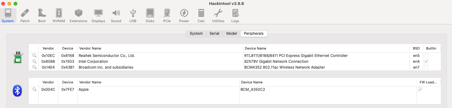

Because even enable SSDT-ARPT all current OCLP can not enable patch of Modern Wireless.
At present I must insert BCM4360 adapter to patch Sonoma.

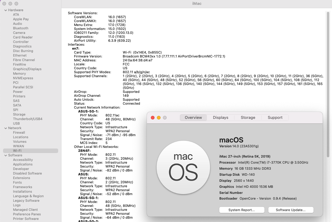

After successful patching shutdown and replaced by BCM4352 adapter.
Reboot my WiFi working now.

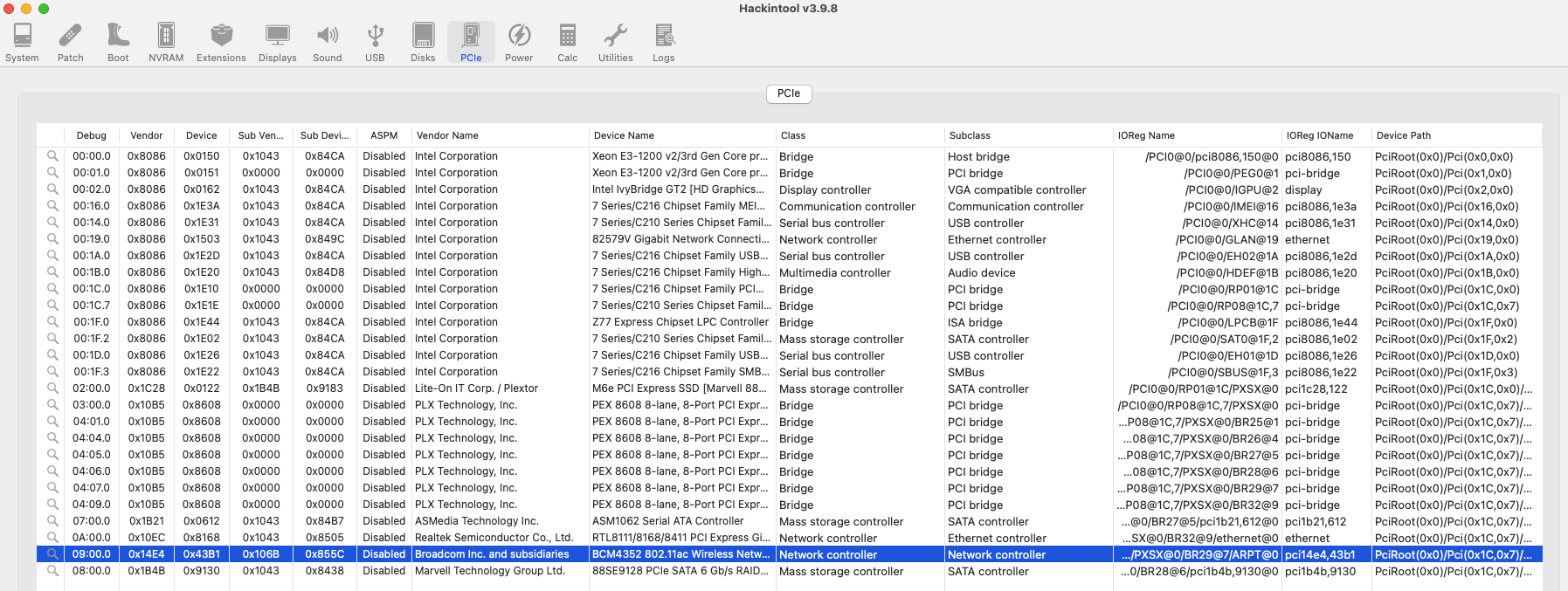

Thanks and my config.plist & SSDT-ARPT.aml as well as Hackintool's PCIe are posted here:
config.plist SSDT-ARPT.aml

Your ARPT ACPI path is different from mine, so you can't use my ACPI patches without modifying them.
Are you able to post your unpatched DSDT?

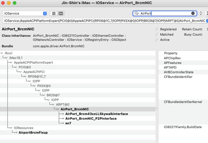

@jsl2000 I am going to use your posted info as an example, so that others can do this for themselves.  I am reluctant to build and post an OCLP with my changes and I don't think anyone else should be posting versions of OCLP.  There's enough confusion about this (just my opinion) without introducing another patcher into the community.  OCLP is very easy to build by following the instructions here.  Attached is the sys_patch_detect.py file with forced legacy-wifi to True and self.unsupported_os = False.
Can you post one more thing for me?  Can you disable AirportBrcmFixup.kext in your config.plist, reboot and post the IOReg IOName (full ACPI path) for your Wi-Fi?  I'd like to be certain of the original unpatched path before I post my suggested ACPI patches.
If you don't want to disable AirportBrcmFixup.kext and reboot, please post the ACPI path reported by IOReg Explorer as I have explained here.

Thanks again.
1264301056_Jin-ShinsiMac.ioreg

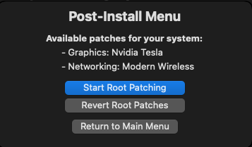

When I patch with my ACPI patching, OCLP patcher shows this (Networking: Modern Wireless):
Spoiler

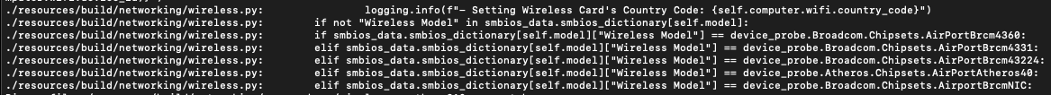

EDIT: I grepped the OCLP source for wireless and found this:
Spoiler
1426316857_Screenshot2023-08-01at10_22_56AM.thumb.png.bdbec9cd14a850497be57f6679fefe7c.png
Maybe some of the required mods for Wi-Fi patching are in wireless.py

@jsl2000 Your IOReg dump appears to show that your ARPT device is named ARPT (not PXSX), so it seems to me that you do not need to rename PXSX -> ARPT (and the PXSX->ARPT rename that you copied from me and inserted into your config.plist is not doing anything, because you do not have ARPT device at PCI0.RP02).
The IOService path of your ARPT device (reported by IOReg Explorer) is
The IOPath Base for your ARPT device (verified by examining your DSDT) is
\_SB.PCI0.RP08.PXSX.BR29
The full ACPI path of your ARPT device is
\_SB.PCI0.RP08.PXSX.BR29.ARPT
Therefore, your SSDT-ARPT needs to patch the device at full ACPI path \_SB.PCI0.RP08.PXSX.BR29.ARPT.
 See attached.
Replace your SSDT-ARPT in your EFI with the attached version, reboot and examine your IOReg to verify that the spoofing is applied.
SSDT-ARPT.aml.zip
Edited by deeveedee

hi. i tried following your last instruction, i still can't activate root patch.
- I used SSDT-ARPT to rename PXSX to ARPT and spoof device id. my bcm943602CDP wifi card has default id is pci14e4.43ba. Which id should I spoof? ( i tried spoof default id in ssdt but it doesn't work - pci14e4.43ba )
- I have enough kernel patch, enough kext, enough boot-args, reinstalled sonoma 4 times but I still can't activate root patch. Am I wrong anywhere?. can you help me check. Thank you
here is my EFI...
EFI.zip
