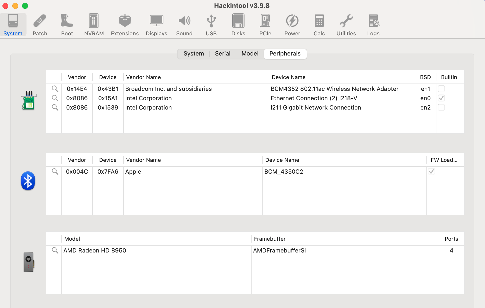

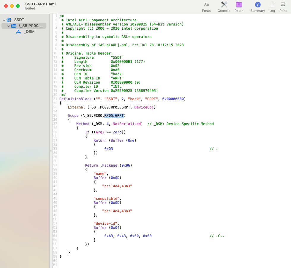

deeveedee Posted July 28, 2023 Share Posted July 28, 2023 (edited) I haven't yet succeeded in getting my BCM 94352 Wi-Fi to work with OCLP 0.6.9, but I wanted to report my findings in case this helps others. I have implemented a binary rename (PXSX -> ARPT) and I implemented an ACPI patch (SSDT) that spoofs BCM 94350 (device "pci14e4,43b1" -> "pci14e4,43a3"). The binary rename and ACPI patch works (confirmed in IORegistry Explorer), but my BCM 94352 still does not see any available Wi-Fi networks (although its status shows as "ON" and it repeatedly scans). A complete description of my attempt is as follows Disable AMFI (amfi=0x80 and kernel patch in config.plist) Implement PXSX -> ARPT Binary patch in config.plist Spoiler Implement SSDT ACPI patch (added to OC/ACPI and in config.plist ACPI > Add) that spoofs Bcm 94350 (see attached SSDT-ARPT) Reboot Sonoma Apply OCLP 0.6.9 legacy-wifi patches Reboot Sonoma After these steps, my Legacy Wi-Fi still does not find available networks. IOSkywalkFamily kext is loaded (confirmed with kextstat). SSDT-ARPT.aml.zip EDIT: Here is my dialog with Dhinak on Discord Spoiler EDIT2: I tried spoofing "pci14e4,4353" (the Brcm Wi-Fi device that I think is in a real MacBookPro6,2). It did not make a difference. I am stumped. I am not sure what about the OCLP legacy wi-fi patches is not recognizing my Wi-Fi. Edited July 28, 2023 by deeveedee 4 Link to comment Share on other sites More sharing options...
Max.1974 Posted July 28, 2023 Share Posted July 28, 2023 Hi @deeveedee congrats for your SSDT. Please, if I need change mine FENVI T-1919 to get work, my IOreg is pci14e,43a0. What im need change ? My device is PC00 Thanks !!! Link to comment Share on other sites More sharing options...
deeveedee Posted July 28, 2023 Share Posted July 28, 2023 (edited) @Max.1974 My test results show that spoofing doesn't fix it. You shouldn't need to change anything, because your 43a0 is in the IOMatch list: Spoiler EDIT: I was spoofing 94350, because OCLP Readme lists the following supported devices: Spoiler I was hoping that by spoofing the ID of a legacy wi-fi device in the "official" list that my wi-fi would work. Not so. EDIT2: @Max.1974 I'm glad you asked the question. I think I should be patching modern wi-fi instead of legacy wi-fi. You made me realize that I don't understand the difference between OCLP's "modern" and "legacy" wi-fi patching. I don't see any mention of "modern" wi-fi patching in OCLP's sys_patch_detect.py. Edited July 28, 2023 by deeveedee 2 Link to comment Share on other sites More sharing options...

Cyberdevs Posted July 28, 2023 Share Posted July 28, 2023 8 minutes ago, Max.1974 said: Hi @deeveedee congrats for your SSDT. Please, if I need change mine FENVI T-1919 to get work, my IOreg is pci14e,43a0. What im need change ? My device is PC00 Thanks !!! You need to change PCI0 to PC00 and also RP02 to RP05 SSDT-ARPT.aml.zip 2 1 Link to comment Share on other sites More sharing options...

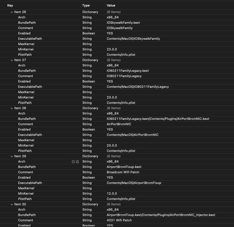

Max.1974 Posted July 28, 2023 Share Posted July 28, 2023 Sorry ask one more thing, if was necessary, Patcher table its need look like this values? Thanks again!! Link to comment Share on other sites More sharing options...
Cyberdevs Posted July 28, 2023 Share Posted July 28, 2023 36 minutes ago, Max.1974 said: Sorry ask one more thing, if was necessary, Patcher table its need look like this values? Thanks again!! Yes I think it's necessary to change the PXSX to ARPT otherwise it wont work. 1 Link to comment Share on other sites More sharing options...
deeveedee Posted July 28, 2023 Share Posted July 28, 2023 (edited) *** Deleted *** I thought you were replying to me - sorry about that. AirportBrcmFixup.kext renames PXSX to ARPT. The binary rename (in config.plist) should not be necessary if you are using AirportBrcmFixup.kext (and the binary rename did not help in my case). @Max.1974 The "Base" in your binary rename is wrong. The Base should not include ARPT (should be \_SB.PC00.RP05 if that is indeed the path for your Device ARPT). Note that my binary rename includes COUNT=1 (to limit the number of binary changes to 1) (just to be safe). Edited July 28, 2023 by deeveedee 1 1 Link to comment Share on other sites More sharing options...

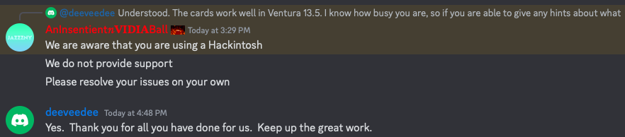

deeveedee Posted July 28, 2023 Share Posted July 28, 2023 (edited) Just in case you were wondering whether the OCLP Devs support hackintoshes 😂 Edited July 28, 2023 by deeveedee 1 1 Link to comment Share on other sites More sharing options...

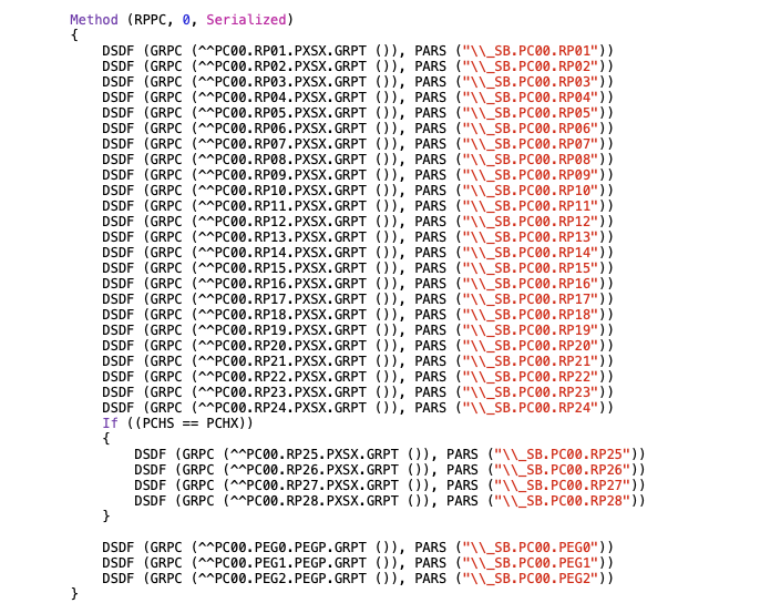

Max.1974 Posted July 28, 2023 Share Posted July 28, 2023 18 minutes ago, deeveedee said: Just in case you were wondering whether the OCLP Devs support hackintoshes 😂 I "think" (completely blind) its my DSDT show me GRPT So I guess its correctly ? Its just for prevent used in the future Link to comment Share on other sites More sharing options...
kinhhoang161 Posted July 28, 2023 Share Posted July 28, 2023 13 minutes ago, Max.1974 said: I "think" (completely blind) its my DSDT show me GRPT So I guess its correctly ? Its just for prevent used in the future Do you have the window os?. You can check ACPI path by going to Device Manager > Right Mouse to your wifi > Properties > Details > BIOS DEVICE NAME > you can see the acpi path of your wifi 2 Link to comment Share on other sites More sharing options...
Max.1974 Posted July 28, 2023 Share Posted July 28, 2023 47 minutes ago, kinhhoang161 said: Do you have the window os?. You can check ACPI path by going to Device Manager > Right Mouse to your wifi > Properties > Details > BIOS DEVICE NAME > you can see the acpi path of your wifi Thanks a lot, im can't use Windows and this machine, but I will try. Its just for fun and learn edit compiled my SSDTs Link to comment Share on other sites More sharing options...

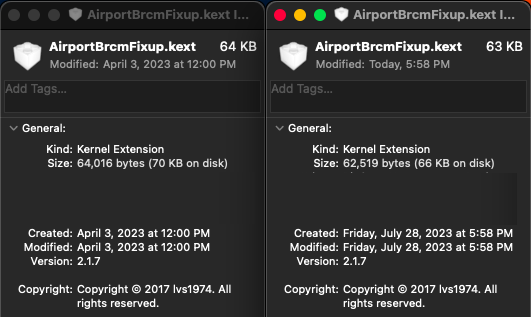

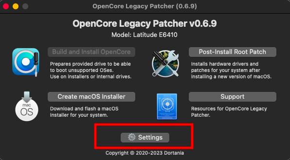

deeveedee Posted July 28, 2023 Share Posted July 28, 2023 (edited) I have Wi-Fi working with BCM 94352HMB. I'm not sure that this is all necessary, but here is what I did: EDIT: I have not yet finished reviewing my solution, but early indications are that the key was replacing AirportBrcmFixup.kext. I am using the attached kext and Wi-Fi is working perfectly with my BCM 94352HMB device. This is the kext that is included with OCLP 0.6.9 07.28.23 nightly build. EDIT2: Device spoofing is required for application of OCLP post-install wi-fi patches on my HackBookPro6,2 with BCM 94352HMB. See here. I am leaving this post for historical purposes, but my new post supersedes this post. Replace AirportBrcmFixup.kext 2.1.7 in OC/Kexts with the AirportBrcmFixup.kext 2.1.7 in the OCLP-Generated EFI (they have the same version, but have different sizes) *** This is not necessary. I am leaving this for historical purposes. See my corrected conclusions here. **** Spoiler config.plist should not have VMM kernel patches and should have revpatch=sbvmm (for RestrictEvents.kext 1.1.2) (this may not be necessary or may be specific to my SMBIOS MBP6,2 - not sure yet) (Reference the attached sample config.plist) AMFI should be disabled with amfi=0x80 and kernel patch (reference the attached sample config.plist) Implement ACPI patch (SSDT) to spoof device "pci14e4,4353" (not sure this is necessary - My SMBIOS is MBP6,2 and this is the actual device in a real MBP6,2) *** Deleted - Not necessary *** Implement ACPI binary rename (config.plist) RP02.PXSX -> RP02.ARPT *** Deleted - Not necessary *** Your EFI must include RestrictEvents.kext 1.1.2 for the revpatch=sbvmm property Apply legacy wi-fi post-install patches with 0.6.9n 07.28.23 (use nightly build, not custom build. No python mods necessary). For some reason, the latest OCLP 0.6.9 nightly build was able to patch my hack. Previous versions did not have any patches available. I am not sure if this is a change in the OCLP build (I don't see any commits, so I don't think so) or because I spoofed Wi-Fi device. Maybe the new AirportBrcmFixup.kext was necessary? Maybe revpatch=sbvmm was necessary? I am posting this with FireFox in Sonoma 14.0 Beta 4 on my hack over BCM94352 Wi-Fi 😀 AirportBrcmFixup.kext.zip sample-oclp-config.plist.zip Edited July 31, 2023 by deeveedee 2 2 Link to comment Share on other sites More sharing options...

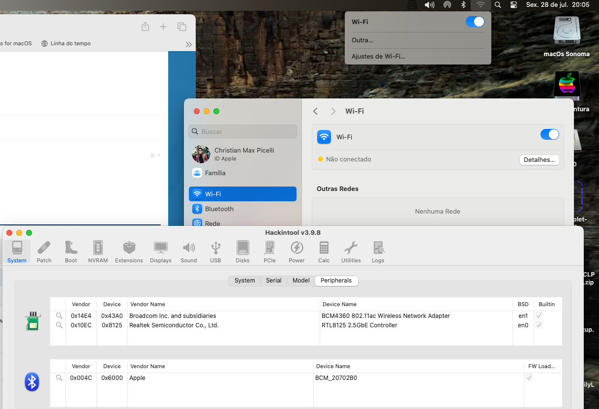

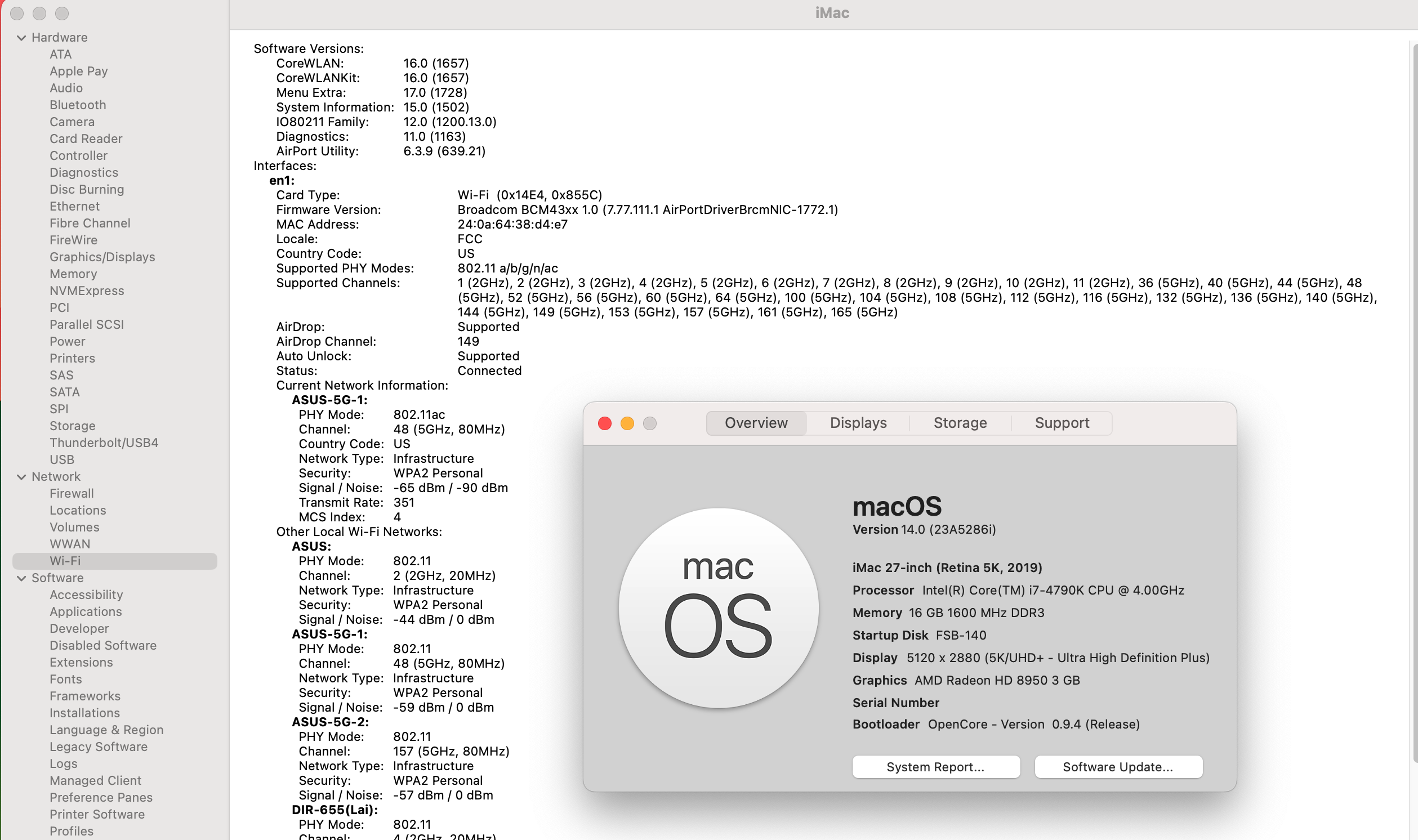

Max.1974 Posted July 28, 2023 Share Posted July 28, 2023 Hi my friends Cyber and Deeveedee Look at this!! Almost There Without OCLP Pacther. Only EFI Stuffs with all things 3 1 Link to comment Share on other sites More sharing options...
Max.1974 Posted July 29, 2023 Share Posted July 29, 2023 (edited) To me work very fine with OCLP Patcher But im not give up until wait a new solution only for Wi-FI Thanks thanks thanks I will test* (edit) your Broadcom kext Edited July 29, 2023 by Max.1974 1 Link to comment Share on other sites More sharing options...

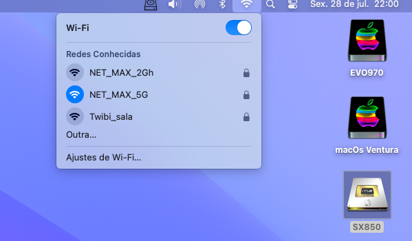

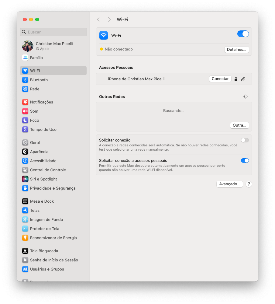

Max.1974 Posted July 29, 2023 Share Posted July 29, 2023 After revert OCLP and use your AirportBrcmFixup.kext above my iPhone appears !!!! Im thinking its close a little bit to get this works without OLCP Rooting. 1 Link to comment Share on other sites More sharing options...
