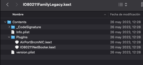

SavageAUS Posted June 5, 2023 Share Posted June 5, 2023 Am I reading this right that Broadcom based chips are not working?Sent from my iPhone using Tapatalk 2 Link to comment Share on other sites More sharing options...
PoMpIs Posted June 5, 2023 Share Posted June 5, 2023 (edited) 8 minutes ago, SavageAUS said: Am I reading this right that Broadcom based chips are not working? Sent from my iPhone using Tapatalk Not one of mine works... I have three native cards in Monterey and in Ventura: https://www.ebay.es/itm/174475763976?hash=item289f90e108:g:2hIAAOSw8WJfg~8P&amdata=enc%3AAQAIAAAAwE84Og0NlAayGpcbi75%2FU4eZa519g1xX4pNoHoaRKZh9K5bBnYtghREESVtGIHhXbzeiVoviplOJVs2kQPJeFTpBi2QszRk4EVltZyStuhi2SWZ9V%2B%2BDB4jrO6Pcipya90TnfS16MvQtBKVFVgqZTKu3Mpu5wcDU4T4RmNHeGIfxLz0U5IYEC1q6L4aq7W%2BgsAjTJ6wkkIuf%2Fz%2FCTaQwhkydOO%2B4gZHTRqL1JiubMzk3uRYxtLwzipfCYkv3bwCFiQ%3D%3D|tkp%3ABk9SR7rgtduRYg And a Fenvi-Clone... and none of them work I have looked a bit and we are missing kext... This is not in Sonoma, but if it comes out in Ventura Mine are all >pci14e4,43a0< 😅 Edited June 5, 2023 by PoMpIs Link to comment Share on other sites More sharing options...
SavageAUS Posted June 5, 2023 Author Share Posted June 5, 2023 What Kexts if any are you using?Sent from my iPhone using Tapatalk 1 Link to comment Share on other sites More sharing options...
PoMpIs Posted June 5, 2023 Share Posted June 5, 2023 6 minutes ago, SavageAUS said: What Kexts if any are you using? Sent from my iPhone using Tapatalk I don't use any, I didn't need them with these wiffi cards... they worked OOTB.. I have two laptops plus the i3 6100 that without wifi are of no use to me 🥴 Link to comment Share on other sites More sharing options...
ichelash Posted June 5, 2023 Share Posted June 5, 2023 Just now, PoMpIs said: Mine gives a different error... probably because I don't have internet access because broadcom doesn't work... Tomorrow I will connect it by cable to the router to see if it works 😄 They have really killed Broadcom 2 Link to comment Share on other sites More sharing options...
Alex HQuest Posted June 5, 2023 Share Posted June 5, 2023 55 minutes ago, SavageAUS said: Am I reading this right that Broadcom based chips are not working? Sent from my iPhone using Tapatalk Curious if this also applies to original Apple Airport cards, Broadcom based. 2 Link to comment Share on other sites More sharing options...
PoMpIs Posted June 5, 2023 Share Posted June 5, 2023 1 minute ago, Alex HQuest said: Curious if this also applies to original Apple Airport cards, Broadcom based. What type of wiffi do Sonoma supported macs use??? Because as much as I look there is nothing of Broadcom in Sonoma 😔 1 Link to comment Share on other sites More sharing options...
Shaneee Posted June 5, 2023 Share Posted June 5, 2023 1 minute ago, Alex HQuest said: Curious if this also applies to original Apple Airport cards, Broadcom based. My Apple Broadcom card isn't detected. Plus side. Current AMD patches work just fine 8 Link to comment Share on other sites More sharing options...

draylax Posted June 29, 2023 Share Posted June 29, 2023 The legend Hervé over at OSX Latitude posted details in this thread https://osxlatitude.com/forums/topic/18228-macos-sonoma-140-beta1-early-feedback-and-findings/ Sample of post pasted here: Sonoma 1st beta officially drops 7th gen. Kaby Lake platforms (on top of older ones of course) but, for the moment, retains KBL graphics drivers. Why? Simple: because it's required to support Amber Lake UHD617 graphics of MBA8,1. Sonoma 1st beta drops Broadcom legacy 802.11ac wireless chipsets that Ventura still supported through IO80211FamilyLegacy kext: 14e4:43ba, 14e4:43a3 and 14e4:43a0, i.e. BCM43602, BCM4350 and BCM4360. Big Sur had already dropped support for the last 802.11bgn cards that Apple had retained up to Catalina. Supporting those older 802.11ac chipsets through a kext bearing the name "legacy" should have been quite an obvious hint in itself as far as what the future held... Sonoma 1st beta supports only the following Broadcom chipsets: 14e4:43dc, 14e4:4464, 14e4:4488, 14e4:4425, 14e4:4433 and 14e4:4434, i.e. BCM4355 (802.11ac), BCM4364 (802.11ac), BCM4377b (802.11ac), BCM4378 (802.11ax), BCM4387 (802.11ax) and BCM4388 (802.11ax). Afaik, all those are provided as specific SOCs to Apple by Broadcom, i.e. chips to be soldered on Apple motherboards and not available on add-on mini-PCIe/M.2 cards. https://wikidevi.wi-cat.ru/Broadcom With regards to the wireless chipsets fitted to Intel Mac platforms supported by Sonoma, it's as follows: 2018 Mac mini8,1 -> BCM4364 (pci14e4,4464) 2018/2019 MacBookAir8,x -> BCM4355 (pci14e4,43dc) 2020 MacBookAir9,1 -> BCM4377b (pci14e4,4488) 2018/2019 MacBookPro15,x -> BCM4364 (pci14e4,4464) 2019/2020 MacBookPro16,x -> BCM4364 (pci14e4,4464) 2019 iMac19,x -> BCM4364 (pci14e4,4464) 2020 iMac20,x -> BCM4364 (pci14e4,4464) 2017 iMacPro1,1 -> BCM4355 (pci14e4,43dc) 2019 MacPro7,1 -> BCM4364 (pci14e4,4464) Member chris1111 suggested some USB WIFI adapters work and pointed us to: https://github.com/chris1111/Wireless-USB-OC-Big-Sur-Adapter 2 Link to comment Share on other sites More sharing options...

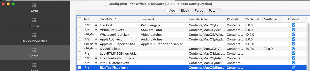

deeveedee Posted July 13, 2023 Share Posted July 13, 2023 6 minutes ago, mnfesq said: I have the same problem although it may come a bit earlier in the install process for me. Either way, I was able to resolve it by disabling BluetoolFixup.kext before running the update. Once it installs, I re-enable the kext and it and Sonoma run fine. You reported this same BluetoolFixup.kext experience with an earlier update and I believe that others reported a similar experience with certain Ventura updates. It would be interesting to know if anyone else is experiencing this BluetoolFixup.kext "conflict" with Sonoma OTA. 2 Link to comment Share on other sites More sharing options...
Takiller Posted July 13, 2023 Share Posted July 13, 2023 18 minutes ago, deeveedee said: You reported this same BluetoolFixup.kext experience with an earlier update and I believe that others reported a similar experience with certain Ventura updates. It would be interesting to know if anyone else is experiencing this BluetoolFixup.kext "conflict" with Sonoma OTA. Updates also fail on my side with BluetoolFixup and disabling it before the update does resolve the issue. 2 Link to comment Share on other sites More sharing options...
PoMpIs Posted July 13, 2023 Share Posted July 13, 2023 (edited) 54 minutes ago, mnfesq said: I have the same problem although it may come a bit earlier in the install process for me. Either way, I was able to resolve it by disabling BluetoolFixup.kext before running the update. Once it installs, I re-enable the kext and it and Sonoma run fine. Oh my GOD!!! I have disabled BluetoolFixup.kext and the Lenovo L390 has updated without problems.. Thank you so much Edited July 13, 2023 by PoMpIs 6 1 Link to comment Share on other sites More sharing options...
deeveedee Posted July 13, 2023 Share Posted July 13, 2023 (edited) Now it would be interesting to find the common denominator that causes the BluetoolFixup.kext conflict with Sonoma OTA. I have BluetoolFixup.kext 2.6.8 [Dev] installed on my HackBookPro6,2 and it does NOT block Sonoma OTA. My config is as follows: SMBIOS Model: MBP6,2 Open Core 0.9.3 [Release] Lilu 1.6.6 SIP (csr-active-config): <03080000> Edited July 13, 2023 by deeveedee 4 Link to comment Share on other sites More sharing options...
