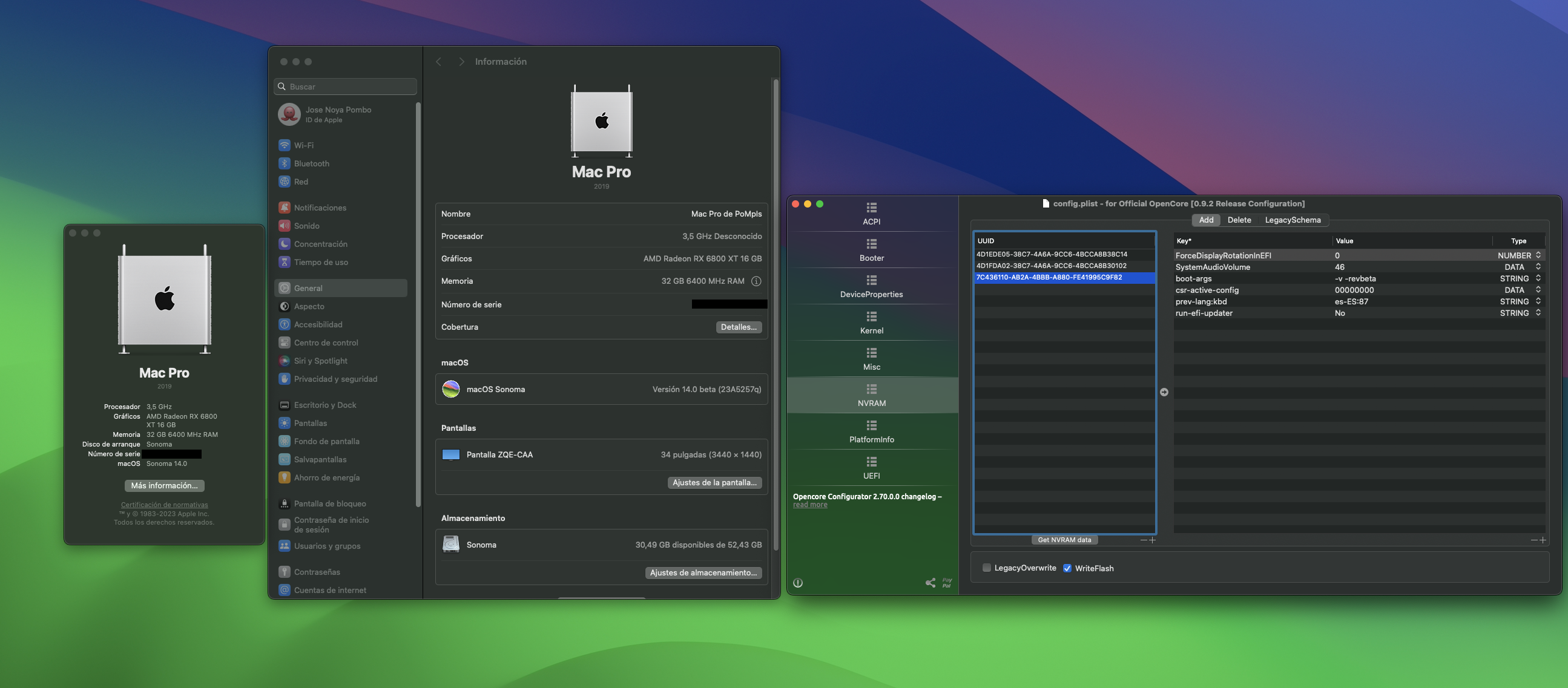

miliuco Posted June 7, 2023 Share Posted June 7, 2023 (edited) @D3v1L @Cyberdevs In this way (all entries in PlatformInfo and custom memory) the memory misconfiguration warning is removed but there are 8 non-existent PCI slots and ghost empty memory slots. Also, the text About This Mac >> 1 alert does not disappear on my system. In my opinion, RestrictEvents option is more elegant. Without forgetting that it is the one recommended by the authors of OpenCore. @D3v1L Pages and TextEdit work fine on my system. LittleSnitch not tried. Edited June 7, 2023 by miliuco 3 Link to comment https://www.insanelymac.com/forum/topic/356881-pre-release-macos-sonoma/page/8/#findComment-2805816 Share on other sites More sharing options...

Cyberdevs Posted June 7, 2023 Share Posted June 7, 2023 @miliuco I used OpenCore Configurator to regenerate the SMBIOS data and checked the "Add this section in config.plist" under both Datahub and SMBIOS section and after rebooting the system the Alert was gone and there are no ghost slots Spoiler 4 Link to comment https://www.insanelymac.com/forum/topic/356881-pre-release-macos-sonoma/page/8/#findComment-2805820 Share on other sites More sharing options...

D3v1L Posted June 7, 2023 Share Posted June 7, 2023 (edited) 27 minutes ago, miliuco said: there are 8 non-existent PCI slots true. This "issue" is related to misconfiguration and key not present in NVRAM entries (5EDDA193-A070-416A-85EB-2A1181F45B18) ...I didn't investigate in this..'couse is only cosmetics... 27 minutes ago, miliuco said: ghost empty memory slots ? can you explain this please? 27 minutes ago, miliuco said: About This Mac >> 1 alert does not disappear on my system really strange...did you have populated the Platform Info in all "needed" parts? 27 minutes ago, miliuco said: RestrictEvents option is more elegant they simply hide the problem..not solve it.. 27 minutes ago, miliuco said: Without forgetting that it is the one recommended by the authors of OpenCore. sure, for many people, is much easy to hide than resolve LoL btw, the author of OC, recommend to use WEG for have a working dGPU... they say in the past NO ONE with TRX40 have an up and run hackintosh...LoL never use weg at all and have 100% of dgpu performance...i'll use TRX from year with hackintosh and OC...so...sometimes, is mush easy to say no than investigate 😉 (HUN WITH ALL RESPECT FOR OTHER GUY JOB!ahah remember, i'm not here for judge or other...) 😛 btw, complete/correct Platform Info is like this: Spoiler and with this: no alert at all. 🙂 🙂 Edited June 7, 2023 by D3v1L 2 Link to comment https://www.insanelymac.com/forum/topic/356881-pre-release-macos-sonoma/page/8/#findComment-2805822 Share on other sites More sharing options...

miliuco Posted June 7, 2023 Share Posted June 7, 2023 12 minutes ago, PMheart said: Yes. I just merged it a couple minutes ago. Enjoy the release next week. Thank you!!! @Cyberdevs @D3v1L I'll try again and comment, i did populate Generic and DataHub but not SMBIOS. By ghost empty memory slots I mean that really there are only 4 memory slots on the mobo but memory info says that there are 12, 4 filled and 8 empty. Link to comment https://www.insanelymac.com/forum/topic/356881-pre-release-macos-sonoma/page/8/#findComment-2805827 Share on other sites More sharing options...

D3v1L Posted June 7, 2023 Share Posted June 7, 2023 1 minute ago, miliuco said: By ghost empty memory slots I mean that really there are only 4 memory slots on the mobo but memory info says that there are 12, 4 filled and 8 empty. ooooh ok ok 🙂 now we are at the point. this is normal. 2019 MacPro have 12 slot...so, if you use MacPro smbios, is normal that MacOS see that you have a "real MacPro" and.. ---> your system have 12 slot ('couse...MP have it) 😛 ... This is the correct configuration! 🙂 2 Link to comment https://www.insanelymac.com/forum/topic/356881-pre-release-macos-sonoma/page/8/#findComment-2805829 Share on other sites More sharing options...

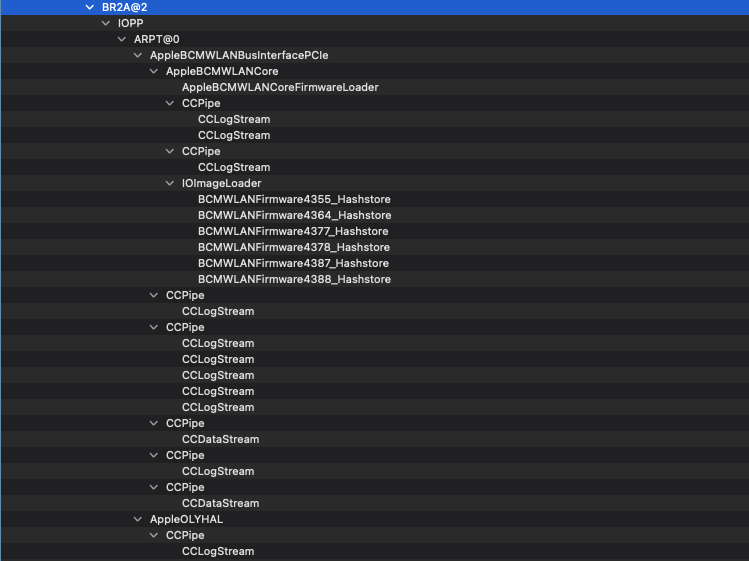

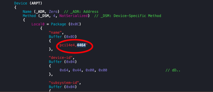

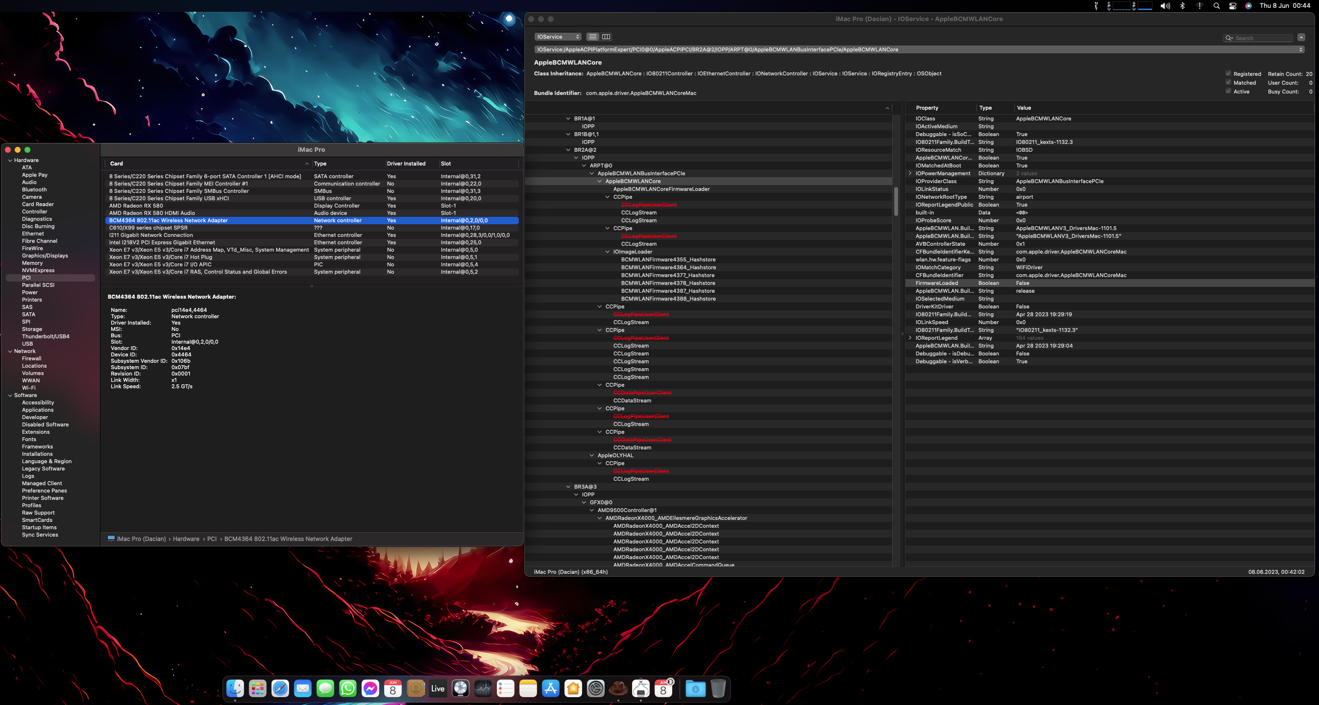

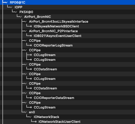

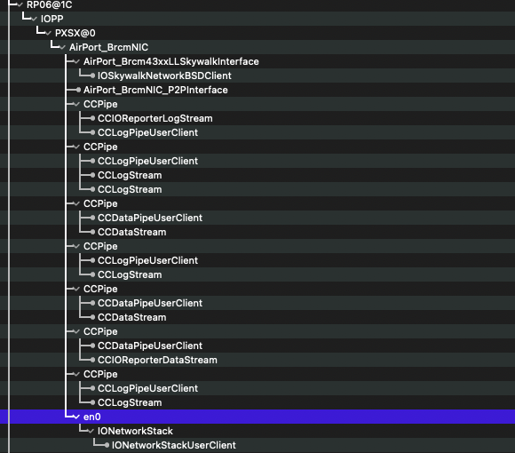

Nightf4ll Posted June 7, 2023 Share Posted June 7, 2023 (edited) Did I read this right? Broadcom BCM43xx won't work anymore? So I spent 70 USD and waited 2 months on delivery from China for nothing? I guess Ventura is not that bad then, for now... And in the future, gonna switch to windows either way. Hackintosh seems to be breathing it's last breaths. Edited June 7, 2023 by Nightf4ll Link to comment https://www.insanelymac.com/forum/topic/356881-pre-release-macos-sonoma/page/8/#findComment-2805833 Share on other sites More sharing options...
D3v1L Posted June 7, 2023 Share Posted June 7, 2023 (edited) 4 minutes ago, Nightf4ll said: Did I read this right? Broadcom BCM43xx won't work anymore? So I spent 70 USD and waited 2 months on delivery from China for nothing? I guess Ventura is not that bad then, for now... And in the future, gonna switch to windows either way. Hackintosh seems to be breathing it's last breaths. Yes. BCM43xx is found on 2015 MBA so, is no longer supported in Sonoma (and never plan to be supported in the future).... Sonoma cut pre 2017 system Edited June 7, 2023 by D3v1L 1 1 1 Link to comment https://www.insanelymac.com/forum/topic/356881-pre-release-macos-sonoma/page/8/#findComment-2805834 Share on other sites More sharing options...
