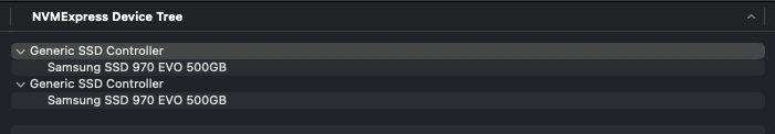

Im using a SATA SSD to test with but my NVME is present the WD SN850X (Ventura) however my WD SN570 does not show or my Samsung 970 EVO Plus, Yes, this has other things done to the kernel "Maxvalue"  that has to be updated or it will not boot + -lilubetaal, NVMeFix.kext disabled (have to remove Samsung NVME if left enabled)

Most Samsung NVMe SSDs do not play well with macOS' NVMe driver. You could try disabling NVMeFix.kext and see if that helps (probably with longer boot times and broken power management), but if it doesn't, then I'm afraid your only options are to either stay back on macOS versions where your current SSD works OR switch to a natively supported drive.
And yes, there are no plans (at the moment) to add support for modern macOS versions to NVMeFix, as it appears the drivers that ship with these newer versions are more complex to work with due to the more proprietary nature of it. The project is essentially considered discontinued (even for macOS Ventura) as confirmed by project lead Vit. You may refer to his comment here: https://github.com/acidanthera/NVMeFix/pull/7#issuecomment-1578275605

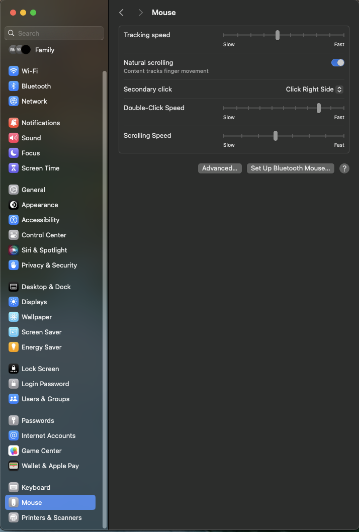

Setting for Natural scrolling is under mouse settings, see below turned on then off
image.thumb.png.9deedebcfb2368ecef4b16cde8b7f0d8.pngimage.thumb.png.21cb9db06425fe1ab8898c05de5dd2f9.png
on mine it's not show the Mouse option and something relates with Mouse it's not show the Natural Scrolling as before :))

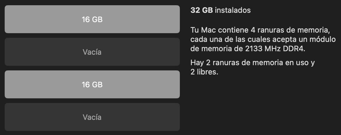

8 hours ago, PMheart said:
Did you add `-lilubetaall`, or at least `-revbeta` to forcibly load RestrictEvents? I roughly checked the patches, and they seem to be the same.

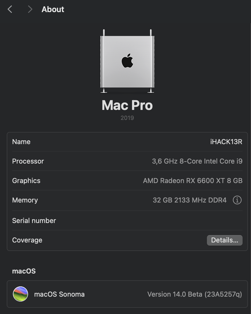

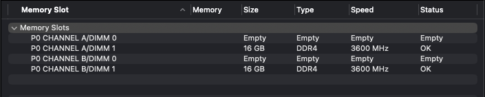

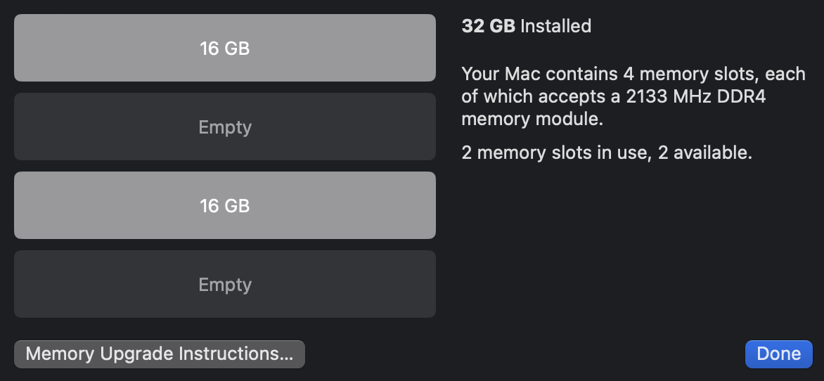

-revbeta does the trick, you're right: RestrictEvents loaded, no misconfiguration warning, no ghost PCI slots, RAM info ok.
Thank you!!!
Spoiler

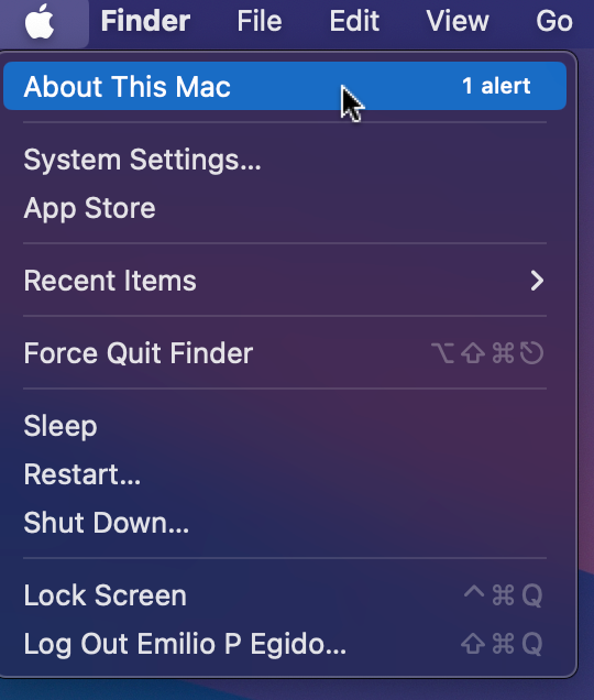

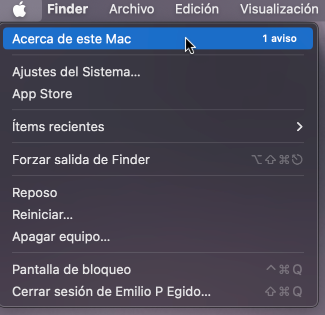

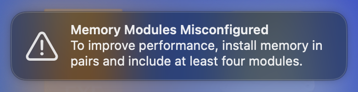

There is one thing that still catches my eye and that doesn't exist in Ventura. In the Apple menu >> About This Mac I can see "1 warning" but the warning is not displayed at boot and About This Mac window doesn't have any place to get a warning. Other than that, everything seems to work fine with RestrictEvents and MacPro7,1 on Sonoma using -revbeta.

I’ve been using a Samsung 970 (I think) m.2 in my desktop build for years.
I haven’t updated it to Sonoma yet but Ventura works perfectly.
Should be in my signature.

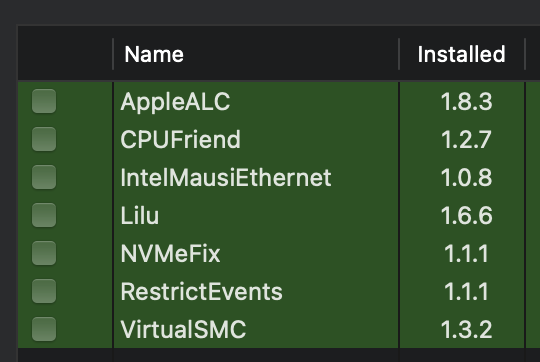

Below are the kexts I had to disable and also had to disable the ssd for the 6950xt, needed to use the AMDRadeonNavi kext to get graphics to work and to get this to boot properly, still no wifi but bluetooth and everything else works. Now to map my USB ports as the previous SSDT and subparts does not work
image.thumb.png.28dd108c2c00d90ecaff3861cde25b41.pngimage.thumb.png.c8e6b7f56bbaf73bf56c32d2a0ab9c7d.pngimage.thumb.png.57467eff7f2ca9f8c83fba395ec78562.png
Where about a is the AMDRadeonNavi kext from? I’m stuck at EXITBS:START on my amd rig with a rx 6800 xt.
Exit: never mind I’m a dummy. Needed to change max kernel on patches.

@miliuco
Thanks... ... when I get home I'll try "revbeta"...
regarding the warning about this mac, it is not removed, it also happens in ventura and earlier with smbios MacPro7,1 if you start without RestrictEvents and without mapping the memory, when loading the system it says "memory modules misconfigured" and a once shown even if you activate RestrictEvents again, that warning does not disappear

Thanks. Would you mind switching your OS language to English US, and then post the screenshot with warning again?

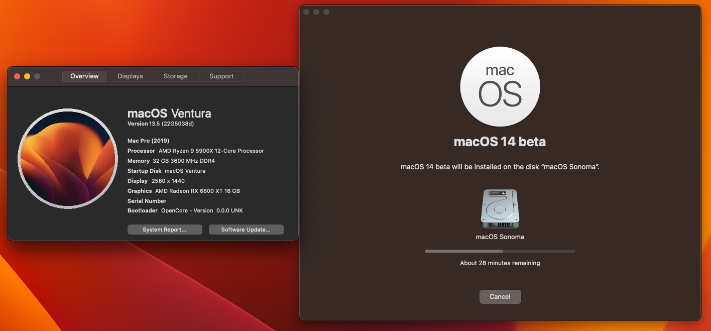

AMD success.
Everything except WIFI appears to be working.
I am using Ethernet over Power for internet access at the moment until WiFi gets sorted.
