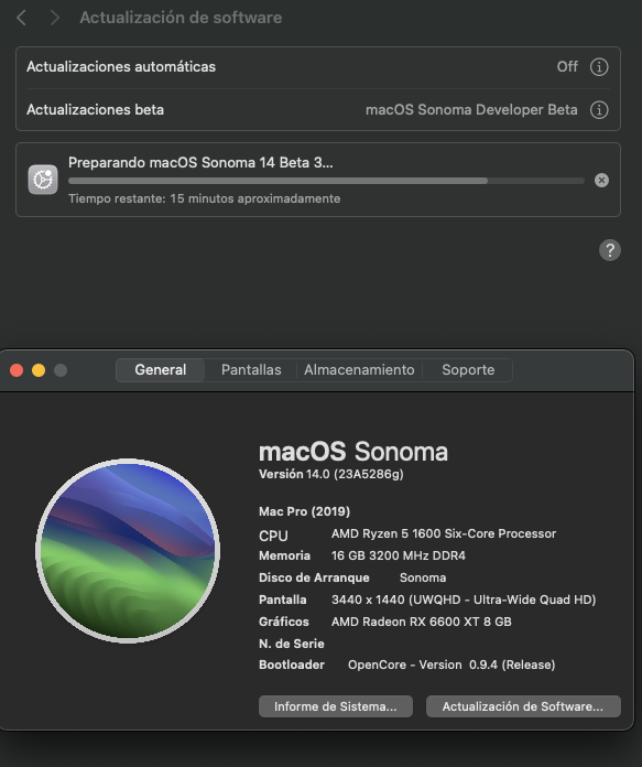

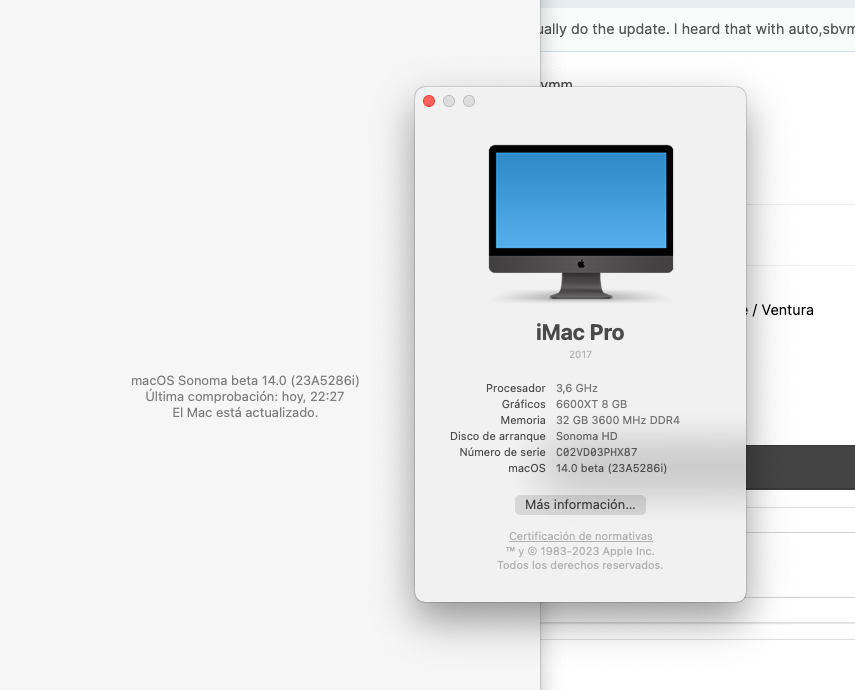

PMheart Posted July 9, 2023 Share Posted July 9, 2023 (edited) 15 hours ago, miliuco said: Good afternoon, I already updated to beta 3 changing SMBIOS to iMac19,1 so I can't tell you anything about these 3 patches and OTA updates until next beta. But I do tell you about my experience with the settings that interest you in a normal use: pciui and memtab patches remove warnings and configuration tabs (memory is shown with real slots and pci tab disappears)* pciui, memtab and sbvmm patches all together do, afaik, the same, taking into account that I have already updated to beta 3 and I cannot check sbvmm and OTA updates process, outside of this scope I see no difference with or without the sbvmm patch. * Badge "About This Mac 1 alert" remains even with latest RestrictEvents and following "Removing badges" instructions (defaults delete com.apple.SlotNotificationsPref memoryBadgeCount / defaults delete com.apple.SlotNotificationsPref expansionBadgeCount). I see this alert using custom memory without RestrictEvents or RestrictEvents without custom memory. But this is another issue 🙂 Reveal hidden contents I heard that sbvmm patch conflicts with pciui and memtab patches. i.e., OTA update will fail when enabled altogether. I don’t know if it is a model-specific issue (for MP7,1 only), but so far we know nothing more than that. <- You may try it out by installing beta 2 and then upgrade, or simply wait for b4. I temporarily removed the confusing commands, and they do not work as expected. Meanwhile, unfortunately there is no way to remove the badges properly either. Edited July 9, 2023 by PMheart 2 1 Link to comment Share on other sites More sharing options...

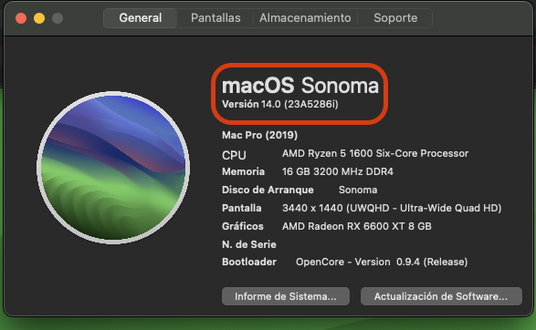

PoMpIs Posted July 9, 2023 Share Posted July 9, 2023 (edited) @cankiulascmnfye @miliuco I already did the SSDT with the HDAU device included and it didn't work either But it's already solved. 😆 There must be some incompatibility in the bios of the 6650xt with WEG+Sonoma and my MSI B450 I have flashed the 6650xt with the bios of the RX6600XT.. and..... It works now!!! I don't need SSDT-Spoof, or anything in Config plist.. it just works... And I have HDMI/DP audio and it works perfect appleTV, Prime Video, Netflix.... ..it was worth the effort 👌 Now it works 100%.... Well almost 100% because the wiffi does not work, I don't know if you have noticed 🤣 Thanks a lot for the help guys 🤗 Edited July 9, 2023 by PoMpIs 8 3 Link to comment Share on other sites More sharing options...

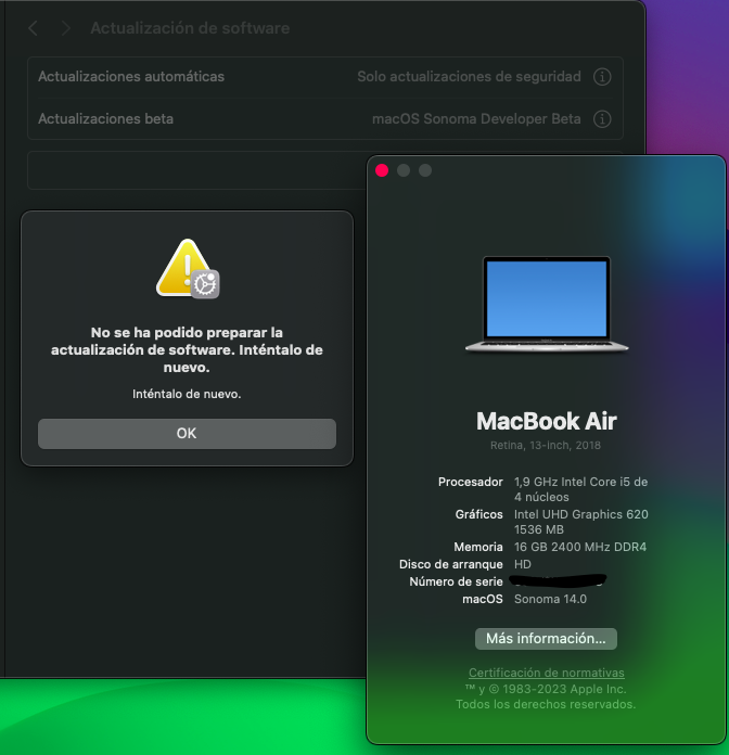

miliuco Posted July 9, 2023 Share Posted July 9, 2023 7 hours ago, PMheart said: I heard that sbvmm patch conflicts with pciui and memtab patches. i.e., OTA update will fail when enabled altogether. I don’t know if it is a model-specific issue (for MP7,1 only), but so far we know nothing more than that. <- You may try it out by installing beta 2 and then upgrade, or simply wait for b4. I temporarily removed the confusing commands, and they do not work as expected. Meanwhile, unfortunately there is no way to remove the badges properly either. The badge can't be removed in Sonoma, it's a very minor detail, just the text "1 alert" next to About This Mac when using MacPro7,1. Everything else seems to work fine. Now I'm on beta 3. When beta 4 is out, I'll try MacPro7,1 and iMacPro1,1 with and without the 3 RestrictEvents patches to check which combination(s) offer(s) OTA update. I'll tell you the results. Thank you. 3 Link to comment Share on other sites More sharing options...
D3v1L Posted July 9, 2023 Share Posted July 9, 2023 (edited) 48 minutes ago, miliuco said: The badge can't be removed in Sonoma Why not? 😳 (of course with 23A5286g and i'll try with and without RestrictEvents.kext ... not only in my daily use config... -without it-) Edited July 9, 2023 by D3v1L Link to comment Share on other sites More sharing options...
