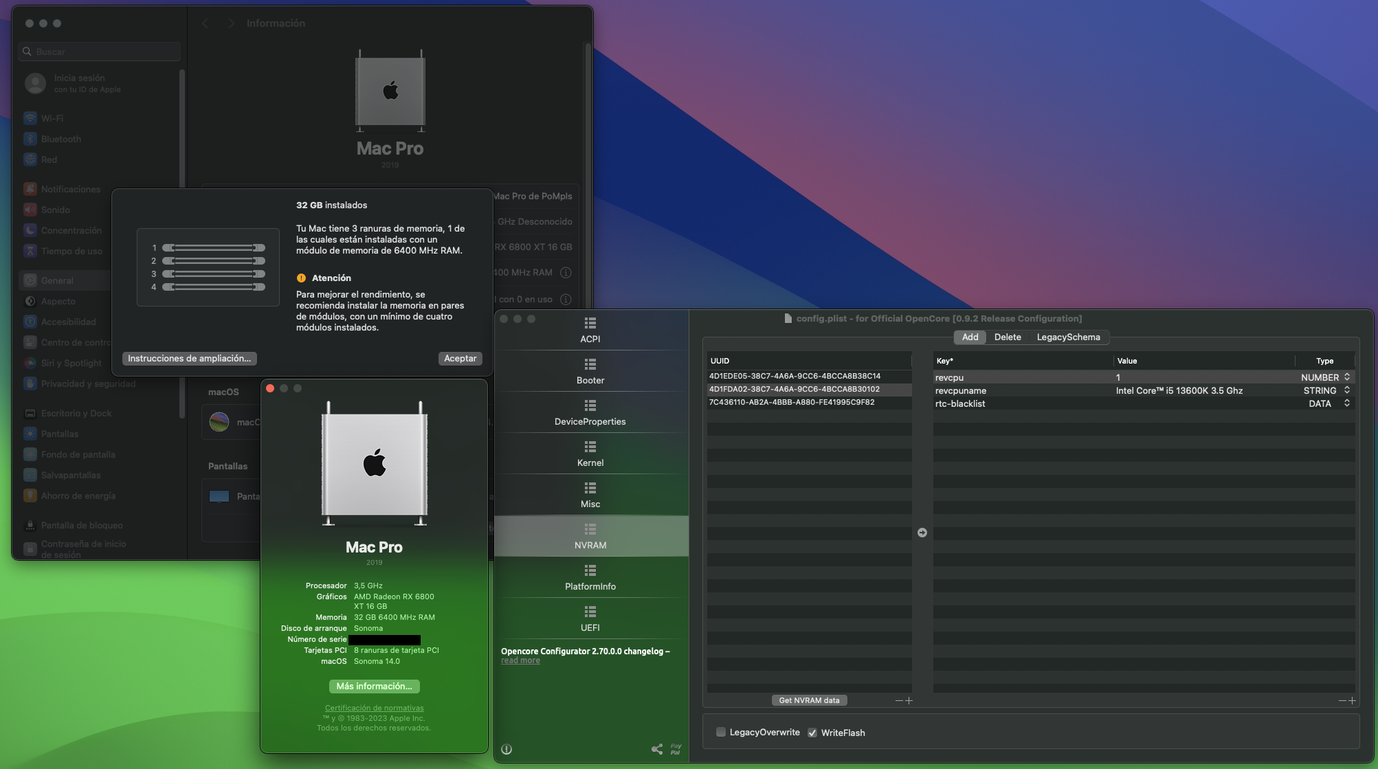

And speaking of my other hack...
I have updated all kext and OC with the latest updates, and now I can start Sonoma without -lilubetaall ...
But RestritcEvents does not work at all... the previous version worked partially for me, but the last one nothing, the memory error appears, and the CPU as unknown
1931561270_Capturadepantalla2023-06-06alas21_28_51.thumb.png.d3aaeab832d4d478f223d62310e8f7e9.png
Does it work well for you?

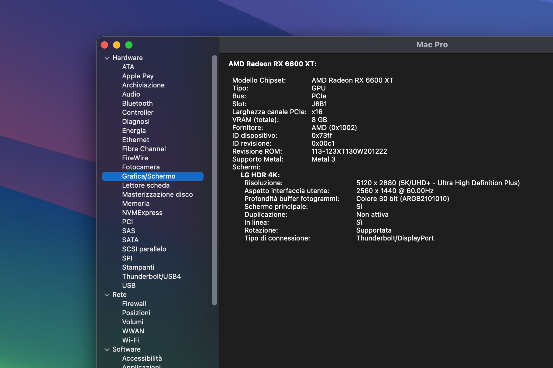

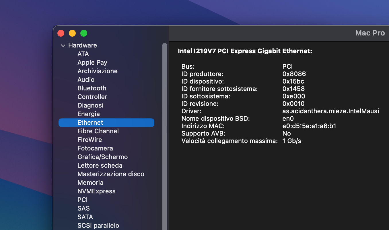

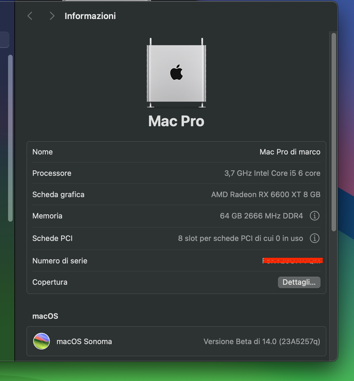

macOS 14 b1 installed on Z390 + i9-9900k + 6600 XT + latest OpenCore and kexts.
Issues so far:
  • iMacPro1,1 with SecureBootModel j137 or j160 or x86legacy: KP when booting from macOS Installer, installation never ending, I can boot back to the current Ventura 13.4 disk.
  • iMac19,1 with SecureBootModel x86legacy: I can install Sonoma, installation ended successfully, no wifi (Fenvi T919), no Ethernet (Intel I219V7).
  • MacPro7,1 with SecureBootModel j160 or x86legacy: I can install Sonoma, installation ended successfully, no wifi (Fenvi T919), Ethernet works (Intel I219V7), but RestrictEvents not loaded so the old memory misconfiguration warning is displayed >> solved with RestrictEvents 1.1.2 fc446c5    @PMheart. @PoMpIs
Tried for the wifi (no success):
  • DisableIoMapperMapping yes and not
  • DMAR table dropped and not dropped.
Moderately satisfied but network issue is a major drawback for me.
Edited by miliuco
  • Like 9
  • Thanks 1
