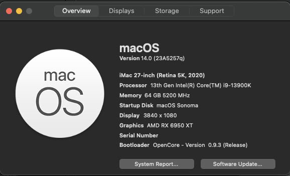

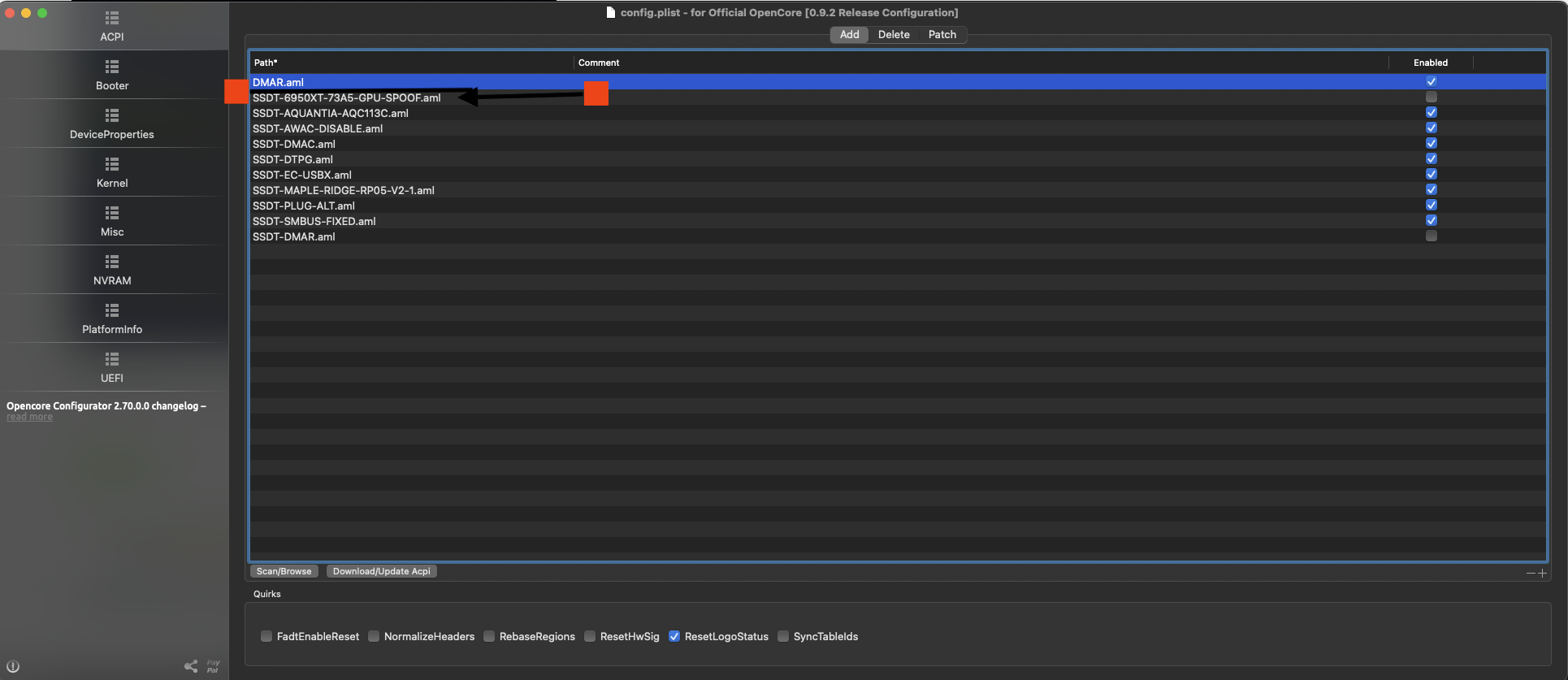

Done on Aero D, Z690 13900K with RX6950XT but had to turn of my USB Ports kext, restrictevents.kext, also changed smbios to iMac 20,2 - enabled usbijectall because no subparts kext but after 2 hours it finally works. No WIFI but have bluetooth with Broadcom m.2 card

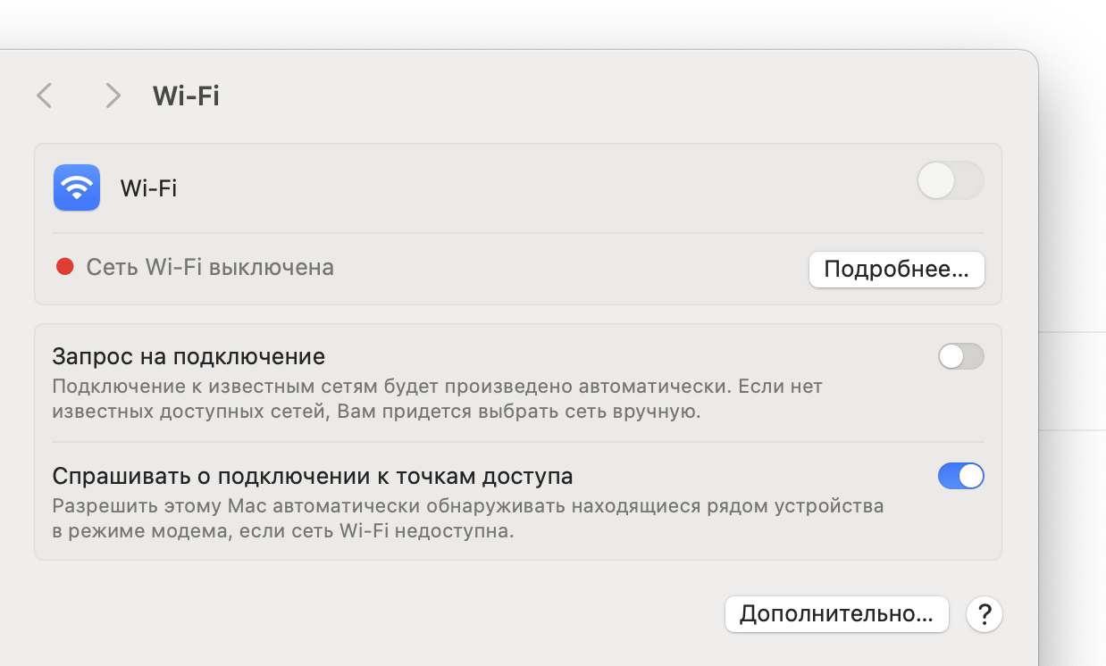

MSI Z490 reporting for Sonoma duty...........Observations so far, as reported the trusty Fenvi T-919 fails on the WIFI but not too concerned as the machine is normally connected by wire as well.
As it is the first Beta that problem will be solved pretty soon.
Date and Time is incorrect in relation to my part of the Globe so for the moment cannot be changed from Cupertino, CA - United States.
I am still poking around to see what works and what is screwed up.

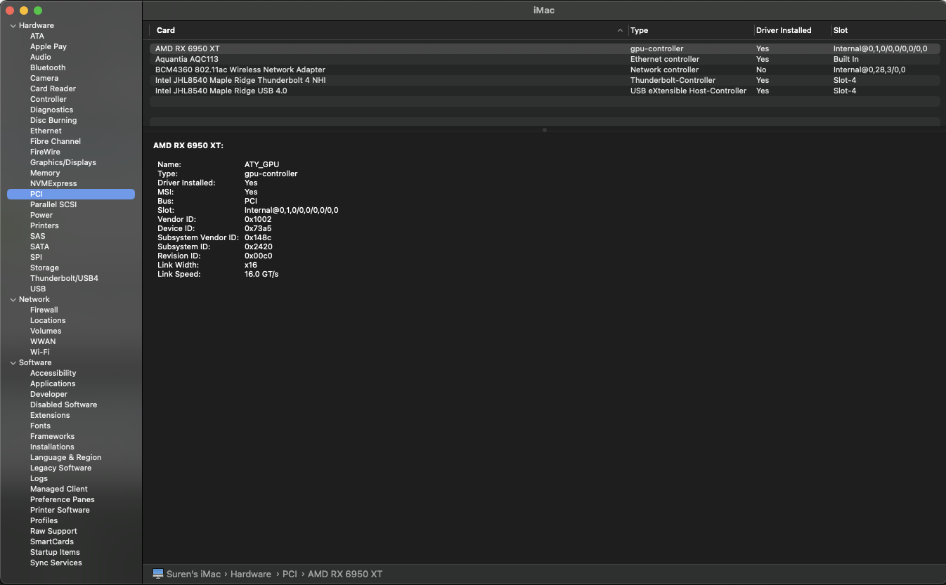

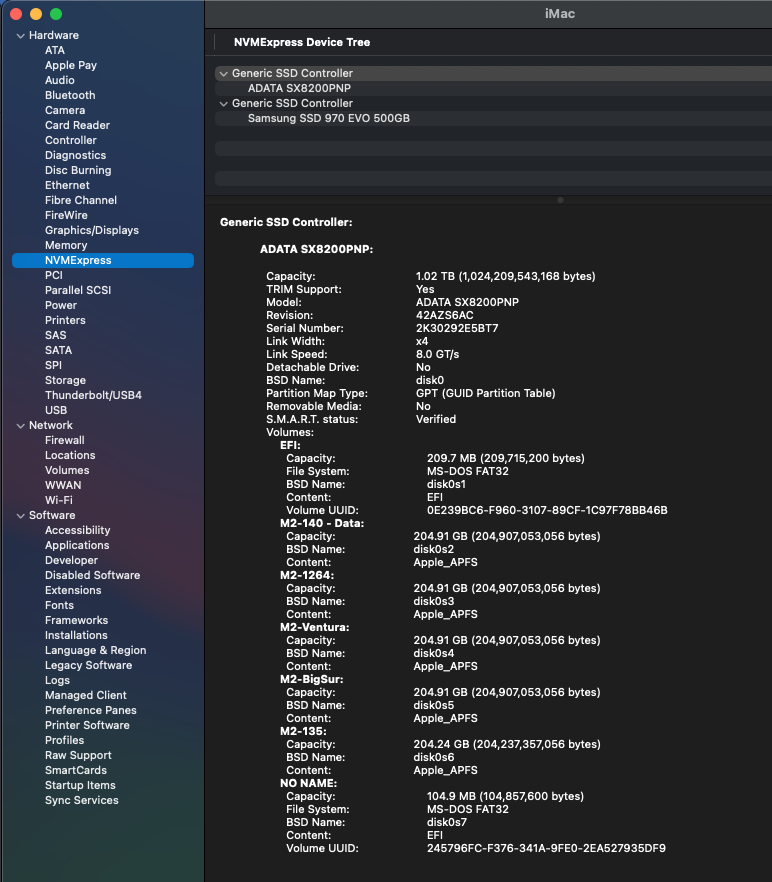

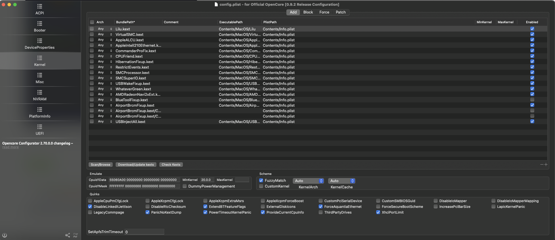

Below are the kexts I had to disable and also had to disable the ssd for the 6950xt, needed to use the AMDRadeonNavi kext to get graphics to work and to get this to boot properly, still no wifi but bluetooth and everything else works. Now to map my USB ports as the previous SSDT and subparts does not work
Spoiler
image.thumb.png.28dd108c2c00d90ecaff3861cde25b41.pngimage.thumb.png.c8e6b7f56bbaf73bf56c32d2a0ab9c7d.pngimage.thumb.png.57467eff7f2ca9f8c83fba395ec78562.png
  • Thanks 1

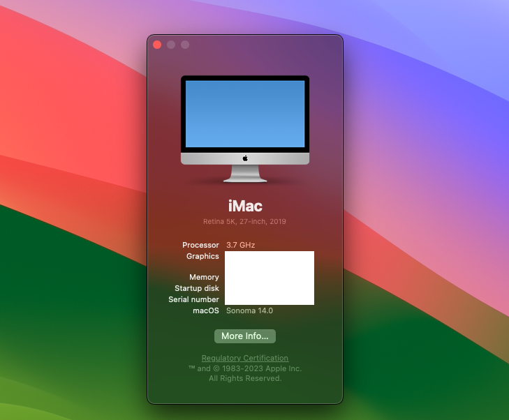

I only now noticed the time zone was off after reading your post, seems mine is defaulted to USA and I cannot see New Zealand. Apple thinks the world revolves around USA 🤪

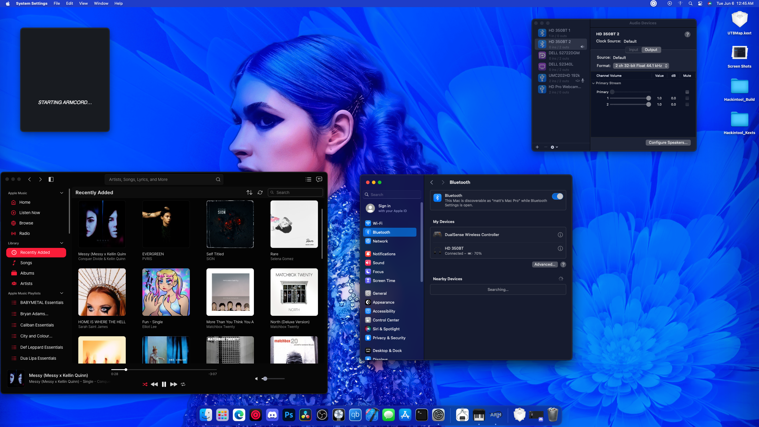

Working on Z490 Vision G. Add -wegbeta if you're using Whatevergreen and an AMD Card

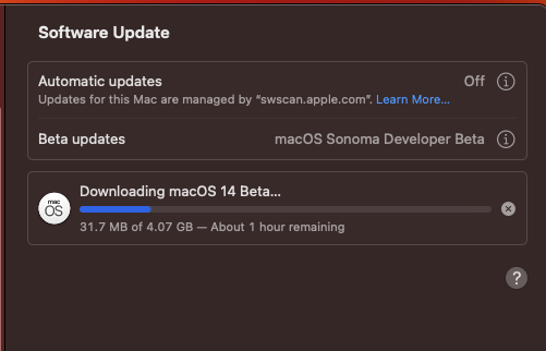

Clicking on "Software Update" does nothing, clicking on "Download Manually" brings youg to the homepage ;)

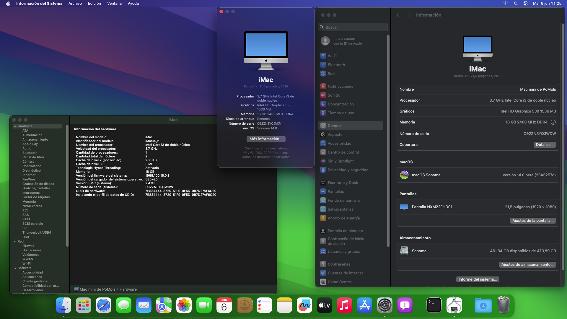

@ichelash

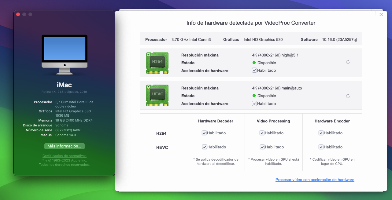

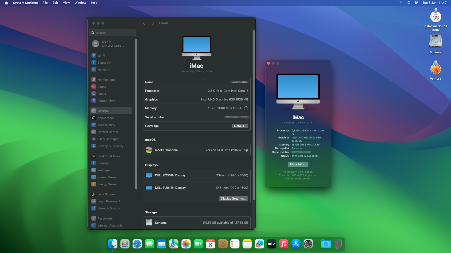

Finally, Sonoma on my i3 6100 and HD530...
It works really well... Too bad the Fenvi doesn't work, only the bluetooth 😪
Spoiler
1021504672_Capturadepantalla2023-06-06alas11_30_45.thumb.png.31efc7144d62612666ccace336ee6e5d.png
(The serials are generated only to test the installation)
  • Like 8

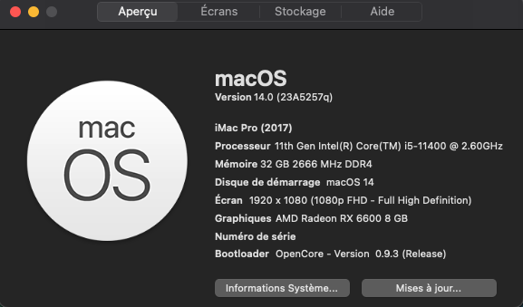

Hi all
How to create the App Sonoma beta 1 (23A5257q)
mkdir /tmp/032-94352
curl https://swcdn.apple.com/content/downloads/23/44/032-94352-A_DB05J15QWT/4x91v0yzolyiat5cat76ieu0h78aeu3d03/032-94352.English.dist -o /tmp/032-94352/English.dist
curl https://swcdn.apple.com/content/downloads/23/44/032-94352-A_DB05J15QWT/4x91v0yzolyiat5cat76ieu0h78aeu3d03/MajorOSInfo.pkg          -o /tmp/032-94352/MajorOSInfo.pkg
curl https://swcdn.apple.com/content/downloads/23/44/032-94352-A_DB05J15QWT/4x91v0yzolyiat5cat76ieu0h78aeu3d03/InstallAssistant.pkg      -o /tmp/032-94352/InstallAssistant.pkg
curl https://swcdn.apple.com/content/downloads/23/44/032-94352-A_DB05J15QWT/4x91v0yzolyiat5cat76ieu0h78aeu3d03/BuildManifest.plist      -o /tmp/032-94352/BuildManifest.plist
curl https://swcdn.apple.com/content/downloads/23/44/032-94352-A_DB05J15QWT/4x91v0yzolyiat5cat76ieu0h78aeu3d03/InstallInfo.plist              -o /tmp/032-94352/InstallInfo.plist
curl https://swcdn.apple.com/content/downloads/23/44/032-94352-A_DB05J15QWT/4x91v0yzolyiat5cat76ieu0h78aeu3d03/UpdateBrain.zip          -o /tmp/032-94352/UpdateBrain.zip
sudo installer -pkg /tmp/032-94352/InstallAssistant.pkg -target "/"
ls -ltr /App* | tail -1
drwxr-xr-x@  3 root     wheel   96  6 jui 11:38 Install macOS 14 beta.app
regards

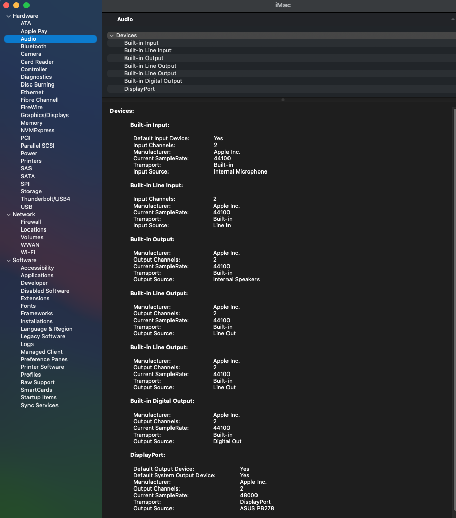

I need add "-lilubeta -wegbeta -alcbeta" to boot-args to enable everything working at Sonoma in my Z490-H Gaming hackintoshs.
Spoiler
