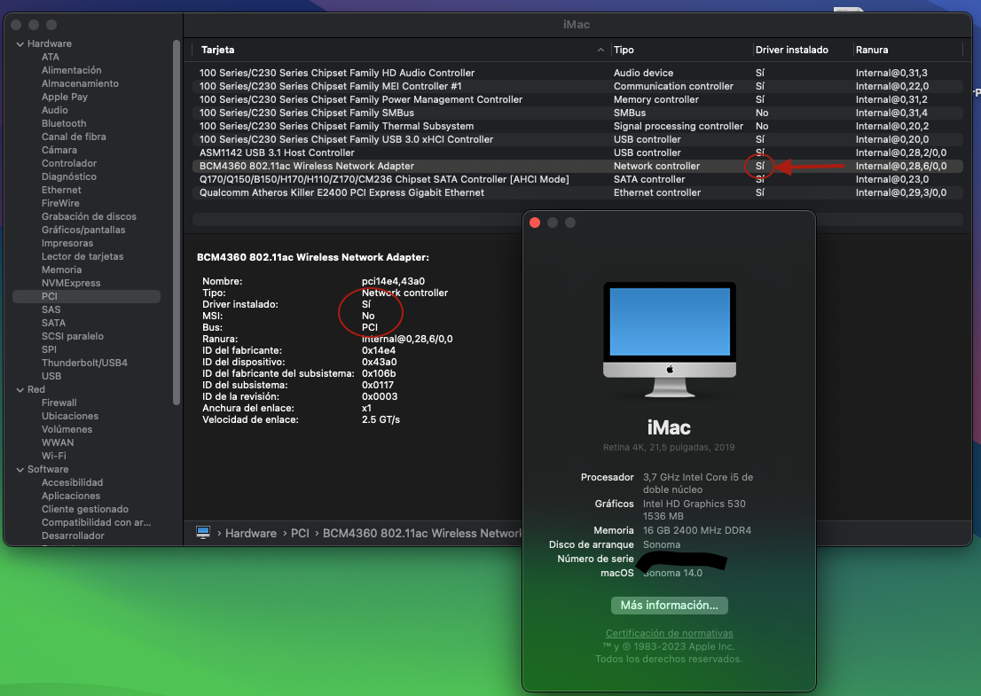

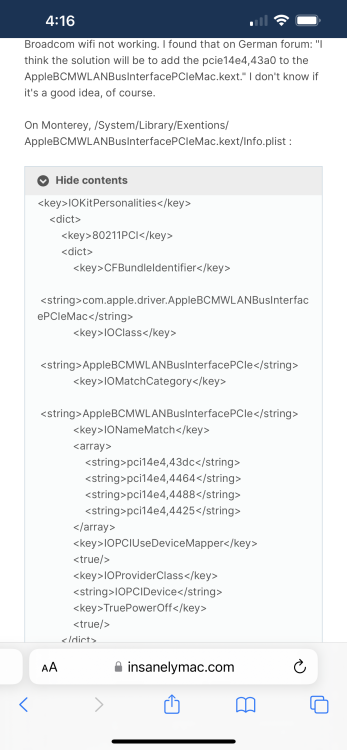

miliuco Posted June 9, 2023 Share Posted June 9, 2023 (edited) @eSaF @chris1111 Thanks. Yes, I got this dongle because it's in the "Support Drivers: (Adapter)" list. OpenCore developers already have an very early and complicated (I suppose) fix for the Broadcom wifis, I expect they will get the solution but there is no estimated time. EDIT: juste read about @Casey_S.J. adapter after publishing my post. Thanks. Edited June 9, 2023 by miliuco 2 Link to comment https://www.insanelymac.com/forum/topic/356881-pre-release-macos-sonoma/page/13/#findComment-2806029 Share on other sites More sharing options...

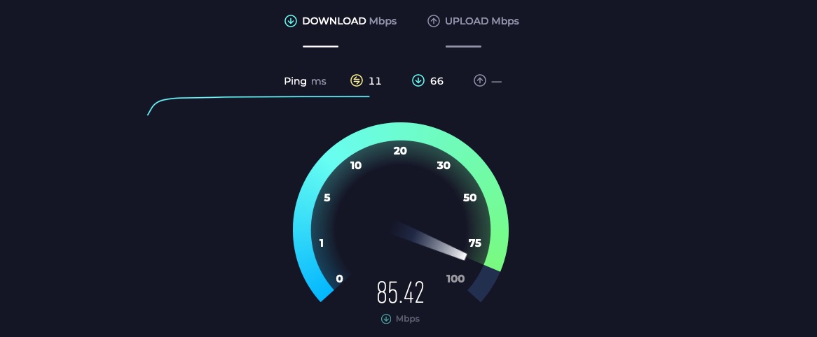

chris1111 Posted June 9, 2023 Share Posted June 9, 2023 good speed Alfa AWUS036ACM Mediatek driver (USB3.0) Link to comment https://www.insanelymac.com/forum/topic/356881-pre-release-macos-sonoma/page/13/#findComment-2806052 Share on other sites More sharing options...
