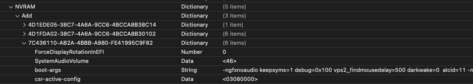

deeveedee Posted December 13, 2022 Author Share Posted December 13, 2022 (edited) @Andrey1970 Very interesting, thank you. I will test this. Note that the string "ngfxnoaudio" that is referenced as a boot-arg in the WhateverGreen docs is not present in the AppleALC source and it is not present in the WhateverGreen source. I don't see any code in either kexts that handles/processes the referenced ngfxnoaudio boot-arg. I'll test and report back here. Thank you. EDIT: @Andrey1970 I tested boot-arg -ngfxnoaudio, using it as documented in your link. Spoiler and found that the boot-arg does not prevent AppleALC from naming device HDAU. Spoiler Since I am not finding the boot-arg in the AppleALC and WhateverGreen source, I suspect that this is a documented feature that was not released. I will continue to test and if I confirm that the boot-arg does not work, I will submit a bug report. Thank you. Edited December 13, 2022 by deeveedee 1 Link to comment Share on other sites More sharing options...
deeveedee Posted December 13, 2022 Author Share Posted December 13, 2022 (edited) I have not been successful in using the -ngfxnoaudio boot-arg documented in @Andrey1970 's linked document here. Injection can be switched off by using boot-arg "-ngfxnoaudio" or more specific "-ngfxnoaudiocon". You can also use ioreg properties in GPU to disable respective injections: "no-audio-autofix" or "no-audio-fixconn". When I use the boot-arg, AppleALC still names device HDAU (resulting in the slow boot problem that I reported). I am not finding the boot-args (ngfxnoaudio, ngfxnoaudiocon) or the IOReg properties no-audio-autofix and no-audio-fixconn in the AppleALC and WhateverGreen source code, but I'd still like to test the IOReg properties. Does anyone know the values that I should assign to the IOReg properties no-audio-autofix and no-audio-fixconn if I want to test them? EDIT: My HackBookPro6,2 does not need WhateverGreen.kext (I fully patch Nvidia dGPU with SSDT), but I injected WhateverGreen.kext 1.6.2 anyway just to make sure I wasn't missing anything. Even when using both AppleALC.kext and WhateverGreen.kext with boot-arg -ngfxnoaudio, AppleALC still names device HDAU. Kexts Spoiler NVRAM (with boot-args) Spoiler Edited December 13, 2022 by deeveedee Link to comment Share on other sites More sharing options...

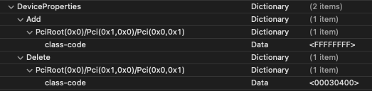

deeveedee Posted January 3, 2023 Author Share Posted January 3, 2023 (edited) EDIT: Vit9696 indicated that open core DeviceProperties can only overwrite properties for named devices. Since my Dell Latitude E6410 pci10de,be3 device is not named, OpenCore will not overwrite class-code. For this reason, I need to overwrite with a SSDT. --------------------------------------- I followed Vit9696's advice to set device pci10de,be3 class-code to FF FF FF FF and this does prevent AppleALC.kext from renaming pci10de,be3 to HDAU. Note that I was unable to overwrite the existing class-code via open core DeviceProperites. I needed to overwrite with the attached SSDT. With this attached SSDT, I am able to use AppleALC.kext v1.7.7 Attempting to overwrite class-code via OpenCore DeviceProperties does NOT work for me: Spoiler SSDT-HDMI.aml.zip Edited January 3, 2023 by deeveedee Link to comment Share on other sites More sharing options...
