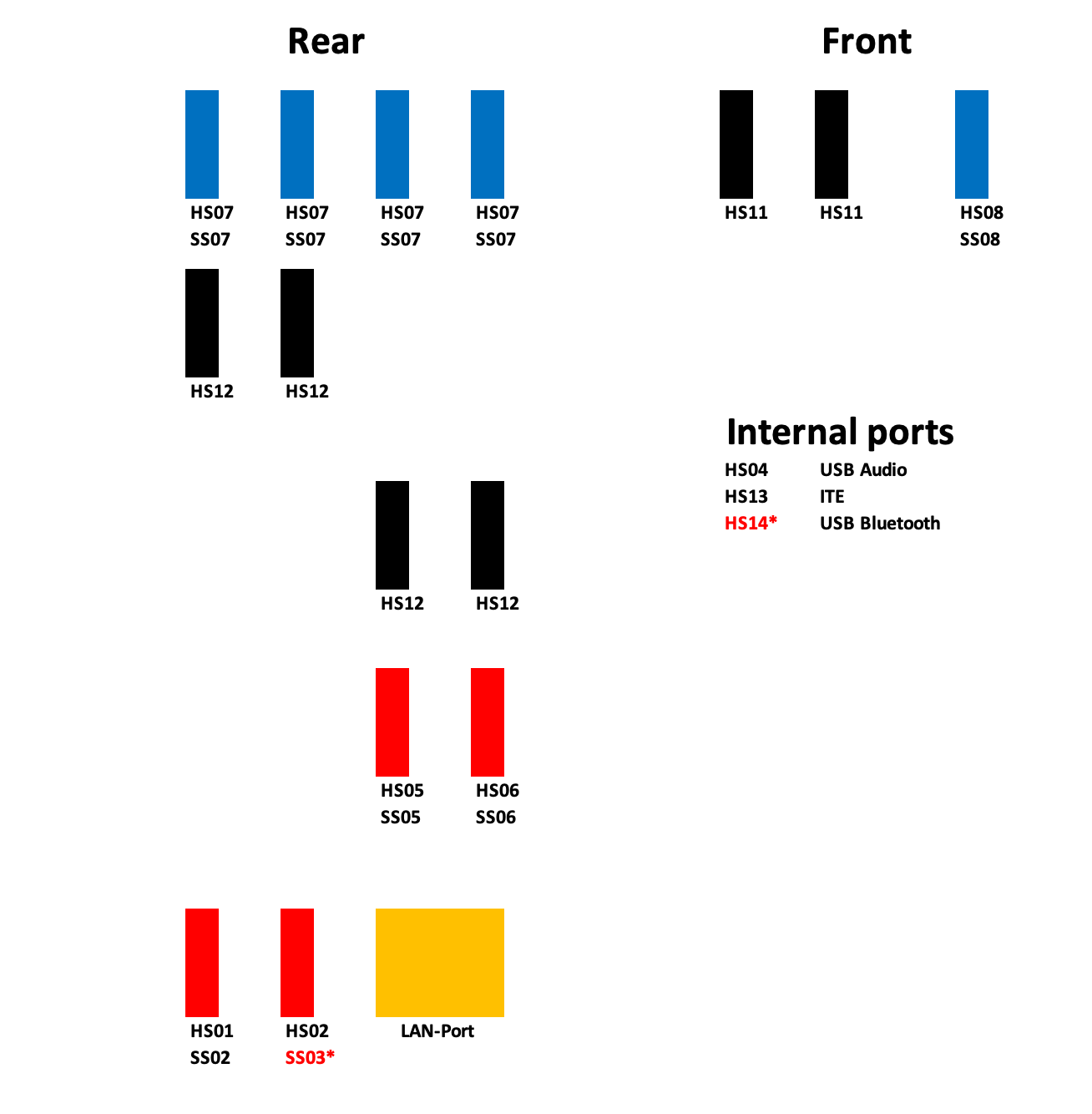

verdazil Posted August 18 Author Share Posted August 18 (edited) USB settings for Gygabyte Z690 AORUS ULTRA 1. I used F_USB1 and F_U32 Motherboard Internal Connectors. 2. To avoid exceeding the port limit (15), ports SS03 and HS14 are not defined in USBMap.kext. You can add any of them at the expense of some other port. 3. Please note that the USB controller device name in the USBMap.kext is ХHС. If yours is different, you need to apply the binary ACPI DSDT patch - renaming XHCI to XHC. 4. Please note that in other used SSDT tables you may also need to rename XHCI to XHC USBMap.kext.zip USB-Map.plist.zip HXCI-to-XHC.plist.zip Edited August 20 by verdazil 2 Link to comment Share on other sites More sharing options...
