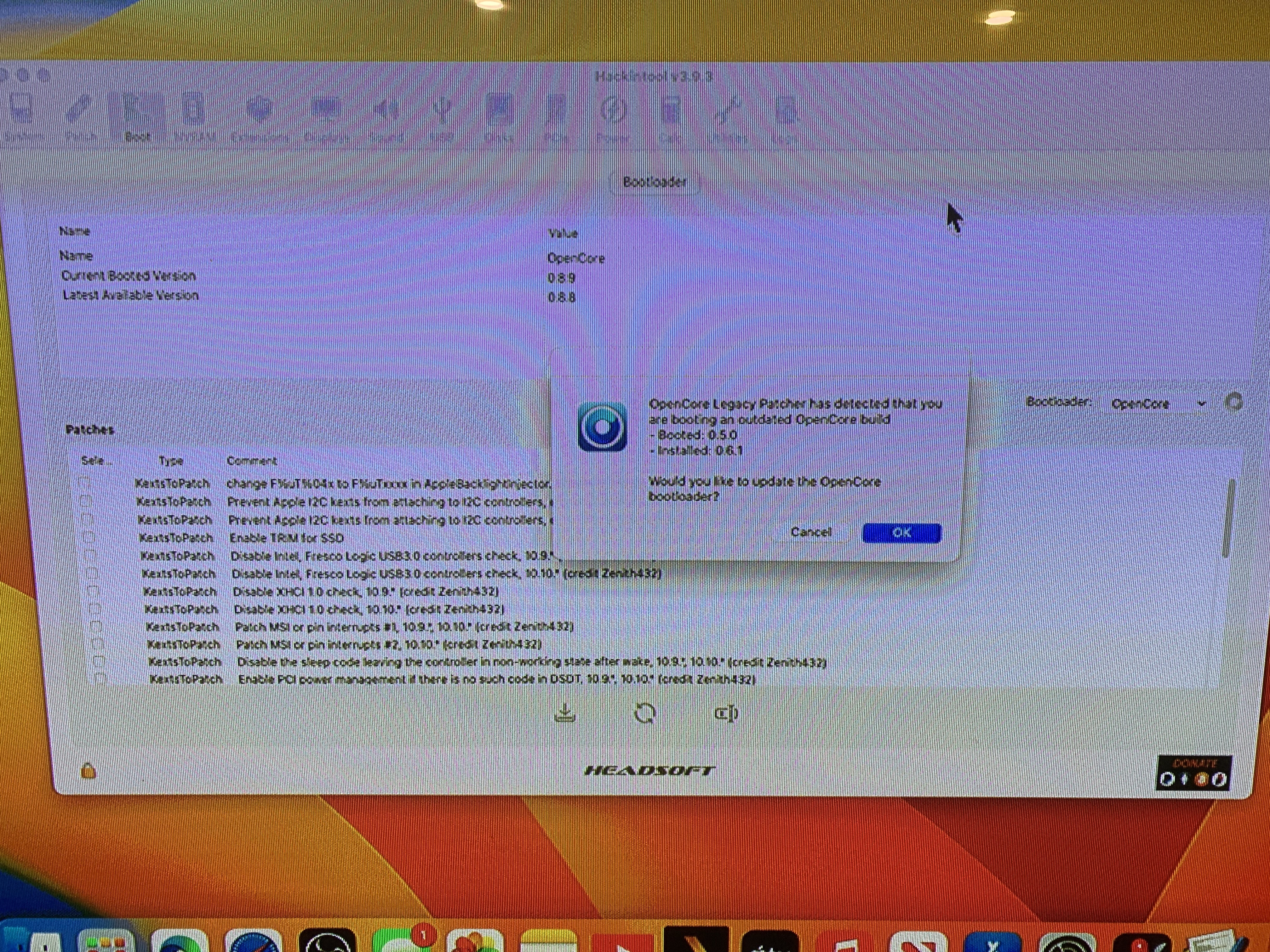

I used OCLP 0.6.1 to patch my Haswell computer that I am running as a Mac mini.  Now, whenever I boot up, I am getting this message and would like to know what is causing it.  Any suggestions for what I can do to make it stop.  BTW, my EFI is set up for both Clover and OC and I use the boot selector that comes bundled with Clover to choose my boot loader.  Typically, I use OC to boot and am using the most current version of both Clover and OC. I do not know what OCLP wants to change in my OC EFI.  It is working fine now so I am reluctant to allow OCLP to make changes.  What change does OCLP want to make?
Have you tried Resetting NVRAM?
EDIT: If not that, could it be the OCLP-Version NVRAM entry in your OC config.plist?  I don't remember whether I tried running without changing this, since I've changed the OCLP-Version entry when I started using OCLP 0.6.1.

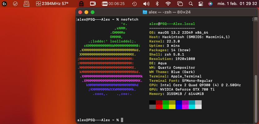

Hey guys! I'm playing now with an P5Q, Q9300, GTX 780 Ti. All OK, but it can't go to sleep. Actually sleeps, but fans continue to spin. No wake up from keyboard, mouse or button. Only after reset, reboot I can have light on screen. Ideas?
Spoiler
Edited by Stefanalmare
@Stefanalmare  It's been a Looooong time since I played with a board like that.  If I remember correctly, my MB had a jumper that changed the standby mode of the USB ports.  In one jumper position, the USB ports provided 5V for USB charging when in standby mode S3.  In the other position, the ports did not provide 5V for USB charging when in standby mode S3.  Only one of the jumper positions allowed my hack to sleep/wake properly, but I don't remember which jumper position.   Does the P5Q have such a jumper for USB S3 mode?  Does that help you?
Edited by deeveedee

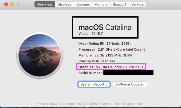

Thank you very much for your prompt response making it clear about the use of OCLP in Hackintosh and its original indication.I have resurrected a Macbook pro 13" of 2010 and another MacBook Pro Retina 15" of 2012 with OCLP to the most current macOS Ventura 13.2 released recently, progressively from macOSCatalina through Monterey versions. When I tried to create a macOSMonterey USB installer in my Hackintosh Catalina 10.15.7with  Clover V5151 on my GA-Z390 Gaming Xsystem  (listed below in my signature) but with a changed Intel CPU of i5 8400 with integrated Intel UHD 630 with or without Nvidia GeF GT 710 2Gb in PCIE Slot 1, I am not getting the options to "Build and Install OpenCore" (and also Post Install Root Patch)in OCLP; they are missing while avaialbwele in true Macs . Can you point out what I am doing wrong based on your experience using it in your Hackintosh with "Unsupported hardware".

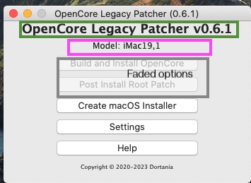

I haven't used OCLP to patch just the Nvidia graphics on "modern" hardware, but I'm guessing that your SMBIOS MacModel is one that does not need OCLP patcher.  Have you tried opening OCLP settings and changing the MacModel?  Your Z390 does not need OCLP, so if your GT 710 is a Mac-compatible card, you should only need to apply post-install patches for your Nvidia graphics.

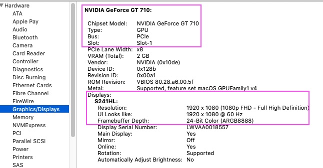

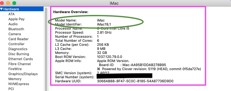

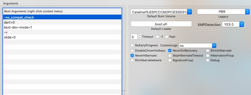

My SMBIOS of currently running Catalina 10.15.7 on Clover boot loader with Graphics Nvidia GeF GT 710 is iMac 19.1 . Please note attached images showing the current hardware on my working Catalina with Clover, EFI Clover , config.plist Boot Args,  and the OCLP screen shot after it is launched with a newly created Monterey USB installer Flash drive WITHOUT CLOVER in USB-2 port. I will appreciate your suggestions to upgrade it to Monterey >Ventura. Direct upgrade without any change does not boot even with current kexts.

@cmn699 Your SMBIOS MacModel is iMac19,1.  This MacModel already runs Ventura without any patching.  This is why OCLP doesn't provide you with a patching option.
As I said, I don't have experience with applying OCLP post-install patches to a "modern" rig.  Trying opening OCLP settings and changing the model to MacPro5,1.
