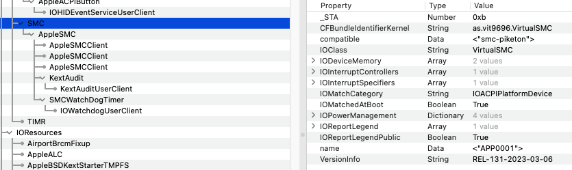

deeveedee Posted March 23, 2023 Author Share Posted March 23, 2023 (edited) EDIT: I am currently running with VirtualSMC.kext and boot-arg vsmcgen=1. It's very early in my testing, but boot-arg vsmcgen=1 does appear to have fixed the boot problem with VirtualSMC.kext. I'll report back again after I have more evidence. I'd still be interested in knowing what this boot-arg does. This issue is documented here. I suspect that there should be a clue in IOReg Spoiler ================================== I stumbled upon a post that claimed that users who experience boot issues with VirtualSMC (as I had with this hack) may be able to resolve the boot problem by specifying boot-arg vsmcgen=1. This boot-arg is documented here, but the purpose of vsmcgen=1 is still not clear to me. Does anyone know why specifying boot-arg vsmcgen=1 may permit use of VirtualSMC.kext with this legacy hack? I'll be testing this as soon as I get a chance. Edited March 24, 2023 by deeveedee 1 Link to comment Share on other sites More sharing options...

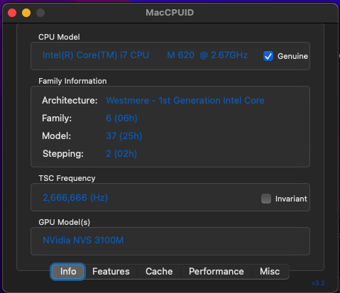

deeveedee Posted March 23, 2023 Author Share Posted March 23, 2023 If you're looking for a CPU-Z-like tool for your legacy hack, Intel's MacCPUID tool runs on this hack. Intel MacCPUID Spoiler 1 Link to comment Share on other sites More sharing options...

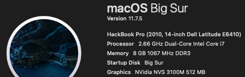

deeveedee Posted March 24, 2023 Author Share Posted March 24, 2023 I am now reliably booting Big Sur, Monterey and Ventura with VirtualSMC.kext and boot-arg vsmcgen=1. I like occasionally using HWMonitorSMC, so my next posted EFI may include both FakeSMC and VirtualSMC (and associated sensor kexts) in OC/Kexts with one of the two disabled in config.plist. Link to comment Share on other sites More sharing options...

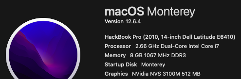

deeveedee Posted March 29, 2023 Author Share Posted March 29, 2023 (edited) I upgraded to Monterey 12.6.4 and was expecting an uneventful upgrade since I was staying with Monterey. Not so. While the unattended upgrade completed smoothly, the upgraded Safari was blank when browsing various websites. I needed to apply OCLP 0.6.3 [DEV] nightly-build post-install patches in order to resolve the upgraded Safari issue. After applying the 0.6.3 patches, all appears to be working well with Monterey 12.6.4. About this hack: Monterey 12.6.4 Spoiler EDIT: I upgraded to Big Sur 11.7.5 and applied OCLP 0.6.3 [DEV] nightly-build post-install patch. Big Sur still works perfectly on this hack. About this hack: Big Sur 11.7.5 Spoiler EDIT2: I'm staying with Ventura 13.2.1 (not upgrading to 13.3) after reading numerous posts about challenges with legacy Macs. Monterey is still my production baseline, so I don't feel the need to be a hero with Ventura. Xcode 14.3 will require Ventura (not supported in Monterey), so I will need to take the plunge when Xcode 14.3 is officially released. Edited March 31, 2023 by deeveedee 1 Link to comment Share on other sites More sharing options...

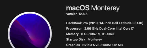

deeveedee Posted April 11, 2023 Author Share Posted April 11, 2023 (edited) Upgraded this old hack to Monterey 12.6.5. Patched with OCLP 0.6.3 [RELEASE] and booting with OC 0.9.1. About this hack: Monterey 12.6.5 Spoiler Edited April 12, 2023 by deeveedee Link to comment Share on other sites More sharing options...

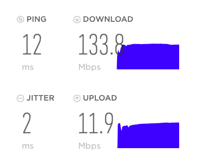

deeveedee Posted April 13, 2023 Author Share Posted April 13, 2023 It's been so long since I switched from Windows to macOS on this Dell Latitude E6410, that I forgot about the basic problems that this laptop had with Windows. I needed Windows 7 for some testing and installed an old SSD in this laptop to run Windows 7. When running Windows 7, this laptop doesn't sleep reliably. This hack runs macOS better than it runs Windows. 1 Link to comment Share on other sites More sharing options...

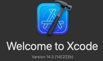

deeveedee Posted April 14, 2023 Author Share Posted April 14, 2023 XCode 14.3 installed without any problems on this HackBookPro6,2 running Ventura 13.2.1 Link to comment Share on other sites More sharing options...

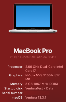

deeveedee Posted April 15, 2023 Author Share Posted April 15, 2023 (edited) I performed a clean installation of Ventura 13.3.1 and it is working well. My previous attempt to run 13.3.1 had been an upgrade from Monterey to 13.2.1 and then an upgrade to 13.3.1. With a clean install (patched with OCLP 0.6.3 and booting with OC 0.9.1), Ventura 13.3.1 appears to be running well on this hack. About this hack: Ventura 13.3.1 Spoiler EDIT: Bluetooth pairs easily with Bluetooth speaker and sound quality is excellent. XCode 14.3 installed without issues. So far, Ventura 13.3.1 appears to be "perfect" on this hack. EDIT2: MS Office 2019 installed without issues. PowerPoint slideshow mode works. Edited April 15, 2023 by deeveedee 1 Link to comment Share on other sites More sharing options...

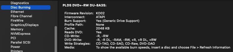

deeveedee Posted April 19, 2023 Author Share Posted April 19, 2023 (edited) I needed to access images on a DVD, so I swapped my second SSD for the CD/DVD drive in the aux bay. The CD/DVD drive works perfectly in Ventura 13.3.1. Continuing to be amazed by this hack. System Report: Disc Burning Spoiler Edited April 19, 2023 by deeveedee Link to comment Share on other sites More sharing options...
