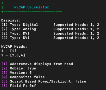

NVCAP Calculator - revised values
Spoiler

Putting this question out there for someone who knows much more than I do about NVCAP (possibly @1Revenger1).  After modifying my NVCAP as stated here to add the two DVI ports to HEAD 2, I found that my laptop would boot to a dark screen (internal laptop display is dark) without hda-gfx property defined in GFX0 IOReg (which I can achieve by defining hda-gfx in my GFX0._DSM ACPI patch).  I stumbled upon this discovery (for me) purely by accident.  It doesn't matter whether I define hda-gfx as "onboard-1" or "onboard-2" and seems to only matter that it is defined.  It appears to me that, with the additional display ports added to HEAD 2 and without defining hda-gfx, the dGPU does not choose the internal laptop display as the boot display.
Can anyone explain this hda-gfx / NVCAP behavior?
Edited by deeveedee
32 minutes ago, deeveedee said:
Putting this question out there for someone who knows much more than I do about NVCAP (possibly @1Revenger1).  After modifying my NVCAP as stated here to add the two DVI ports to HEAD 2, I found that my laptop would boot to a dark screen (internal laptop display is dark) without hda-gfx property defined in GFX0._DSM.  I stumbled upon this discovery (for me) purely by accident.  It doesn't matter whether I define hda-gfx as "onboard-1" or "onboard-2" and seems to only matter that it is defined.  It appears to me that, with the additional display ports added to HEAD 2 and without defining hda-gfx, the dGPU does not choose the internal laptop display as the boot display.
Try force-online data 01000000.
@Stefanalmare Is that a WhateverGreen property or a macOS property?  I'm not using WhateverGreen (patching is complete in my SSDT-GFX0 after my change here).  My hack works great with my new NVCAP and hda-gfx, I'm just wondering if anyone can explain why hda-gfx must be defined with my new NVCAP.

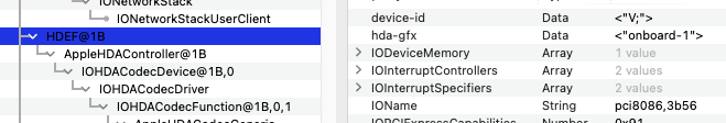

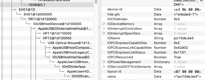

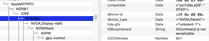

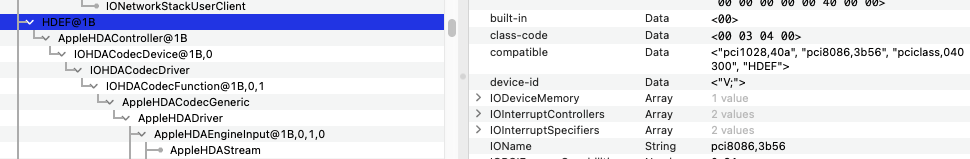

I'm still trying to figure out why naming pci10de,be3 -> HDAU causes significant boot delays (because AppleHDA detects HDAU).  As I investigate this, I found something that is confusing me:  HDEF and pci10de,be3 audio are forced to have property hda-gfx="onboard-1" no matter what I do to patch ACPI.  I would think that HDEF would have property hda-gfx="onboard-1" and pci10de,be3 would have hda-gfx="onboard-2" but any attempt that I make with ACPI patching to set hda-gfx="onboard-2" results in hda-gfx="onboard-1" in IOReg.  Note that if I attempt to set HDEF's hda-gfx="onboard-2," something is forcing it to hda-gfx="onboard-1"
Can anyone confirm that the two audio devices should have different hda-gfx values ("onboard-1" and "onboard-2") and if so, what could be forcing both audio devices to have the same hda-gfx="onboard-1" value?  Could it be because I don't have Intel iGPU and only have a single enabled graphics device?
For the attached screen shots, I am injecting WhateverGreen.kext (which my Nvidia patching makes unnecessary and WhateverGreen.kext only renames AGP.VID to AGP.GFX0 and it makes no difference regarding the value of hda-gfx) and I am naming pci10de,be3 to HDMI (a cosmetic renaming via SSDT that attempts to set hda-gfx="onboard-2").  My SSDT-HDMI is attached.
GFX0 IOReg (hda-gfx = "onboard-1")
Spoiler
HDEF IOReg (hda-gfx = "onboard-1")
Spoiler
HDMI (pci10de,be3) IOReg (hda-gfx = "onboard-1")
Spoiler
SSDT-HDMI (cosmetic naming of pci10de,be3 -> HDAU, unsuccessfully attempts to set hda-gfx="onboard-2")
SSDT-HDMI.aml.zip
EDIT: My original OC EFI for this hack includes SSDT-IGPU which sets IGPU._STA=0.  This is unnecessary, since the iGPU is already disabled (only Nvidia dGPU is enabled).  I have removed SSDT-IGPU from my current EFI since it doesn't do anything.  As expected, there is no change in IOReg (including no change in hda-gfx values) and no change in system behavior.
EDIT2: If I drop my SSDT-HDEF (allowing AppleALC to perform exclusive patching of HDEF), AppleALC does not assign a value of hda-gfx to HDEF IOReg.
Spoiler
