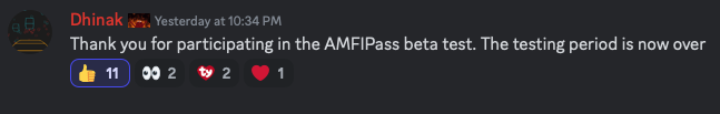

deeveedee Posted July 26, 2023 Author Share Posted July 26, 2023 The OCLP-AMFIPass Beta period has ended, so hopefully this means that the next release of OCLP includes AMFIPass (AMFI and Library Validation enabled). 1 Link to comment Share on other sites More sharing options...

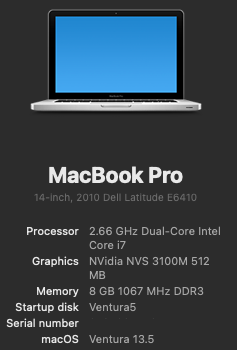

deeveedee Posted July 27, 2023 Author Share Posted July 27, 2023 (edited) I am testing a clean install of Ventura 13.5 with OCLP 0.6.8 in a new APFS volume (leaving my other volumes untouched). Ventura 13.5 has fixed the Microsoft Remote Desktop "clipping" issue that appeared in Ventura 13.4x. So far, Ventura 13.5 with OCLP 0.6.8 appears to be a winning combination on this old HackBookPro6,2. About This Hack: Ventura 13.5 (OCLP 0.6.8, OC 0.9.3, AMFI & LV Enabled, AMFIPass.kext 1.3.1, RestrictEvents.kext 1.1.2, revpatch=sbvmm) Spoiler Edited July 27, 2023 by deeveedee 2 Link to comment Share on other sites More sharing options...

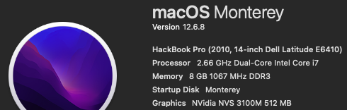

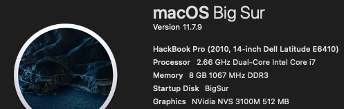

deeveedee Posted July 28, 2023 Author Share Posted July 28, 2023 (edited) The OCLP Devs have once again done an amazing job with the release of OCLP 0.6.8. I am currently running Big Sur 11.7.9, Monterey 12.6.8 and Ventura 13.5 all booting with a single OC 0.9.3 EFI and all patched with OCLP 0.6.8 post-install patches. My EFI includes RestrictEvents.kext 1.1.2 (with revpatch=sbvmm, no VMM kernel patches) and BrcmPatchRAM 2.6.8 [Dev] kexts. AMFI and LV is enabled (with AMFIPass.kext 1.3.1) and remained enabled during each macOS OTA upgrade. Big Sur, Monterey and Ventura are working extremely well on this 2010 Dell Latitude E6410. The transition from OCLP-AMFIPass-Beta4 to OCLP 0.6.8 was virtually flawless. Well done, Devs! About This Mac: Big Sur 11.7.9 Spoiler About This Mac: Monterey 12.6.8 Spoiler About This Mac: Ventura 13.5 Spoiler The only "hiccup" I experienced during the OTA upgrades was that during the Monterey upgrade (from 12.6.7 to 12.6.8), Open Core boot picker did not automatically choose the "macOS Installer" menu item after the first Monterey installer reboot. I needed to manually select "macOS Installer" from the menu and then the rest of the Monterey 12.6.8 upgrade proceeded without issues. Edited July 28, 2023 by deeveedee 1 Link to comment Share on other sites More sharing options...
