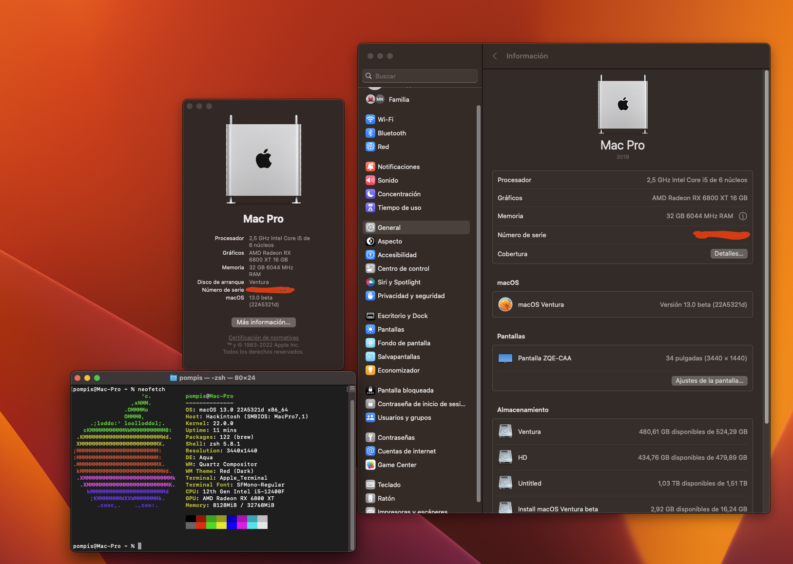

Slice Posted July 29, 2022 Share Posted July 29, 2022 2 hours ago, PoMpIs said: Yes, come back, I bought it... It returns to me like this: The awakening of sleep... and after a few minutes this appears again: But I still don't have any abnormal CPU usage caused by powerd for an hour... After an hour I already notice the increase in CPU usage caused by powerd.. I have these running every time I wake up "sudo pmset schedule cancelall" 🤷♂️ @miliuco @5T33Z0 I only see this in system settings: Do you have any other option? I have I glad to report that FileVault technology works in Ventura beta 4 with recent Clover. Details in Clover General Discussion and will be in instructions later. 7 Link to comment Share on other sites More sharing options...
PoMpIs Posted July 29, 2022 Share Posted July 29, 2022 (edited) 2 hours ago, Extreme™ said: I have exactly the same options as you in Energy Saver: but I still have the problem. So it doesn't depend on options in Energy Saver. I have tried to disable "time of use" and it no longer consumes CPU "powerd" when waking up from sleep even with this on power And the sleep is still working, and I do not have the CPU at full frequency @miliuco Edited July 29, 2022 by PoMpIs 6 Link to comment Share on other sites More sharing options...

Extreme™ Posted July 29, 2022 Share Posted July 29, 2022 24 minutes ago, PoMpIs said: I have tried to disable "time of use" and it no longer consumes CPU "powerd" when waking up from sleep even with this on power And the sleep is still working, and I do not have the CPU at full frequency @miliuco Thanks for the tip! As soon as I'm home I try…👌 1 Link to comment Share on other sites More sharing options...
PoMpIs Posted July 29, 2022 Share Posted July 29, 2022 53 minutes ago, Extreme™ said: Thanks for the tip! As soon as I'm home I try…👌 Well, mine an hour later is still working normally with "time of use" disabled... 👍 1 Link to comment Share on other sites More sharing options...

Extreme™ Posted July 29, 2022 Share Posted July 29, 2022 13 minutes ago, PoMpIs said: Well, mine an hour later is still working normally with "time of use" disabled... 👍 I confirm. The first test ended positively. Usage time disabled: the compuer went to sleep as scheduled. After about an hour of sleep, upon awakening the CPU is no longer under stress in idle with temperatures outside the norm. 👍 1 1 Link to comment Share on other sites More sharing options...
