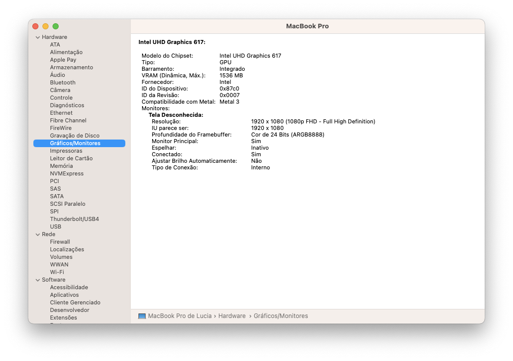

PC IT Posted July 28, 2022 Share Posted July 28, 2022 Thank you for al your support in helping me finding a solution to this ancient lcd big panel, it is working properly with full qc, the trick which did it is @aben suggestion to add these lines,   framebuffer-patch-enable  DATA   01000000 framebuffer-con0-enable   DATA   01000000 framebuffer-con0-alldata  DATA   00000800 02000000 90000000 Thanks to Herv'e who found the internal display on (con0), As Aben mentioned that the sequence basically drops LVDS connector flag CNConnectorAlwaysConnected, which forces built-in displays as external. Known to have fixed certain problematic eDP connectors in the past When added these lines, the display worked, i changed the display flag from 90000000 to 98000000 and it worked perfectly in both Monterey and Ventura.  Thanks to @deeveedee for raising my issue properly I am still having problems: 1: Airplay not working at all, i have apple tv and using AirportItlwm kext, airplay is working perfectly on Monterey 2:Display never wake after sleep esp if closing the lid, it keep dimmed-black. 3:Mac os installer and recovery work just in vesa mode. 4:Can we make a small ssdt containing these display flags to for kbl spoofing that it may help other who are having troubles to solve the problem? I want to thank you for all your support to me that solved my problem which last for about 2 months without successful booting, i was on Montery and using Ventura on vesa mode. i will post my working efi for this model so it may help others solve their problems without changing the display to a new fhd one. i need a small ssdt for this display including the flags if that is possible, I updated the system to beta 4 and it is working with only the above mentioned problems, wishing we will be able to find any solutions asap  Attached is my EFI forlder to help others in this issue.  Thank you so much  SKYLAKE EFI.zip 5 Link to comment Share on other sites More sharing options...
SavageAUS Posted July 28, 2022 Share Posted July 28, 2022 Update not showing for me on my laptop here in Australia. Sent from my iPhone using Tapatalk 2 Link to comment Share on other sites More sharing options...
aben Posted July 28, 2022 Share Posted July 28, 2022 4 hours ago, PC IT said: Thank you for al your support in helping me finding a solution to this ancient lcd big panel, it is working properly with full qc, the trick which did it is @aben suggestion to add these lines,   framebuffer-patch-enable  DATA   01000000 framebuffer-con0-enable   DATA   01000000 framebuffer-con0-alldata  DATA   00000800 02000000 90000000 As Aben mentioned that the sequence basically drops LVDS connector flag CNConnectorAlwaysConnected, which forces built-in displays as external. Known to have fixed certain problematic eDP connectors in the past When added these lines, the display worked, i changed the display flag from 90000000 to 98000000 and it worked perfectly in both Monterey and Ventura. Awesome! Good to know the above suggestion to patch LVDS connector flags helped solve your display issue finally. Congrats and enjoy  Please note that this approach is a mere workaround to this incompatibility situation with your panel when using KBL framebuffers, and as such should not be considered a native solution for a built-in display, until a proper/more meaningful patch that addresses this issue has been implemented. It's still best recommended to upgrade panel to FHD, if possible, to achieve full proper/native functionality of LVDS panels when using macOS framebuffers untouched, otherwise you'll be forced to compromise on native LVDS features such as backlight control, lid wake/Sleep etc.  Also, display specifications are not defined at UEFI/ACPI level, only EDID which is accessed from EEPROM and thus not possible to deploy SSDTs for such patches, only via kernel space. 2 Link to comment Share on other sites More sharing options...

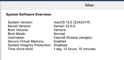

Slice Posted July 28, 2022 Share Posted July 28, 2022 KabyLake graphic <-> MacPro ??? 2 Link to comment Share on other sites More sharing options...
Cyberdevs Posted July 28, 2022 Share Posted July 28, 2022 @Slice I'm using this rig as a test bench for Ventura and I have an old R9 270X in the system which is only active on Monterey and below so yeah MacPro is a suitable SMBIOS (in regard of using the same PlatformInfo) for my tests if I use iMac18,3 the colors are messed up and only working SMBIOSes are iMac18,1, macMini8,1 and MacPro7,1 other than these settings the display settings are not working properly. 5 Link to comment Share on other sites More sharing options...
Slice Posted July 28, 2022 Share Posted July 28, 2022 I am opposite. Set SMBIOS iMac17,1 having RX570 and IGPU switched off in BIOS. 1 Link to comment Share on other sites More sharing options...
