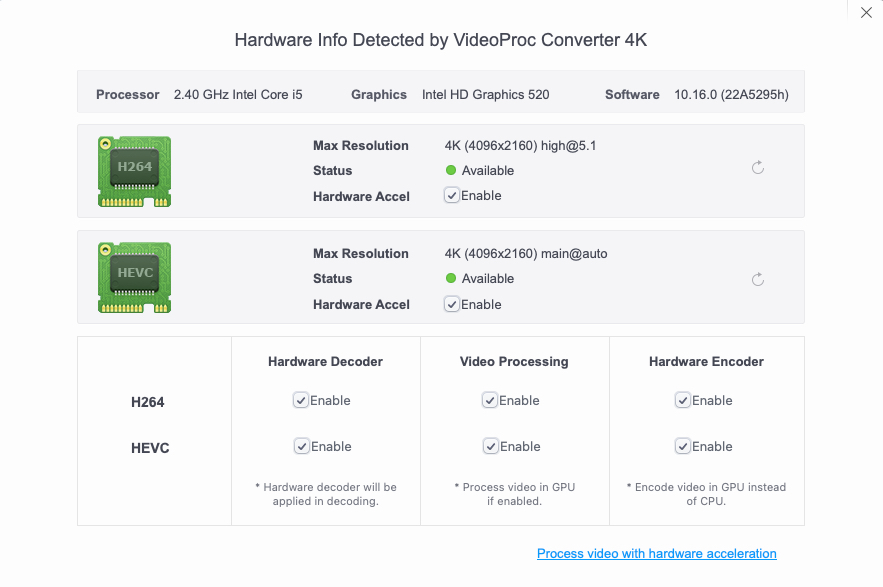

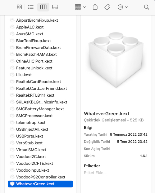

7 hours ago, aben said:
New development for Skylake users:
As tested and observed, currently (as of beta 2) it is possible to achieve iGPU acceleration on SKL with help of KBL kexts/profiles (spoofing) however this came with caveats, as expected; specifically with regards to codec(s) hw-decode support. The first noticeable issue was YouTube-playback on Safari, which was resolved by simply dropping the VP9 flag from the KBL profile, since SKL does not have VP9 hw-decode support. All credits to @dhinakg and @PMheart for their collaborative work implementing a robust patch into WEG while maintaining KBL kexts untouched as possible.
Upon further testing, it seems there is actually one more codec-related issue still lurking; this time with HEVC encoded playback  even though VideoProc/VDADecoderChecker do report "full" acceleration status (enc/dec) for HEVC codec. Those spoofing to KBL may test this out by playing a HEVC encoded video via VLC, QuickTime Player etc. you should see garbled/half green frames.
After performing a few tests over the past week, I was able to track down the problematic HEVC flag in KBL profile that causes this incompatibility with HEVC playback on SKL and managed to implement a working patch in a test branch of WEG that fixes this issue. I must admit the code implemented is not exactly perfect but it does the job as far as my testing goes; no more HEVC codec issues seen.
SKL users on Ventura may choose to test below attached WEG 1.6.1 SOLELY for testing HEVC related issues or as a temporary solution while waiting for official support from Acidanthera members. CC @PMheart
Not works for me. System freezes on YouTube
