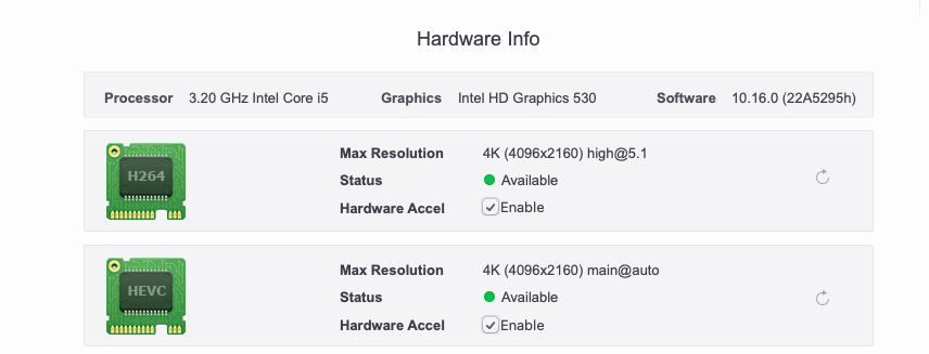

As tested and observed, currently (as of beta 2) it is possible to achieve iGPU acceleration on SKL with help of KBL kexts/profiles (spoofing) however this came with caveats, as expected; specifically with regards to codec(s) hw-decode support. The first noticeable issue was YouTube-playback on Safari, which was resolved by simply dropping the VP9 flag from the KBL profile, since SKL does not have VP9 hw-decode support. All credits to @dhinakg and @PMheart for their collaborative work implementing a robust patch into WEG while maintaining KBL kexts untouched as possible.
Upon further testing, it seems there is actually one more codec-related issue still lurking; this time with HEVC encoded playback  even though VideoProc/VDADecoderChecker do report "full" acceleration status (enc/dec) for HEVC codec. Those spoofing to KBL may test this out by playing a HEVC encoded video via VLC, QuickTime Player etc. you should see garbled/half green frames.
After performing a few tests over the past week, I was able to track down the problematic HEVC flag in KBL profile that causes this incompatibility with HEVC playback on SKL and managed to implement a working patch in a test branch of WEG that fixes this issue. I must admit the code implemented is not exactly perfect but it does the job as far as my testing goes; no more HEVC codec issues seen.
SKL users on Ventura may choose to test below attached WEG 1.6.1 SOLELY for testing HEVC related issues or as a temporary solution while waiting for official support from Acidanthera members. CC @PMheart

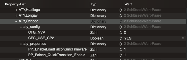

Hi - can you post your config.plist after removing your personal data so that I can make a comparison to my own because even though I use the above command script, I am not getting the same results as you. Thanks.
Good morning.
This is what I have in deviceProperties related to the Intel 630. Nothing related to the AMD (really I have agdpmod=pikera needed for my 6600 but not for your 580). iMac19,1 SMBIOS. iGPU enabled (not Auto) in BIOS.
Spoiler
After running defaults write com.apple.ActivityMonitor ShowGPUTab -bool true both GPU are in the new GPU tab and both are built-in.
Spoiler
Show me your current config.plist.
Sure thing Bro - See attached, actually I managed to change mine thanks to @5T33Z0 for the GPU Tab script,  @FirstTimeCustomac for posting his example, so mine now says both are Built-in, but I discovered I can also make UHD 630 Built-in and the RX580 in a designated Slot but settled for both to be Built-in as stated to be the correct configuration by some.
Spoiler
1945689238_Screenshot2022-07-07at12_16_18.png.55b1b7ee8e98285c0f80a5f7a7b97530.png686430047_Screenshot2022-07-07at12_15_58.png.bff9c543d6c1c699ac5b04bbe14e7c3f.png
config.plist
  • Like 5

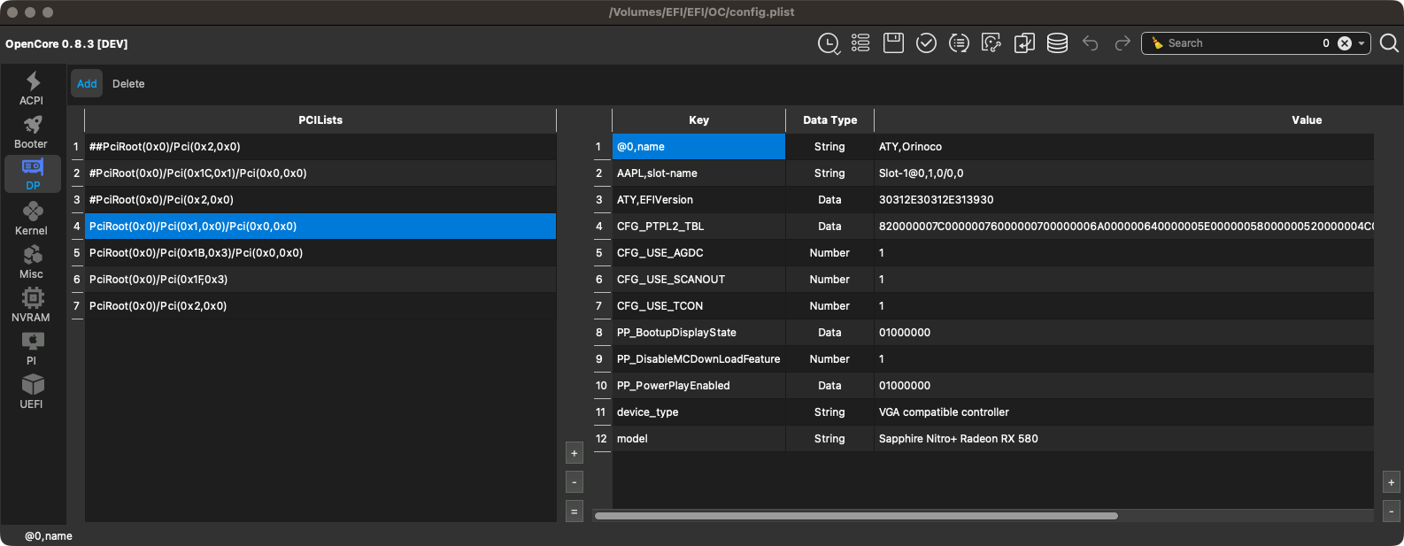

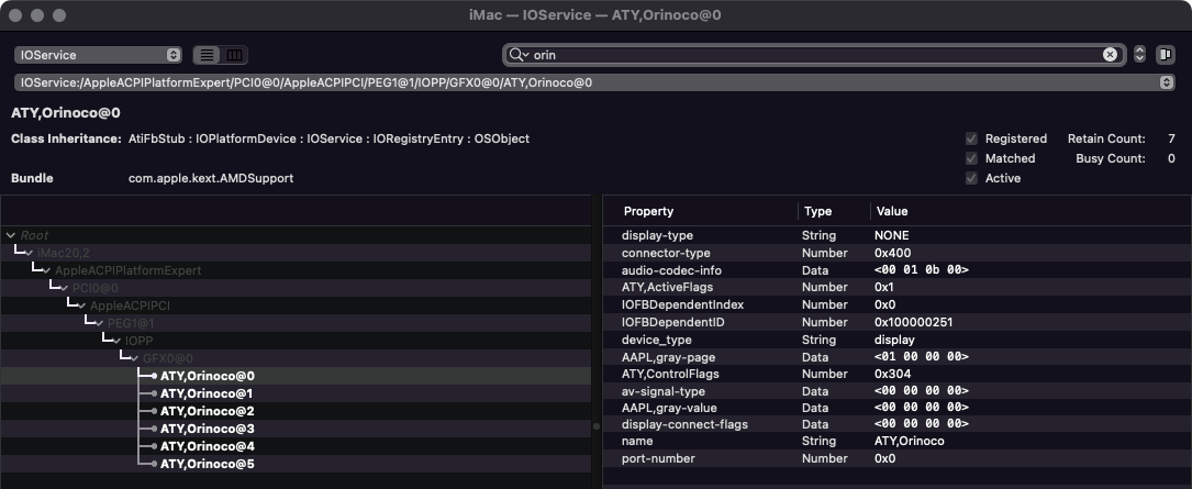

Guest 5T33Z0
@eSaF How did you make the GPU appear to be "Internal"? Side-note:  framebuffer-patch-enable is only required when driving a display, not when using an empty framebuffer.
I don't really know man, I just blindly followed @FirstTimeCustomac posted example and picked out what I thought was relevant to my own (right or wrong) and hoped for the best :). All the info is above.

Green screen is indeed a problem which I heard from users, while I have no idea...
But now thanks! Where may I find your patch?
Not exactly the implementation I was aiming for code-wise. Exhausted all possible attempts to try and drop just the relevant value from the array object without having to drop the entire property, even tried referencing and applying other patching approaches implemented across WEG but all workflows failed. For someone with limited proficiency in C++ this is expected, hence did not bother submitting a PR as well; to Acidanthera my attempts will probably look laughable 😅

Guest ricoc90
Remove AAPL,slot-name from both the iGPU and dGPU.
iGPU properties:
device-id is just cosmetic (to have it show up as uhd 630 rather than "KBL Unknown" and platform-id is a non-headless framebuffer to allow GPU history to actually monitor the iGPU usage (both thanks to @FirstTimeCustomac)
dGPU properties:
Edited by ricoc90
19 minutes ago, aben said:
Here you go: https://github.com/abenraj/WhateverGreen/tree/SKL-HEVC-test
I saw it myself hours ago, thanks anyway. :)
Do we need to remove IOGVAHEVCDecodeCapabilities? Is it confirmed to work?
And I saw another branch where it failed, but you removed it I guess? What were you attempting to do there? I could help write the correct code.
EDIT - Found it in my browser history: https://github.com/abenraj/WhateverGreen/commit/6388b5750f99887598f868493f00c0cb3fde9531
What I guessed was that you wanted to remove `VTSupportedProfileArray` under `IOGVAHEVCDecodeCapabilities`, while keeping the array `IOGVAHEVCDecodeCapabilities` itself; but you failed to write the correct code for that. Did I get it correctly?
You are indeed correct :) More specifically I was aiming to drop the value "2" under "VTSupportedProfileArray" (most likely a reference to profile 2 that's not present on SKL kexts). Just dropping this value fixes the playback issue.
Thanks for letting me know; I will handle it.

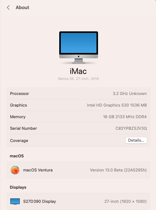

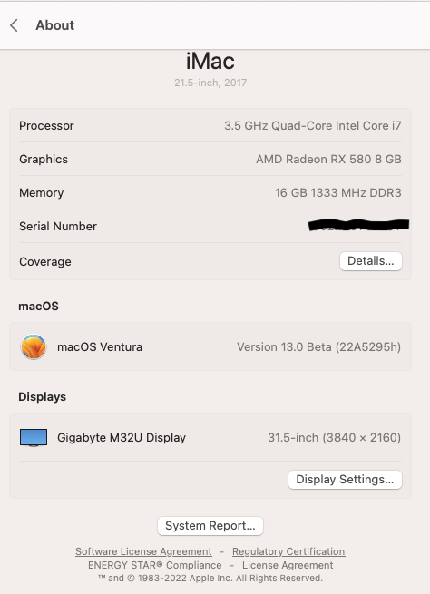

Finally!!! installed on my little Alder Lake
705405461_Capturadepantalla2022-07-07alas14_48_03.thumb.png.c701109cf8bd8db6879d6e96431693eb.png
:drool:
Now I have it installed on Lenovo 520s, it seems that everything is going well at the moment
Thank you very much to all of you who make this possible 🙇‍♂️
  • Like 7

@eSaF
I wold change in your config.plist:
  • AAPL,ig-platform-id from 0300983E to 0300913E
  • device-id ok (device_type and model not needed, included in device-id)
  • framebuffer-patch-enable removed (not needed on headless mode)
  • enable-metal and igfxfw ok
  • added igfxonln=01000000
  • RX580 code not needed, only if you like to see it in System Profiler >> PCI devices list.
  • Like 4
  • Thanks 1
25 minutes ago, aben said:
Auto-sleep is back with Beta 3
Yes,  works fine!! :w00t:
lenovo 520s works too
1554265789_Capturadepantalla2022-07-07alas15_31_52.thumb.png.8c5b0f6019945f6b33c1de722995f949.png
