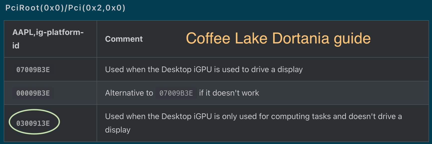

7 minutes ago, ricoc90 said:
@eSaF I think you don't know what I mean. In the mentioned link, the author added a screenshot of their GPU History window. You can see in that window that it shows their iGPU as being in slot 0:
  Reveal hidden contents
1725521099_Schermafbeelding2022-07-04om12_15_59.png.e00f4fa6211c83841a7fad79625aa61b.png
Which correspondents with the results I have. However, on your screenshot your iGPU is being reported as Built In.
I mean it's just cosmetic, so it doesn't really matter but I'm just wondering why that is. :)
So do I, yet it still is being reported as "Slot 0"
Try experimenting with those Entries and see what results you get, I am no expert as you can tell, I just followed the Guide blindly as best as I can and hope for the desired results.

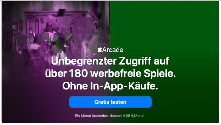

I've been going through the DeviceProperties on a 2020 iMac (iMac20,1) with an Intel Core i7 10700 processor and an AMD Radeon Pro 5500 XT and there's this settings for the iGPU "PciRoot(0x0)/Pci(0x2,0x0)" called "AAPL00,override-no-connect" with the value of:
00FFFFFF FFFFFF00 06107C9C 5E91EE51 161D0104 B53C2260 206FB1A7 554C9E25 0C505400 00000101 01010101 01010101 01010101 01010000 00100000 00000000 00000000 00000000 00000010 00000000 00000000 00000000 00000000 00FC0069 4D61630A 20202020 20202020 00000000 00000000 00000000 00000000 00000153 70137903 00030014 806E0184 FF139F00 2F801F00 3F0B5100 02000400 7F8118FA 10000101 00127631 FC78FBFF 02108862 D3FAF8F8 FEFFFF00 00000000 00000000 00000000 00000000 00000000 00000000 00000000 00000000 00000000 00000000 00000000 00000000 00000000 00000000 00000000 00000000 00000000 0000C790
as DATA type, this might help to shed some light on the display output on iGPU.
I'm not sure if that's gonna do anything on hacks but though worth to share.
With the above configuration and GPU I have only H264 acceleration. With no GPU I don't have light.......... With this configuration and #AAPL00,override-no-connect comented I have what I attached:

@ricoc90 - Hiya, after cleaning up the what I think is unnecessary entries in Device Properties, this is how the readout on my rig looks. Must admit the 'Built-In' one on the UHD Graphics 630 was more pleasing to see but it is more in line to your own.
Spoiler
856002757_Screenshot2022-07-04at22_47_18.png.31502c60c86a0d0038d418cf28c396d8.png881707180_Screenshot2022-07-04at22_47_40.png.08be2ef1e264da62188caa9c39c5734f.png
