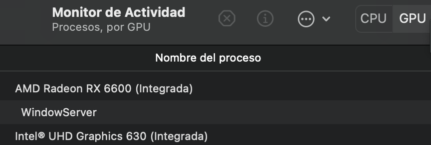

eSaF Posted July 4, 2022 Share Posted July 4, 2022 6 hours ago, ricoc90 said: As it's the default behaviour on genuine imac20,1. You can verify this by firing up Activity monitor and go to GPUs: What the heck??!! GPU is not showing in Activity Monitor. Spoiler 1 Link to comment Share on other sites More sharing options...
Guest ricoc90 Posted July 4, 2022 Share Posted July 4, 2022 53 minutes ago, eSaF said: What the heck??!! GPU is not showing in Activity Monitor. That's weird. What is cmd+4 showing? Link to comment Share on other sites More sharing options...
eSaF Posted July 4, 2022 Share Posted July 4, 2022 21 minutes ago, ricoc90 said: That's weird. What is cmd+4 showing? This: 1 Link to comment Share on other sites More sharing options...

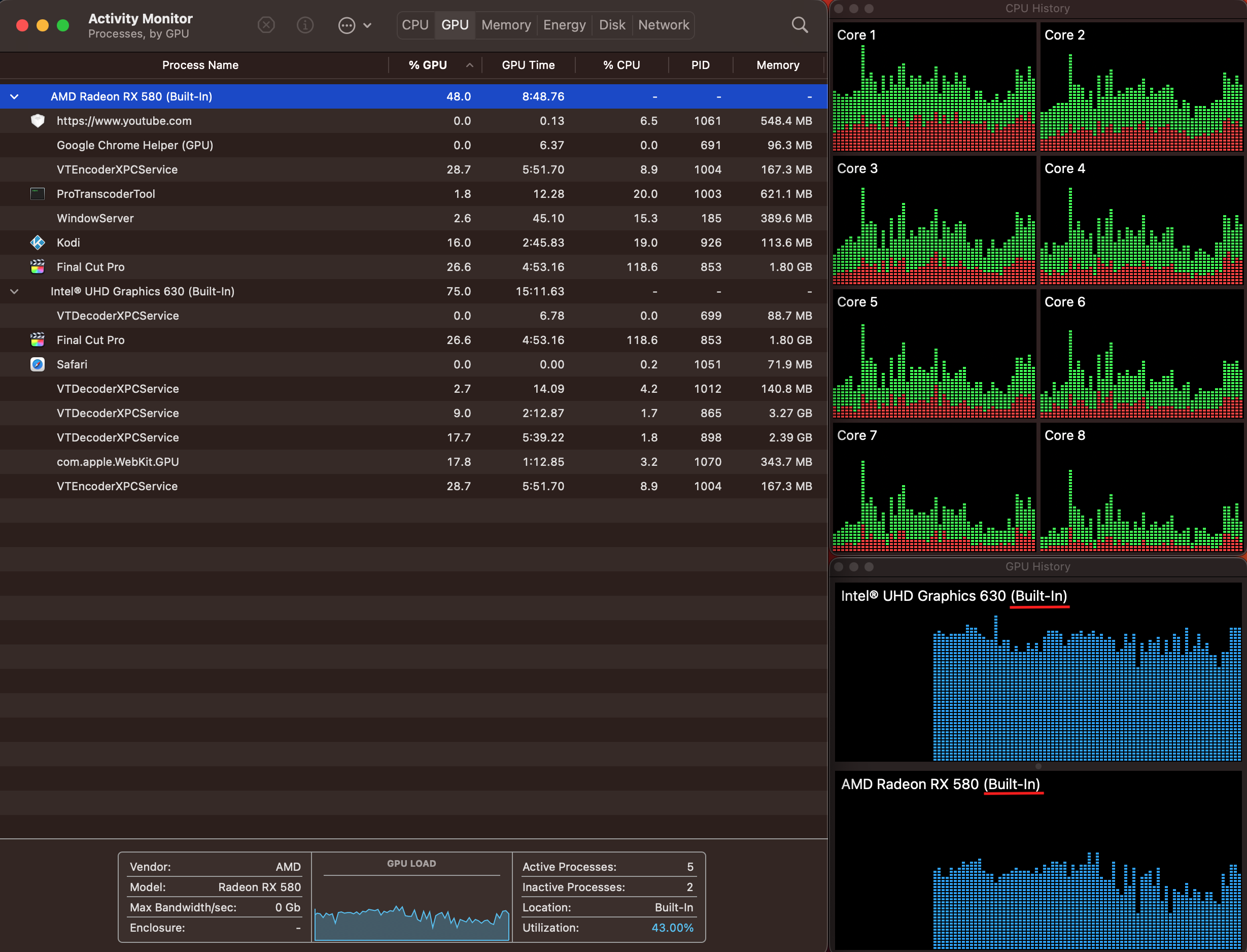

eSaF Posted July 4, 2022 Share Posted July 4, 2022 Ok I think I am making progress, this is what I have so far (attached) but I am assuming I have to do some patching to rectify KBL Unknown, as far as I understand it is just cosmetic but hey I got this far so I might as well dig some more and go deeper. Spoiler 2 Link to comment Share on other sites More sharing options...

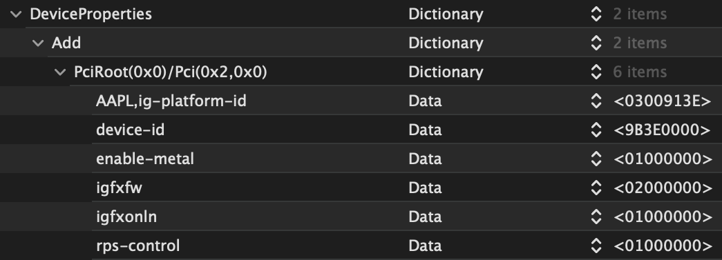

eSaF Posted July 4, 2022 Share Posted July 4, 2022 8 minutes ago, ricoc90 said: Indeed it is only cosmetic. If you do wish to have it reported as uhd 630 you’d need to fake it’s device id I think I am getting bogged down a little, can you post a screen shot of your Device Properties pertaining to the Entries so that I can make a comparison to what I have achieved so far? I would appreciate that very much. Thanks. Link to comment Share on other sites More sharing options...
Guest ricoc90 Posted July 4, 2022 Share Posted July 4, 2022 (edited) 1 hour ago, eSaF said: I think I am getting bogged down a little, can you post a screen shot of your Device Properties pertaining to the Entries so that I can make a comparison to what I have achieved so far? I would appreciate that very much. Thanks. Sure! RX 580: Spoiler UHD 630: Spoiler Edit: I forgot to mention that in order for the iGPU to show up, you'd need to define a slot-name as well. I had removed it from mine Edited July 4, 2022 by ricoc90 Link to comment Share on other sites More sharing options...
eSaF Posted July 4, 2022 Share Posted July 4, 2022 Ok I think I've reached the desired effect (attached). Have to give big thanks to @vit9696 for pointing to the link detailing how it's done, @ricoc90 for making it all understandable. All I need is to do a clean up of the Device Properties and keep what I think is necessary and I am done. Spoiler 3 Link to comment Share on other sites More sharing options...

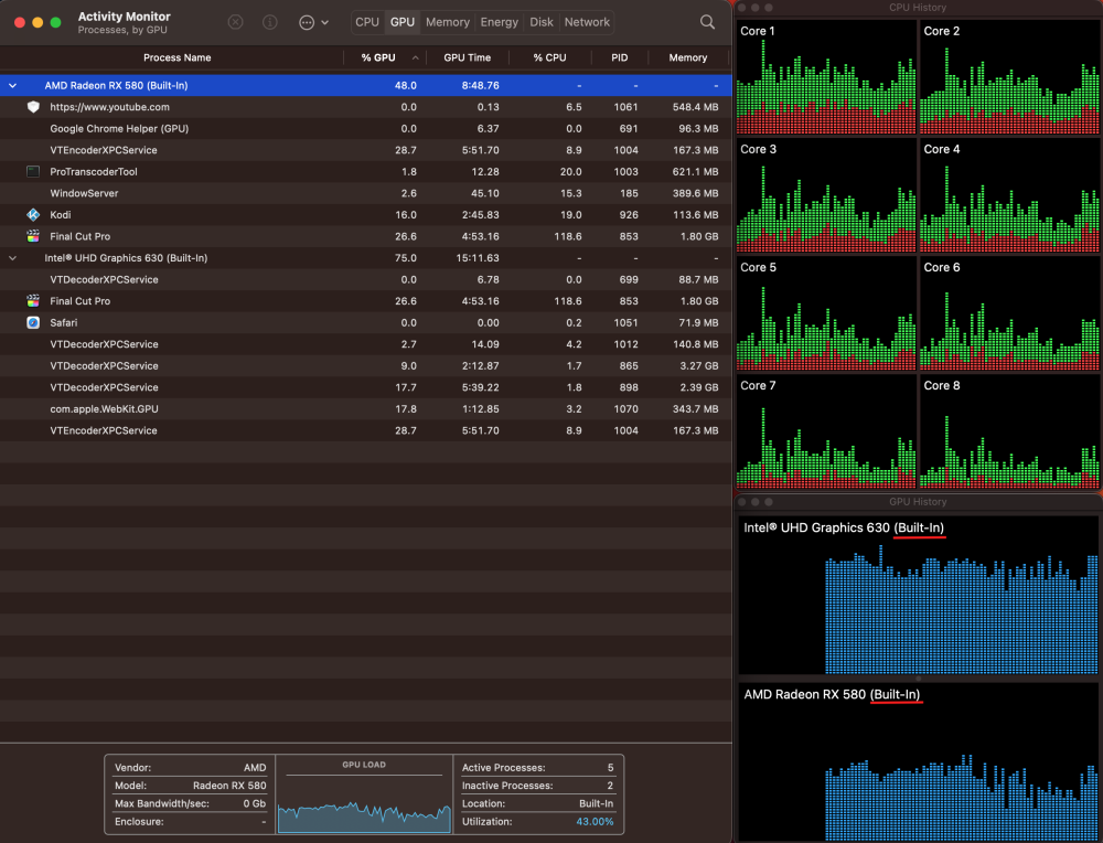

eSaF Posted July 4, 2022 Share Posted July 4, 2022 6 minutes ago, ricoc90 said: Mind to share Screenshots of its Device Properties? No problem - Note still in the realms of a clean up but the important bits are there. 1 Link to comment Share on other sites More sharing options...

eSaF Posted July 4, 2022 Share Posted July 4, 2022 (edited) 12 minutes ago, ricoc90 said: How did you manage to get it being reported as being "built in"? I used Hackintool to determined all Devices correctly in the PCIe tab, the link I posted above explains it all. I copied all the Device Properties generated by Hackintool into my config.plist as they appeared exactly. PS - I didn't rename the Slots whereas maybe you did, I just left it as default as generated by Hackintool (see attached) Spoiler Edited July 4, 2022 by eSaF Link to comment Share on other sites More sharing options...
