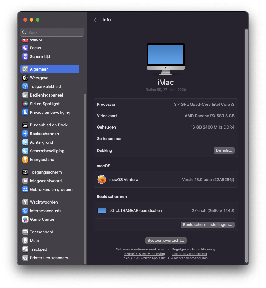

Guest ricoc90 Posted June 21, 2022 Share Posted June 21, 2022 (edited) Yeah, I'm a little late to the party. Haven't done anything hackintosh-related in the past 3-ish years, but a certain moderator on this forum who's name shall not be mentioned (starts with C and ends with yberdevs) kept tempting me to come back (j/k), so I decided to give it a go. Everything runs pretty well so far Cpu: i3-10105F (no iGPU) Mobo: ASRock h510m-hdv m.2 Memory: G.Skill 8GB DDR4 2400MHz dGpu: RX 580 8GB Lan: Intel I219V14 Wifi: Archer T6E Bluetooth: Asus BT400 USB dongle Sound: Realtek ALC897 Edited June 21, 2022 by ricoc90 English should be forbidden Link to comment Share on other sites More sharing options...
