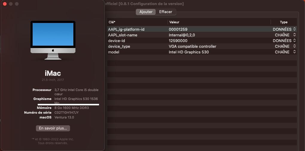

ichelash Posted June 19, 2022 Share Posted June 19, 2022 It’s official ventura has won the battle 😂😂 skylake intel HD 530 has refused to work @Cyberdevs 1 Link to comment Share on other sites More sharing options...
Cyberdevs Posted June 19, 2022 Share Posted June 19, 2022 Just now, ichelash said: It’s official ventura has won the battle 😂😂 skylake intel HD 530 has refused to work @Cyberdevs That beats me! post the EFI that you are using and I will double check the settings. At this point i need to cross examine the settings. Link to comment Share on other sites More sharing options...

ichelash Posted June 19, 2022 Share Posted June 19, 2022 6 minutes ago, Cyberdevs said: That beats me! post the EFI that you are using and I will double check the settings. At this point i need to cross examine the settings. Here it is. Installation process went smoothly, the issue arise when in post installation I add the device properties EFI.zip Link to comment Share on other sites More sharing options...
Cyberdevs Posted June 19, 2022 Share Posted June 19, 2022 6 minutes ago, ichelash said: the issue arise when in post installation I add the device properties Yes the issue is that you are not using the correct version of WhateverGreen. I told you several times already you need a very specific build of WEG because they have rolled back the SKL-->KBL spoofing because of the "Booting into Recovery Mode" issue but in your EFI folder you are using the version of the WEG which already has that setting removed. Replace the WhateverGreen.kext with this one and it should work. WhateverGreen.kext.zip 4 1 1 Link to comment Share on other sites More sharing options...

Guest 5T33Z0 Posted June 19, 2022 Share Posted June 19, 2022 (edited) Like I said 3 times already now: there's an extra branch for Whatevergreen which supports the Skylake graphics spoofing https://github.com/acidanthera/WhateverGreen/actions/runs/2525205346 Edited June 19, 2022 by 5T33Z0 Link to comment Share on other sites More sharing options...
ichelash Posted June 19, 2022 Share Posted June 19, 2022 10 minutes ago, Cyberdevs said: Yes the issue is that you are not using the correct version of WhateverGreen. I told you several times already you need a very specific build of WEG because they have rolled back the SKL-->KBL spoofing because of the "Booting into Recovery Mode" issue but in your EFI folder you are using the version of the WEG which already has that setting removed. Replace the WhateverGreen.kext with this one and it should work. WhateverGreen.kext.zip 216.68 kB · 0 downloads On it 1 Link to comment Share on other sites More sharing options...

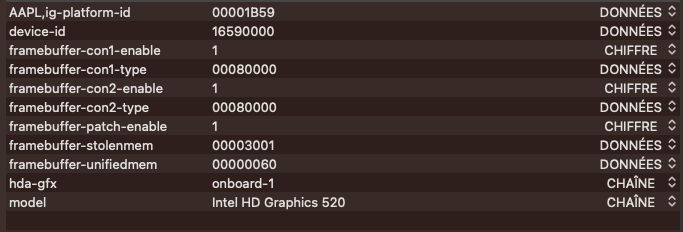

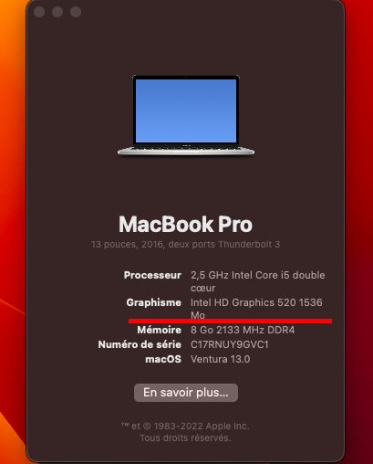

aben Posted June 20, 2022 Share Posted June 20, 2022 (edited) Latest commits to WEG branch 'skl-as-kbl-13' drops the use of codeless KBL kext + includes proper implementation of patch to drop VP9 codec support for SKL when spoofing to KBL; this change automatically fixes the recovery/installer boot issues as well. (IMPORTANT: It is still NECESSARY to fake 'device-id' and choosing appropriate KBL 'ig-platform-id' for proper acceleration on SKL) Thank you @dhinakg and @PMheart for the final touches/improvements which now allows proper functioning when spoofing SKL to KBL, especially on macOS 13. NOTE: The above WEG branch also introduces a new WEG boot-arg: -igfxsklaskbl (not required on macOS 13) which can be used for testing SKL spoof to KBL on older macOS versions. Thanks @PMheart for pointing that out. Attaching RELEASE build of WEG for others to test WhateverGreen-1.6.0-RELEASE.zip Edited June 20, 2022 by aben Added note about boot-arg requirement for macOS 13 1 2 Link to comment Share on other sites More sharing options...

greythorne Posted June 20, 2022 Share Posted June 20, 2022 39 minutes ago, aben said: Latest commits at WEG branch 'skl-as-kbl-13' replaces injector kext with introduction of WEG boot-arg: -igfxsklaskbl which now fixes the recovery/installer boot issue while dropping VP9 support on SKL. Thank you @dhinakg and @PMheart for the final touches/improvements to macOS 13 progress on SKL. Attaching RELEASE build of WEG just incase WhateverGreen-1.6.0-RELEASE.zip 537.09 kB · 1 download Hello, So need to install this WEG in Monterey 12.4 and use the boot argument igfxsklaskbl prior to starting an in-place upgrade? 4 minutes ago, Aguys said: Got Ventura running on my Acer V5-471G (Ivy Bridge)🙂 but yeah, no acceleration. Use the latest version of WEG and the boot argument as mentioned by @aben Link to comment Share on other sites More sharing options...
aben Posted June 20, 2022 Share Posted June 20, 2022 (edited) On 6/20/2022 at 10:31 AM, greythorne said: So need to install this WEG in Monterey 12.4 and use the boot argument igfxsklaskbl prior to starting an in-place upgrade? Replied to your PM. config.plist.zip Edited June 22, 2022 by aben 1 Link to comment Share on other sites More sharing options...
The Tech Posted June 20, 2022 Share Posted June 20, 2022 1 hour ago, aben said: Latest commits to WEG branch 'skl-as-kbl-13' replaces injector kext with introduction of WEG boot-arg: -igfxsklaskbl which now fixes the recovery/installer boot issue while dropping VP9 support on SKL. Thank you @dhinakg and @PMheart for the final touches/improvements to macOS 13 progress on SKL. Attaching RELEASE build of WEG just incase WhateverGreen-1.6.0-RELEASE.zip 537.09 kB · 3 downloads All works now! There are some flickers only. Rest is good. Thanks @dhinakg and @PMheart 2 Link to comment Share on other sites More sharing options...
PMheart Posted June 20, 2022 Share Posted June 20, 2022 3 hours ago, aben said: Latest commits to WEG branch 'skl-as-kbl-13' replaces injector kext with introduction of WEG boot-arg: -igfxsklaskbl which now fixes the recovery/installer boot issue while dropping VP9 support on SKL. (IMPORTANT: It is still NECESSARY to fake 'device-id' and choosing appropriate 'ig-platform-id' for full acceleration) Thank you @dhinakg and @PMheart for the final touches/improvements to macOS 13 progress on SKL. Attaching RELEASE build of WEG for others just incase WhateverGreen-1.6.0-RELEASE.zip 537.09 kB · 6 downloads On 13.0 you will not need -igfxsklaskbl, which was created for testing purposes only. Link to comment Share on other sites More sharing options...
aben Posted June 20, 2022 Share Posted June 20, 2022 13 minutes ago, PMheart said: On 13.0 you will not need -igfxsklaskbl, which was created for testing purposes only. Perfect! Can boot successfully into recovery/installer + YT playable on Safari as well without -igfxsklaskbl. Have updated my post to reflect this info. Much thanks once again! 2 Link to comment Share on other sites More sharing options...
Cyberdevs Posted June 20, 2022 Share Posted June 20, 2022 Yup I can also confirm that it's working great! Thanks to @PMheart and @dhinakg for your hard work. and thanks to @aben for sharing the kexts. 3 Link to comment Share on other sites More sharing options...
