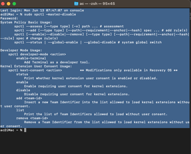

I have tried to install it by disabling the root , authenticated root. the problem is the The Kepler patch rename the Ventura installation Disk as Montrerey Disk. Is there any process to manually install the Graphics Patch.. please tell me steps
That's not the issue, it's just a name and you can change it after if you want.
I cannot help further, you are further ahead than me, I don't have Ventura installed :D

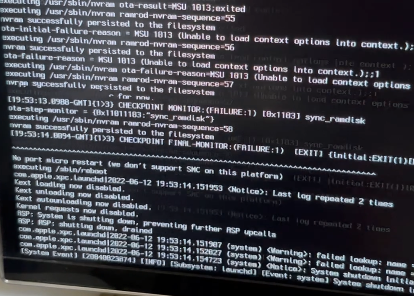

5 hours ago, Cyberdevs said:
To all people that encountered the "A required firmware update could not be installed" issue:
After cross examining several config.plist files I realized the key factor that was missing from my configs is the set of string "run-efi-updater=No" which only was present at: 7C436110-AB2A-4BBB-A880-FE41995C9F82 entry under the NVRAM section.
After taking a closer look at @pico joe's config I realized in his config the "run-efi-updater=No" was also available in the NVRAM under "4D1EDE05-38C7-4A6A-9CC6-4BCCA8B38C14" and "4D1FDA02-38C7-4A6A-9CC6-4BCCA8B30102" so I added these values to my original config which I was using for Monterey and earlier versions of macOS, updated the kexts and OC to latest version (0.8.2) and the installer went smoothly without any issues.
I just finished the installation of Ventura with these settings being added to the config.plist and I will try once more without these stings just to prove my conclusion and share the results.
Thanks to all the OC devs and all the people that helped to resolve this issue.
i treid this but stil got A required firmware update could not be installed
am i missing something else 😅?

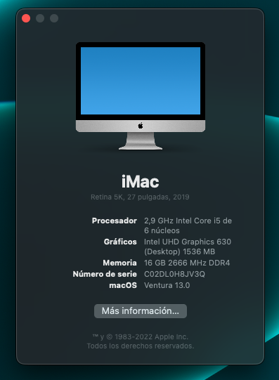

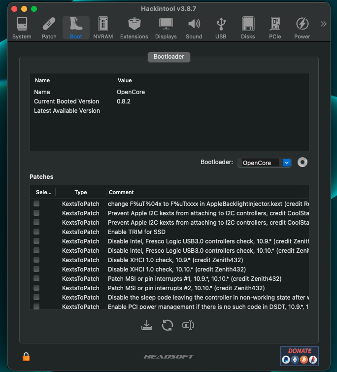

Hello, I have managed to install ventura on my haswell working quite well, only hdmi audio and my graphic does not appear in about this mac... greetings
Make sure you follow @Cyberdevs posted Guide exactly as illustrated and before you boot off the USB drive (I am assuming this is a clean install) clean the NvRAM at least twice.
Just make sure that you have updated all the necessary parts of your EFI folder.
I found out why I kept getting A required firmware update could not be installed.
I was using EFI from USB which has OC 0.8.2, and the EFI from ssd had 0.7.9.
so I updated also my ssd EFI to the same on as USB, and I got it working.
it installed just fine after that and I am using Ventura now.
Thanks guys
