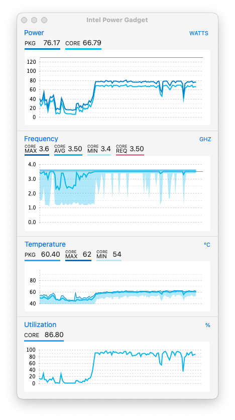

Only thing that is still pending is the Power Management. I tried MacPro 6,1 and also MacPro 7,1 but Powermanagement is not working. Cpu Frequency stuck at 3.6 but mine is at 4 Ghz in Bios.

I actually include the CPUFriend data inside the SSDT-PM
1 minute ago, miliuco said:
@RoberT_XeS
When I have MacPro as SMBIOS, I usually add CPUFriendDataProvider.kext (generated from CPUFriendFriend.command by corpnewt) next to CPUFriend.kext to have better CPUPM.
https://github.com/corpnewt/CPUFriendFriend

Don't mix up CPUFriend Generated data with ssdtPRgen generated SSDT , its not good at all, if you want to use "cf-frequency-data" then use it only with SSDT-PLUG , its better to use ssdtPRgen ssdt only.

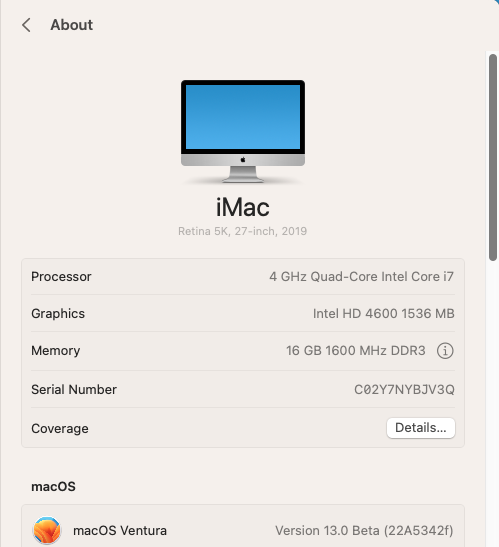

No, thank you very much for help.
I have followed hvds's detailed instruction (#691 https://forums.macrumors.com/threads/macos-13-ventura-on-unsupported-macs-thread.2346881/page-28) to boot my Ventura beta 6 successfully already.
Previous error was due to mis-understanding of the file size which should be 4.22 GB exactly instead of 1.xx or 3.xx GB.

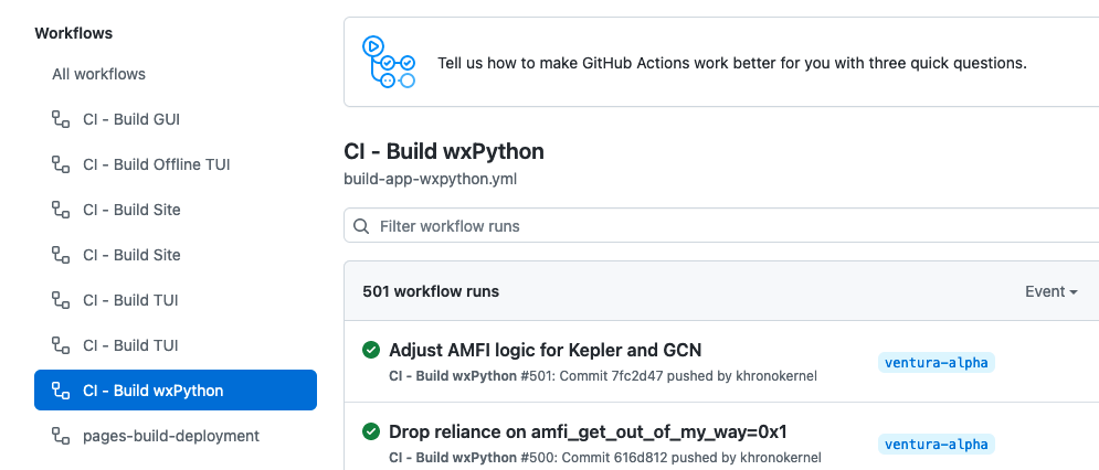

@AlexVTk  You should first confirm that you need the boot-arg amfi_get_out_of_my_way=1 and that the boot-arg has your desired result.  After you've confirmed that the boot-arg produces your desired result, you should read about the kext here.  The kext is intended to replace the boot-arg (you shouldn't need the kext if you're properly using the boot-arg).  I have only used the boot-arg (I didn't care about the security vulnerabilities) and never needed the kext, so I can't help you other than to refer you to the readme.
