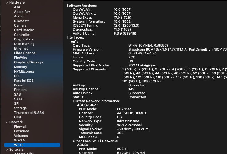

eSaF Posted August 27, 2022 Share Posted August 27, 2022 Well it was one he££ of a journey on this Z590. Two full days of hand wringing and swearing plus looking back fondly at my old trusty Z390 but I got there in the end by looking at and stealing files from here and there. It is still a work in progress but Sleep/wake works although Ive lost B/Tooth and WIFI is a bit flaky. The Fenvi T-919 doesn't fit as part of it over hangs out of the slot. LAN on this board is the Aquantia 10Gbe Chip and I don't know if there is a fix or work around to utilise it, as B/T is not working I can't use my wireless Mouse and Keyboard so at the moment I am having to use an Old wired combo of the two I had lying around. Ive included my EFI Folder for scrutiny, hoping for some helpful input from the knowledgeable ones here,EFI.zip Spoiler EFI.zip 9 Link to comment Share on other sites More sharing options...
Cyberdevs Posted August 28, 2022 Share Posted August 28, 2022 @eSaF Congrats on the rig About the Aquantia Ethernet you are missing two things: 1. ForceAquantiaEthernet should be enabled under Kernel->Quirks 2. You might need to use a custom SSDT to change the device ID on my GA-Z690 board the device ID isn't supported by macOS so I'm using SSDT-Aquantia-AQC113C.aml to change that to a supported one. What is the exact model of your mainboard? you might need to put the Fenvi in another x4 slot instead of an x2. I removed the extra themes from the EFI folder to reduce the size. EFI.zip 5 1 Link to comment Share on other sites More sharing options...
eSaF Posted August 28, 2022 Share Posted August 28, 2022 @Cyberdevs Good day, a thousand thanks for the tip, will try your suggestion. The Board is the Gigabyte Z590 AORUS Master, the 4 Expansion Slots are quite large (same size as the Graphics Card one). Really appreciate the help, I will update my profile to remove any confusion when posting. 6 Link to comment Share on other sites More sharing options...

eSaF Posted August 28, 2022 Share Posted August 28, 2022 @Cyberdevs the Aquantia Ethernet tip was golden, thanks again I just need to sort B-Tooth now. Found IntelBluetoothFirmware-2 kexts so gonna experiment a little. IntelBluetoothFirmware-2.zip 6 Link to comment Share on other sites More sharing options...

Cyberdevs Posted August 28, 2022 Share Posted August 28, 2022 @eSaF you're welcome man. I guess you need to map the USB ports first (if you haven't done it already) and then use the intel BT kext. Just to clarify one more thing the bottom PCIe port on your mainboard is the x4 port and you can use it for fenvi adapter, the first PCIe is x16 and the second is x8. If you need any more help to avoid going off-topic here, you can send me a PM so we can continue this over PM. 5 1 Link to comment Share on other sites More sharing options...
