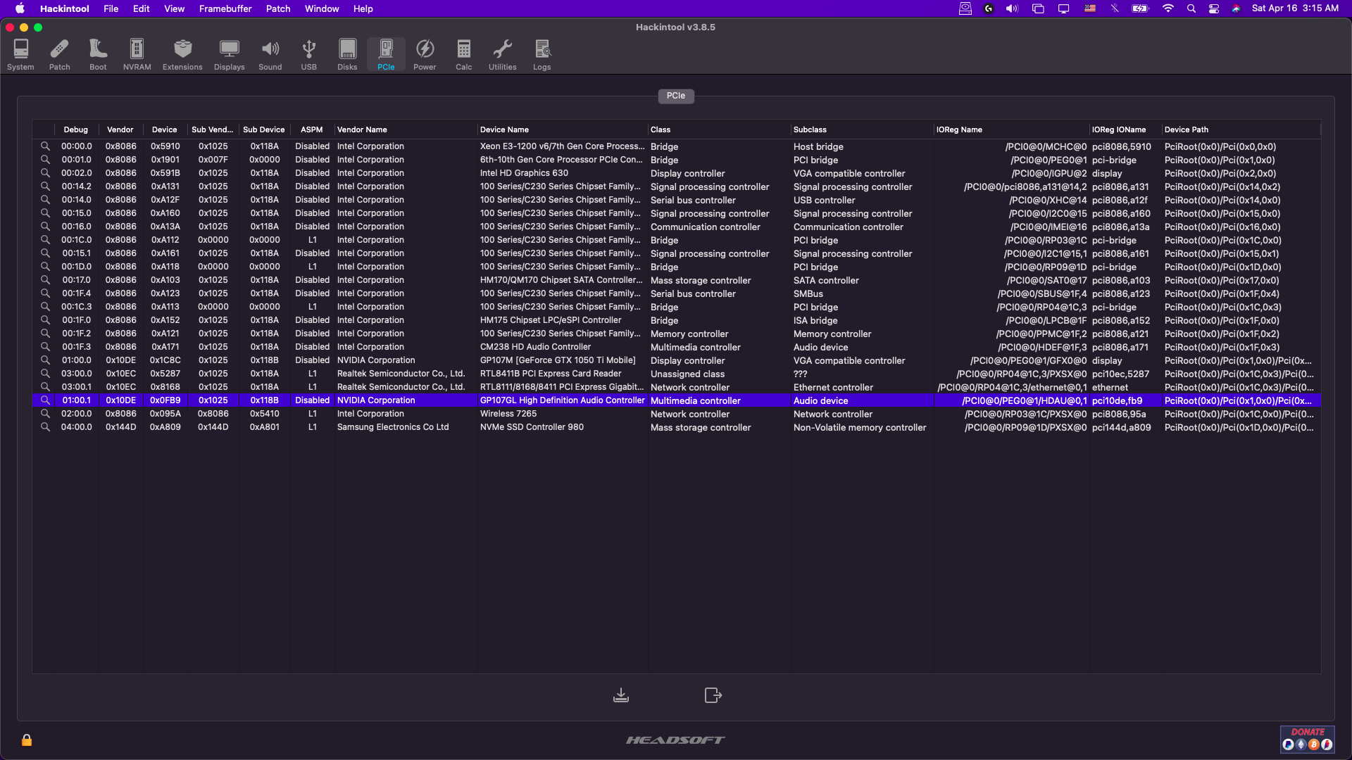

gfxutil -f GFX0
OUTPUT SUCH AS THIS:> 01:00.0 10de:1c8c /PCI0@0/PEG0@1/GFX0@0 = PciRoot(0x0)/Pci(0x1,0x0)/Pci(0x0,0x0)
open config.plist to to DevicProperties create new then edit it with this above last portion only.  PciRoot(0x0)/Pci(0x1,0x0)/Pci(0x0,0x0)
the Internals underneath according to where it is located you can use  Clover Configurator or OpenCore Configurator just for this purpose to get PciRoot information
where to look in Clover Configurator :  Devices > Add Properties| Properties < click to get Properties and in the right side bottom there is a menu to get all the PciRoots.
Select ALL and  it populates. Find your Geforce Video and Audio. There are two separate. One is High Definition Audio and the other your Geforce model.
Save to config-pci.plist
open and copy them to your working config.plist via a non-GUI editor.  To avoid characters that normally doesn't happen with a text editor.

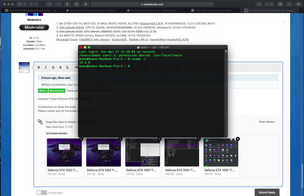

@Slice @Cyberdevs Thank you so much for the reminders,

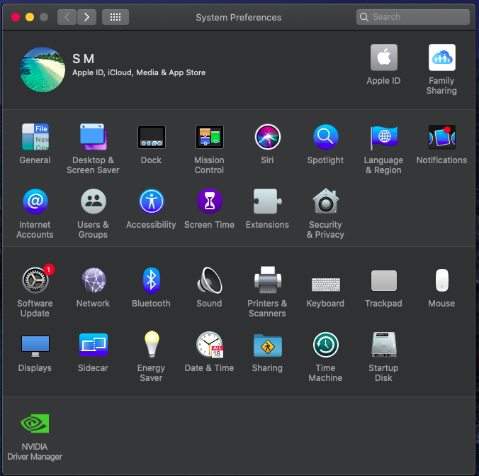

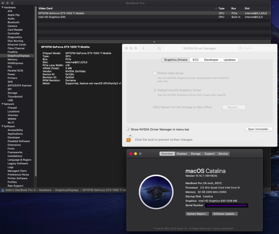

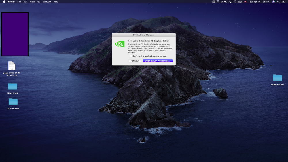

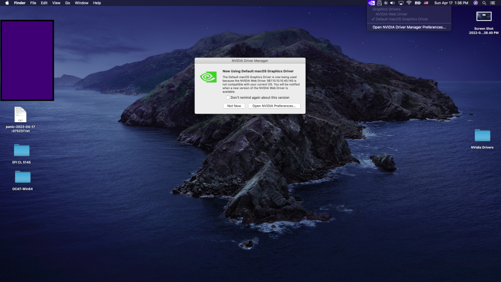

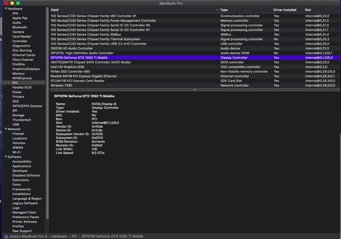

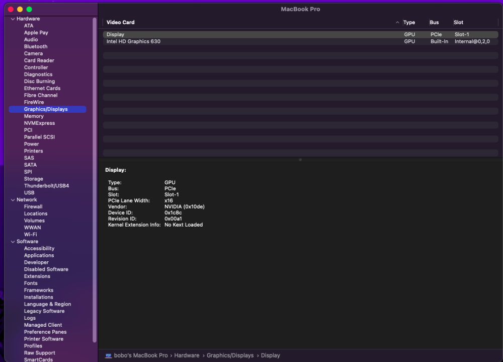

However I have Geforce GTX 1050Ti working
Screenshots to show the work:
Please review and let me know what you think..
Must be the break through technology we have through all you fellow outstanding Developers from the years!!
My hats off to all of you! You all deserve a week or more in Maldives! I wish I was rich!
Now have to get HDMI Audio driver to work. It's not loading. that was the whole purpose to get HDMI Out to TV
25 minutes ago, Slice said:
But on your screens there is Intel HD630 graphics while your Nvidia just presents.
@Slice
You're right the gpu isn't switched yet.  have to do some more work to load
It is up in HIgh Sierra
@makk
As you can see in your screenshot the amount of VRAM is set to 0 in which means the the GPU isn't working and as I mentioned before the only versions of macOS that can utilize the Pascal GPU series (10xx Series) is macOS Sierra (the 10.12.4 and above if i'm not mistaking) or High Sierra but macOS Mojave and above can't load the nvidia web drivers so it's pointless.
And the macOS Monterey 12.0.1 release dropped support for all the nvidia GPUs which where natively supported in previous versions of macOS.
758902770_GeforceGTX1050TiMeetsAcerNitro5Calalina3.png.4e07a17d57ae3bbe90357f801f7377ba.png
